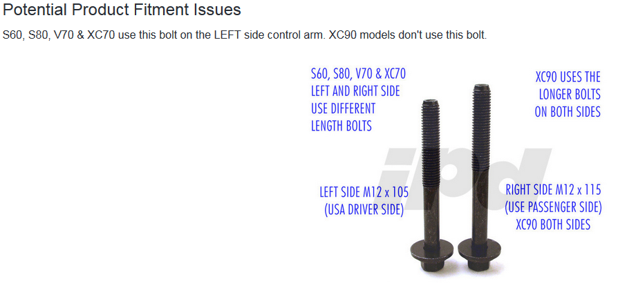

Thanks Antoine for your help and patience. Are you sure the two different horizontal bolts aren't for individual sides? (not one for front of each, one for back of each?) Here are some images from IPD, which i take to mean that both 987455 are for only the LEFT control arm, and both 987456 are only for the RIGHT control arm
Here's for 987455: and for 987456:

You are totaly right!
Yes 987455 for the driver side and 987456 passenger side
I have done mine last june, could not remember it well, sorry!

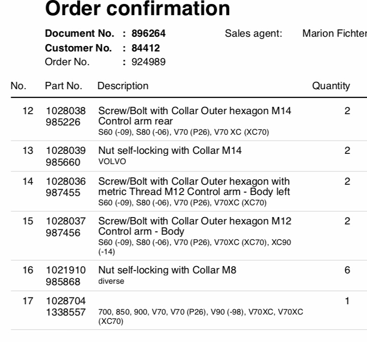

To not confuse anyone:
2x Self locking M14 nut 985660 for both LCA rear bolts
2 x M12 987455 for driver side
2 x M12 987456 for passenger side
From my order in june
- 458A0F6C-94B3-4D7E-8C31-990293A0F688.jpeg (143.41 KiB) Viewed 2161 times

Thanks Antoine and abscate. Here's what I'm getting:
2004 S60 2.5T AWD
