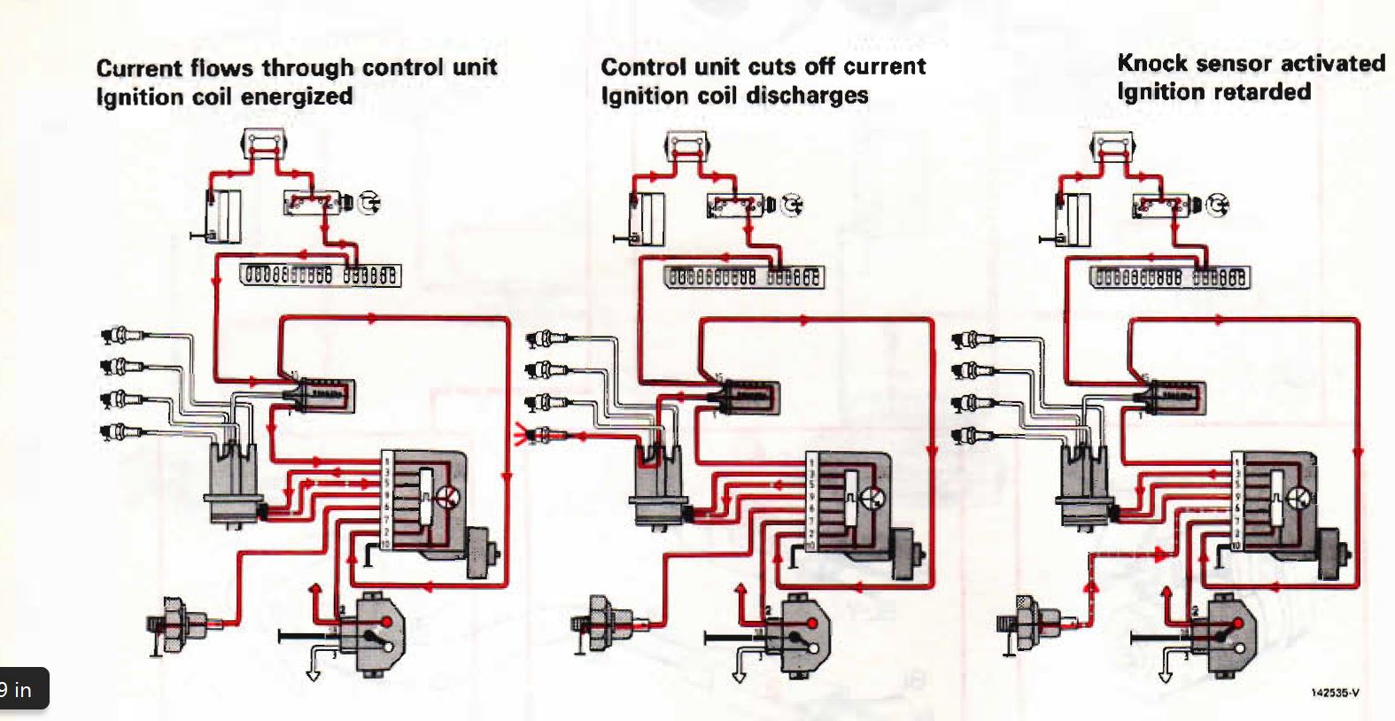

calm down "can" was a typo i love my volvo just as much as the next guy. finally got to do some investigating and found its a no spark issue. getting juice to the coil. and plugs and wires are new and tested good as well as the cap and rotor. also have replaced the hall effect sensor. there are three wires running off the sensor. does anyone have a wiring diagram that shows where the wires run to so i can trace the wire back.

Bdsexton06 wrote: 26 Mar 2019, 06:18hall effect sensor.
Bdsexton06 wrote: 19 Mar 2019, 11:56wiring diagram that shows where the wires run to so i can trace the wire back.

im thinking that it is my connector for my control module. its pretty well roached even for it having a newer (about 10 years old) wiring harness. ive been looking for a replacement online with no luck. anyone know where i can find a replacement or even a way to rig one. thanks for all the help so far.
