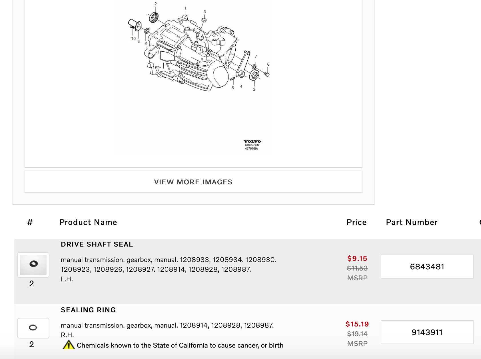

Thanks Abscate,
I now realize my mistake. I can't read..
That diagram is what confused me
It clearly shows there is a RH and LH variant.
However, I thought the 120XXXX numbers were the part numbers and the three part numbers for the RH variant are actually also listed as the last three part numbers for the LH variant as well.
And I totally missed the "Part Number" column and that clearly shows two different part numbers.
But according to some parts sites, that 9143911 doesn't fit my car.
When you did your job highlighted in the post, did you replace the seals and were they really different sizes?
the 9143911 is supposedly 75mm OD and that's a lot bigger than the other side.
-A

Oh I should have mentioned that since one side is supposedly 34mm bigger than the other, that will be easy for me to see/measure . I'll do that this weekend and let people know.
