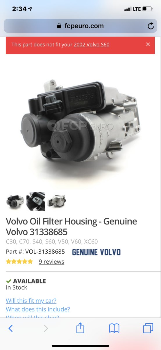

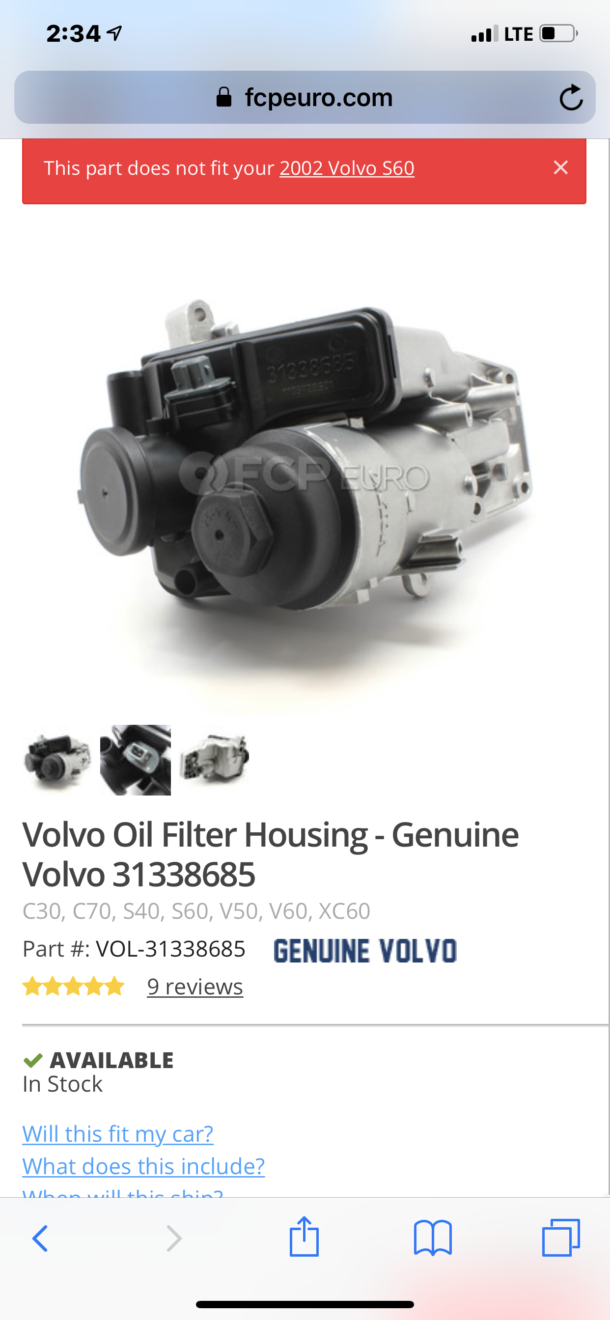

Heres a pic of what looks like metal around some rubber things that its Says “This is for the oil filter housing ...
I was told i have a oil leak under my csr and the said my oil filter housing and cap is cracked bad ...
So di i need this or the other thing on here cslled ool filter cap/housing which ... look like the cap and the filter ibside the cap.??
Plus its says here its called a breather...

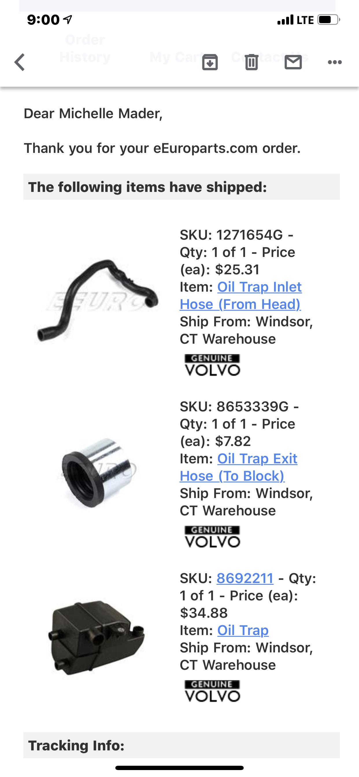

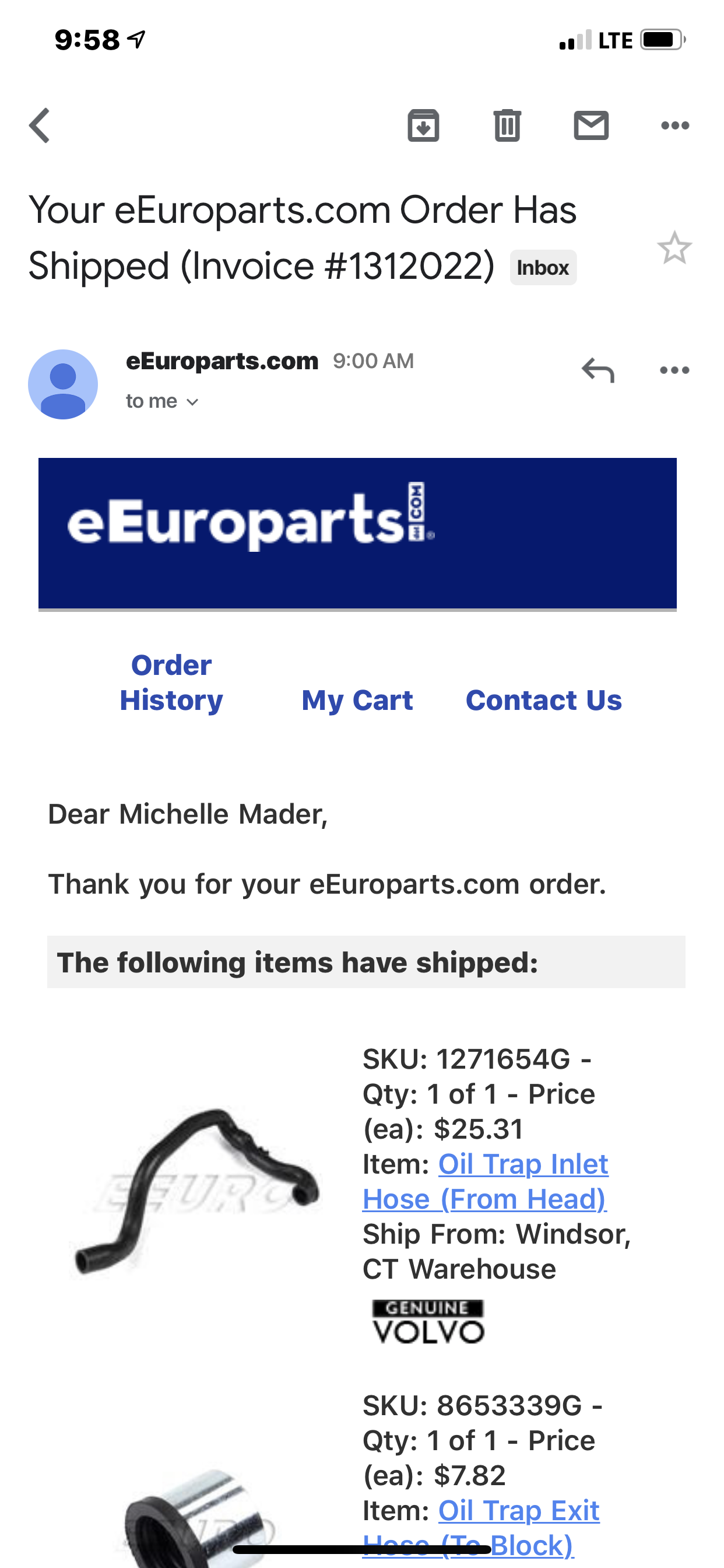

Im so Confused I’m trying to fix my oil leak underneath my car and I was told that I have I also I’m trying to fix my PCV system which I ordered the parts and I’m going to show you the pictures that I ordered and hopefully these are the right ones for my 02S 60 all wheel drive turbo 2.4 Volvo
Im confused ... This for my cracked oil filer cap housing or?

That part above is not part of the oil filler assembly on your car. I bet you just need one of these: It goes under the oil filler cap and is removed with a pick tool

The picture of the oil filter housing part that you found (the first of your pictures is for a 2012 and later Volvo S60 - it doies not fit your 2002 S60 - check the fitment section for the part on the FCPEuro site). You may want to call FCPEuro and get their help on the parts.
A picture showing the issue with the oil filter housing would be useful.
