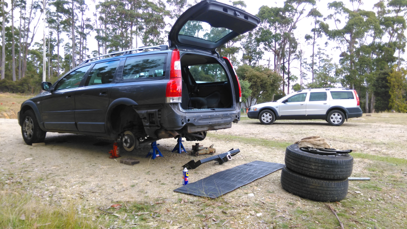

Last Sunday, I removed the existing tow bar and wiring, taking care to note how they wired the trailer lights into the existing wiring.
I thought these need the trailer electronic module, part 4/110. It doesn't seem that it is needed then ?
Tow Hitch Removal
Tow Hitch Removal
I removed the extra jump seats in the very back, I have no need for them. The seller kindly supplied all the fittings for the vehicle to be put back to standard five person seating.

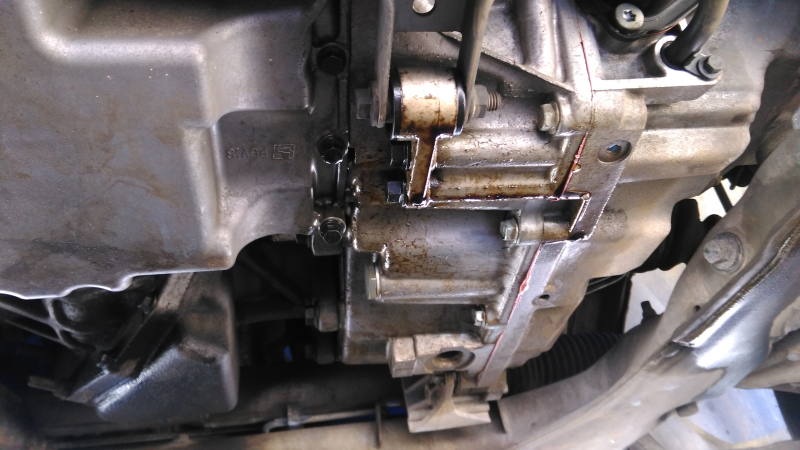

I removed the splash guard and saw the awful mess of oil splashed everywhere. Dark wet dripping oil, not a nice sight.
From the photos he sent me from under the car with the splash guard removed, I concluded that the problem appeared to be a blown seal on the output shaft that feeds into the angle gear. I thought, okay, I can do this.
After giving the whole area a good wash from above and below so I could get a closer look at it today after drying overnight, I found to my utter dismay that, no, it was not the output shaft seal, but, instead, the oil appears to be leaking from the small drain hole between engine and transmission. It would appear to me to be the transmission input shaft seal. Oh sh!te I thought.
it's not engine oil, as the engine runs fine and engine oil level is fine. I knew the problem was with the transmission and the black icky stuff that looks like old engine oil, is in fact transmission fluid. The transmission dip stick confirms - no ATF.

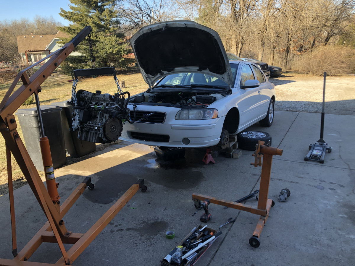

I recently swapped the engine on my S60, and I had spent quite a bit of time researching the ways to get the engine out of the bay. I ruled out the bottom removal because I wouldn't be able to lift up the car body high enough. When I pulled the engine on Subaru a few years ago, I rented the engine lift (a.k.a. cherrypicker) from the nearby hardware store. It cost about $50/day, but because I screwed things up, I had to rent it three times. This time I found someone selling an engine lift in my area and bought the darn thing. Cost about as much as three days of rental, but there is no hurry with having to return it. My wife is not thrilled with having such a bulky piece of equipment sitting around the garage, so eventually I'll put it up for sale.
When pulling the engine out I chose to disconnect it from the transmission. In retrospect, I should have listened to those who advised pulling both together. I chose to pull out the transmission out of the bay, bolted it on to the new engine, and installed them back together. Load leveler was an important and indispensable piece of equipment for both, removal, and installation.

Definitely go with pulling the engine from the top separately instead of dropping the entire assembly. It's a little tricky accessing the torque converter T40s but you can do so from the starter hole or from the slot underneath.
Lifting both from the top is also doable but on an AWD just more stuff to disconnect.
Disconnecting angle gear and central drive shaft can be a real PITA. Raising vehicle high enough to clear the assembly is also a huge challenge when dropping the whole assembly.
Make sure you get yourself a fuel line disconnect tool
