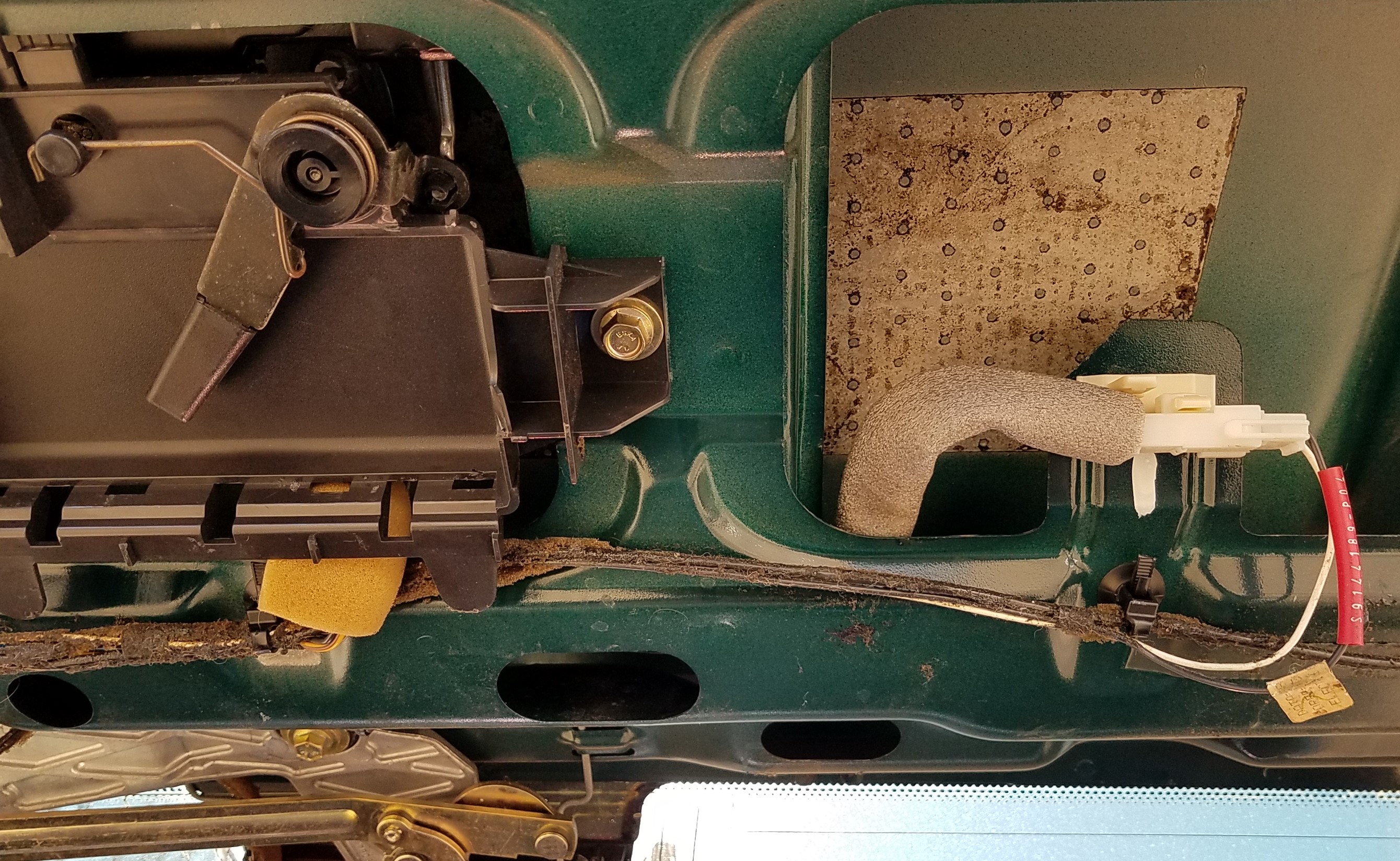

One thing that might be helpful to check is the tailgate door sensor circuit to make sure that it's working normally. I think I read that if the switch or wires are not working, then the car won't enter program mode. Some people have reported cracked insulation on the wires in the tailgate hinges. Good luck!

I know the rear tailgate locks and unlocks but I don't know if the sensor necessarily works. I have had some issues with the tailgate closing properly in the past, and I just noticed that I can't manually lock and unlock it with the key anymore because the key cylinder completely fell out, just a round hole where the cylinder used to be. Can you unplug or jumper the sensor plug to fool it into thinking the alarm sensor is working properly? At least long enough to program the remote. I don't really care if the alarm stays operational anymore, just long enough to program the remote. Thanks

The interior lighting circuit diagram shows the wagon tailgate light wires are red and blue/brown and the wagon tailgate switch wires are blue/brown and black.
The anti-theft circuit diagram shows the tailgate lock wires are also blue/brown and black.
