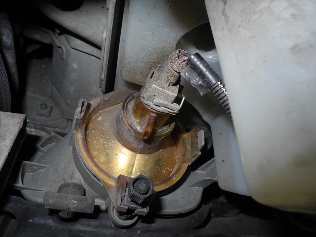

Can you adjust the beam height on the fog lights? Thank you

Yes.
2008 XC90_FogLight.JPG (89.62 KiB) Viewed 1218 times

would you know the best way to adjust them? Thank you

Top of beam 4 inches high with car 25 feet back? I measure around 17 inches from the ground to mid lens for my '08 so could change slightly, although much of what's published notes a light height range between 10 and 24 applicable to the 4 inch limit.
I looked in VIDA and did not find in any obvious spot, and could be in a manual somewhere but nothing in the couple I checked. If I find a reference specific to the XC90 at some point, I'll do an edit.
If others are aware of different numbers please post.
