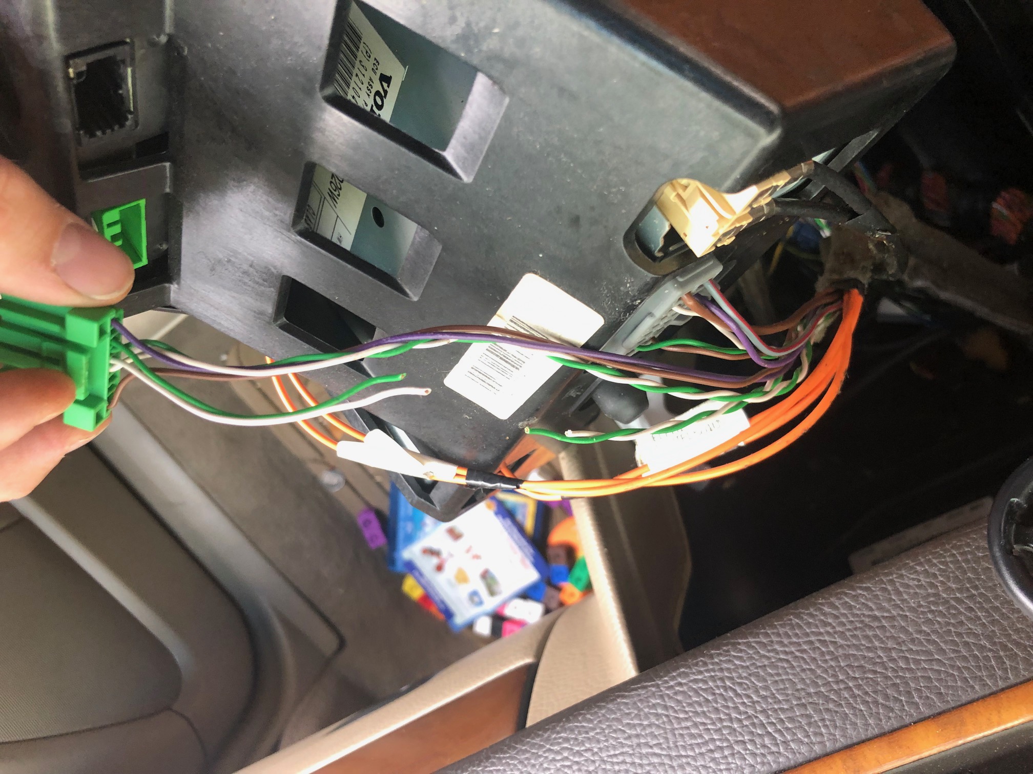

I found something
I pulled the infotainment and climate control out and found two wires cut.
The two wires are obviously shorter than the rest in the harness and there was a piece of electrical tape, i have no idea how these would be so much shorter? I watched all the videos of this procedure on YouTube I could find, and no one else has a short pair of wires. But the tape seems normal.
I suspect I should splice these wires back and then put it all back together, but this is a serious mystery.

I temp spliced that stuff back together and tested it and the climate, keyless entry and radio came back up.
SRS Light still active but I'm going to do a proper splice, get it all put back together and erase codes with Vida then see where I am.
Thank you guys for the help so far. I'm at a loss as to how this could have happened, we haven't owned the car THAT long and we have never been in the dash before. There were two broken clips where the climate control screws at the bottom but every clip I've touched in this car has been easily broken so I may have done it.
Hopefully the next poor guy who googles SRS, Keyless, Radio, Air Conditioning and Windows broken finds this thing useful. 2008 XC90 V8

The green and white wires are the CAN communication wires. I can't think of any reason why you want to cut those. You can solder in some wire sections to extend those. I would use heat shrink to cover the solder splices. Those wires have a twist on purpose. In this area there are not a lot of wires so if you add wire and the spliced ones are not close to the others then the chance for any signal bleed is not going to be an issue.

As best I can tell this has never been pulled before. It’s strange. If it were a house I would say a mouse ate them. An inch was missing from them.
I expected it was a twisted pair serial comm or similar so I used a like type maintaining their twists with Sopoby heat shrink crimp connectors and a label back there for what I found and what I did.
Luckily, if it happens again, I hopefully know where to look.

One end of the wires look like they been cut (straight and clean) but the other end looks like it may of been chewed ( Rough and uneven).
The two wires are a twisted pair. The twisting reduces Crosstalk (electromagnetic induction) between pairs, which improves signal quality.
