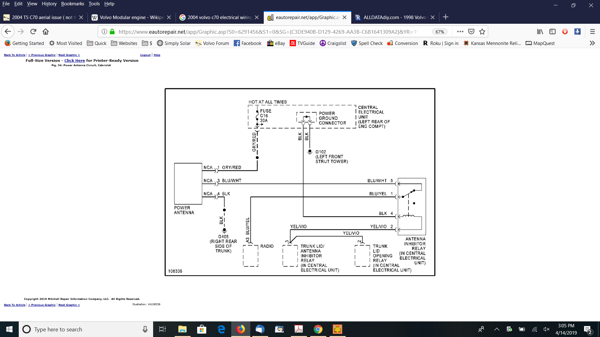

The schematic above is from Mitchell. I think Mitchell got it wrong.

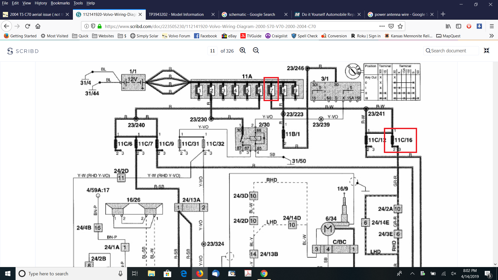

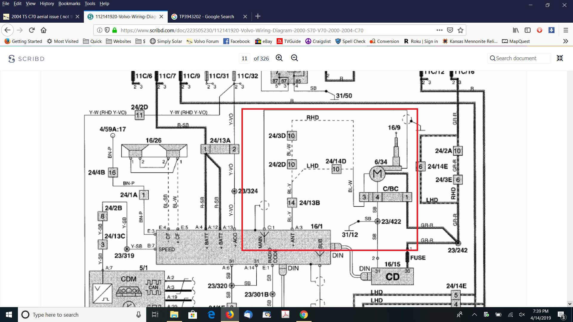

This from Volvo TP3943292 which, according to Volvo Tech Info, Cover 2000 S70, 2000 V70 and 2000 - 2004 C70.
Looks like Scot850's suggestion is the first port of call.
You might try pulling the SC901 out, disconnect the harness, for voltage on Power Antenna motor wire.
