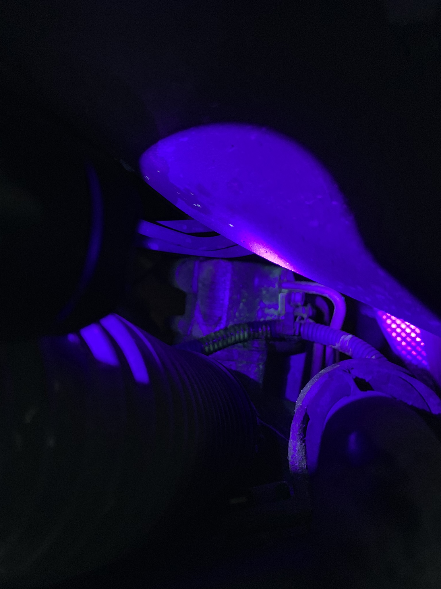

The power steering rack of our 2006 V70 is slowly leaking, splash guard wet. I added some UV Dye to power steering fluid and was able to find the source. Looks like it is leaking from the back of the rack where the steel lines are inserted into the rack. Gold color in the attached picture. Not the lines from and to the steering pump.
Went to the dealer and they where able to find the exploded view of a rack listing these o-rings. But the rack in the picture showed screw in type fittings and not the style I have. This was the only thing available to order.
PN 969092& 969093. Are these the right size for all racks? Would like to before pulling it apart.

It is not possible to replace these lines without having to remove the sub frame.
There is not enough room to remove the lines. I removed the brace at the bottom and the exhaust rubber mounts for visibility. And replaced only the o-rings on power steering side. Lines where still in good condition.
