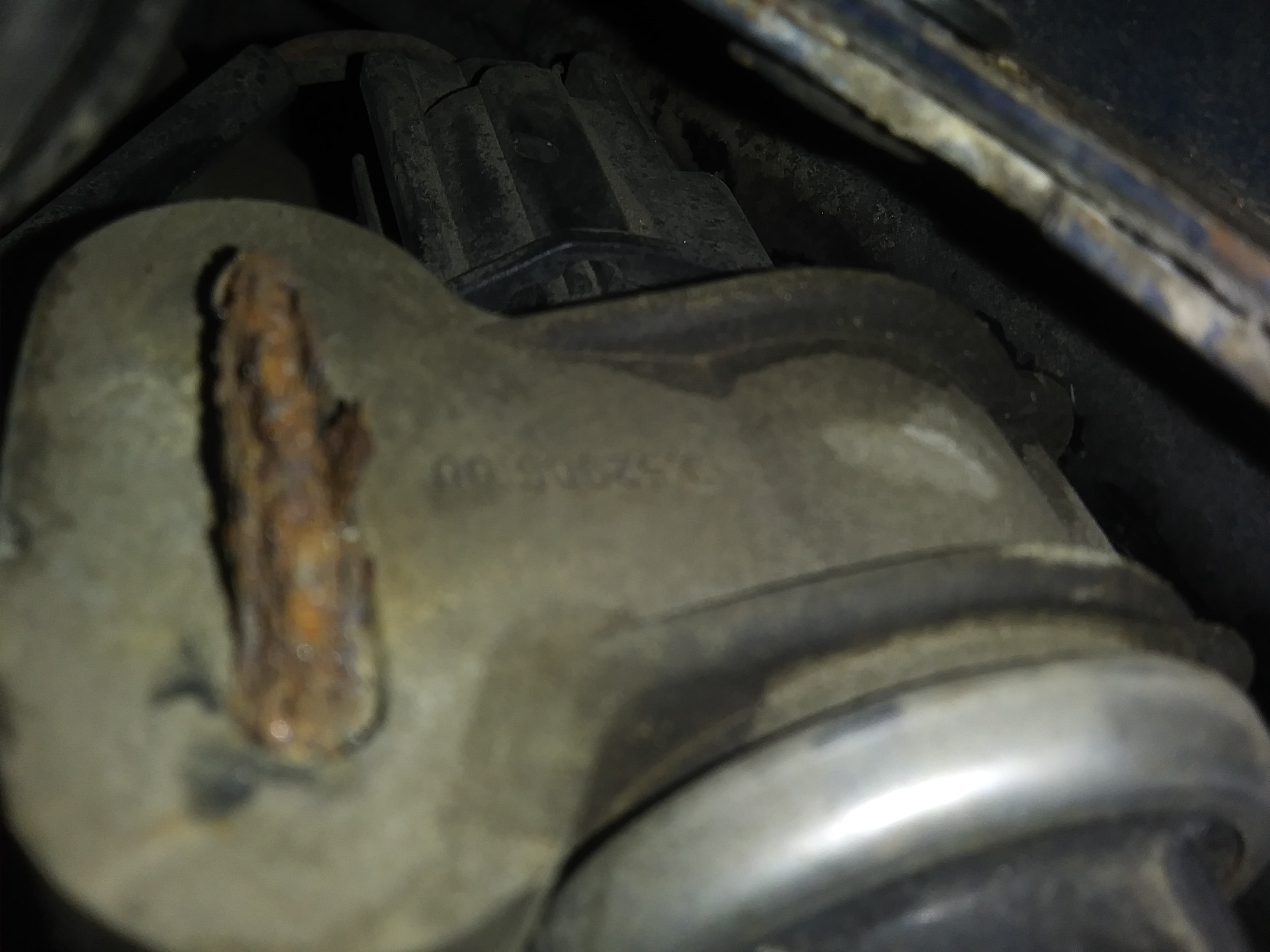

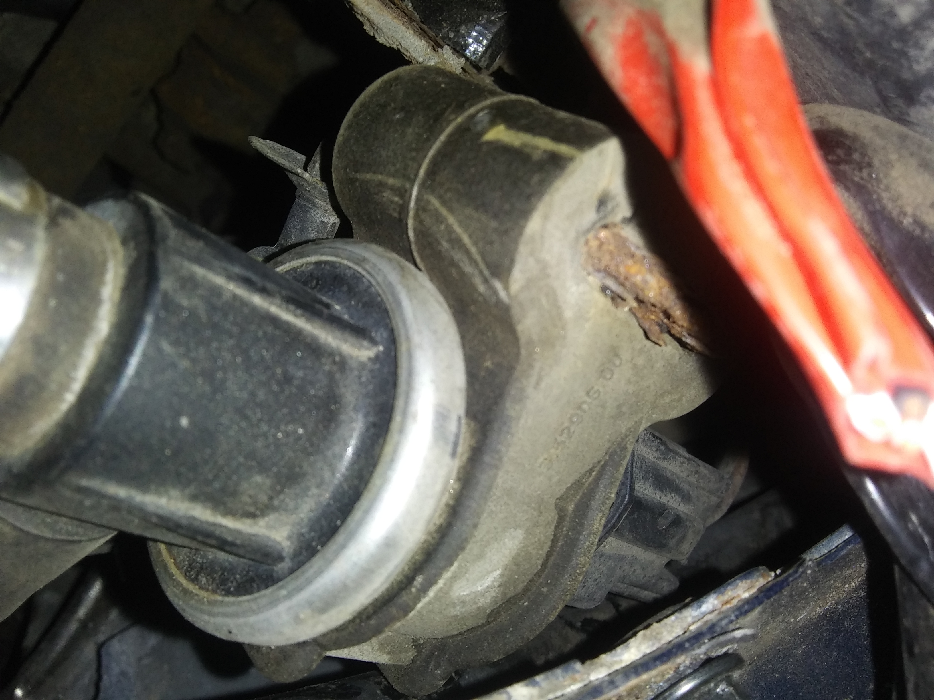

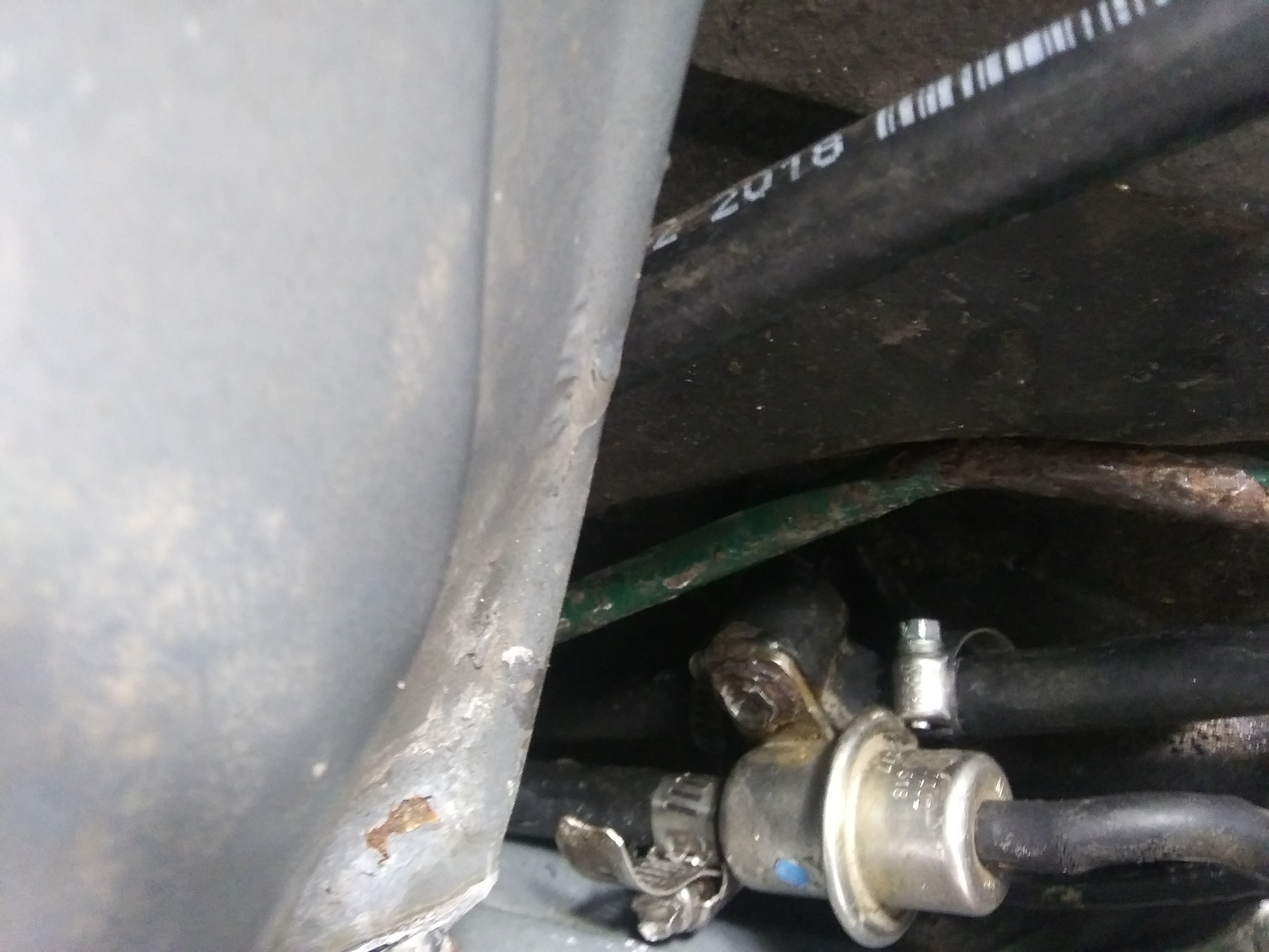

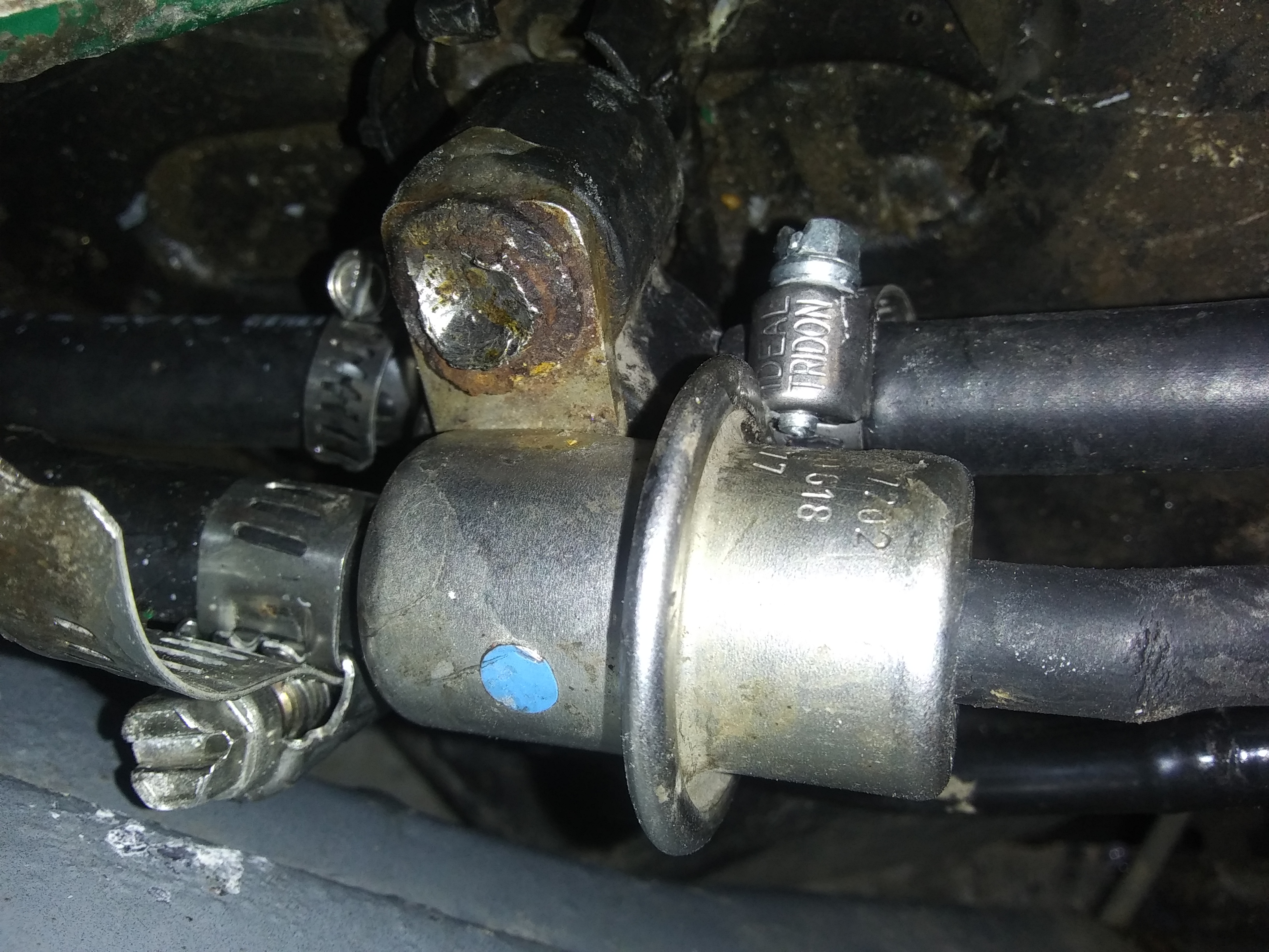

There is one vacume hose comeing from it and 3 fuel lines.....its on top of fuel tank....iys leaking from where the FPR mounts with 2 bolts onto plastic piece that 2 of the fuel lines conect to.....how do I post a pic on here

Its not that vacume line thats leaking I have scence switched it.....it is cimming from plastic mounting bracket

I was also told that this car didnt have idle control valve but isnt that what this is?

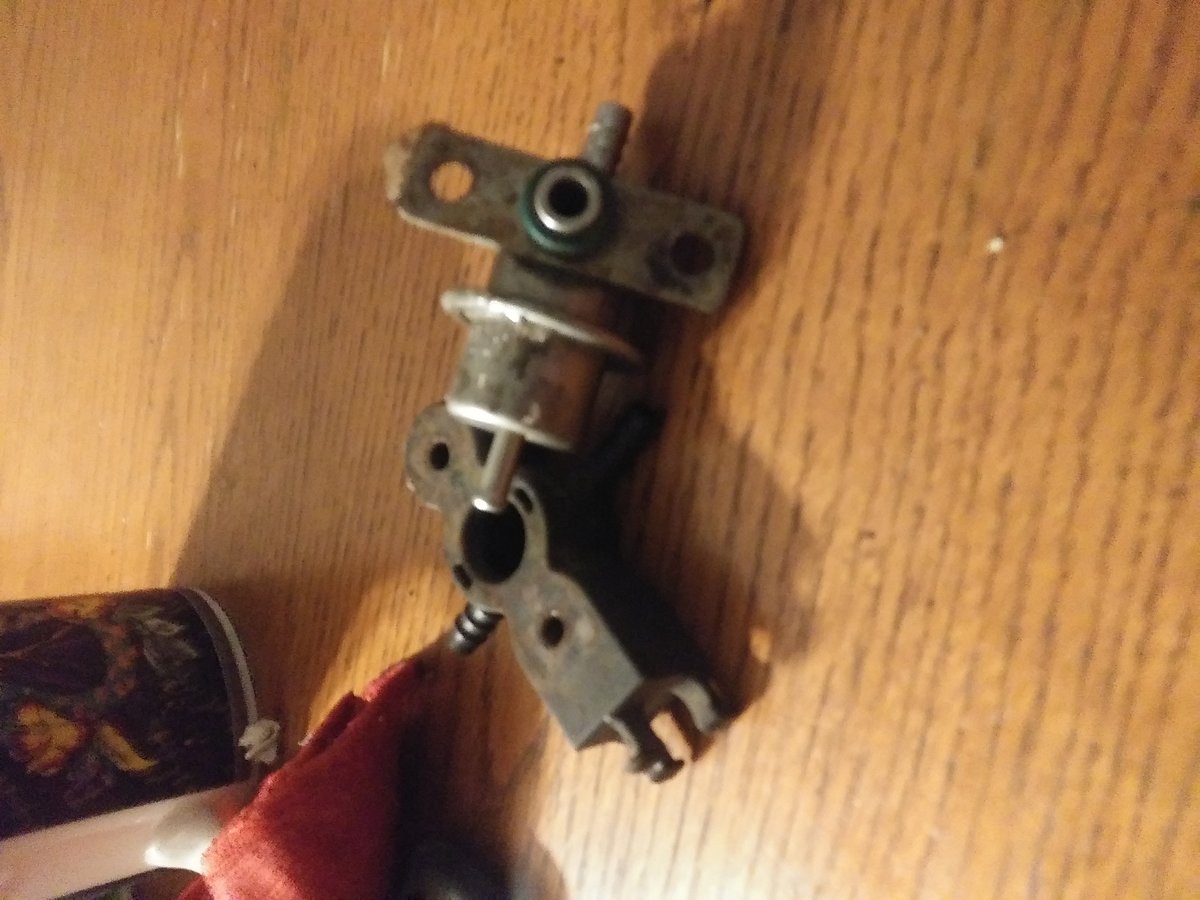

pic of it out of car

The fuel pressure regulator has a diaphragm and on earlier models manifold vaccum(or pressure) was used to keep the pressure constant inlet to tip of injector. On the last ones to use FPR mounted in the junction in rear near tank the diaphragm is there but if it were to leak it needs to go somewhere other than under the car so the hose goes to tank. The diaphragm can't be sealed or it would not regulate properly. The FPR hisses as the pumped fuel builds pressure and pushes on the diaphragm and once the pressure gets to the target value as determined by the spring bearing on the "dry" side of diaphragm it pushes the diaphragm center metal seal disc off the relief port tube and the fuel hisses passing out to relief port.

It should be leaking air out or sucking air in where if I put my finger over it....it will change the sound of air flow?....the regulator is makeing it's reg. Circulating noise....then there is a air leak that changes if I cover a cpl of different spots...also is that a idle air control in the back by the charcoal canister?
