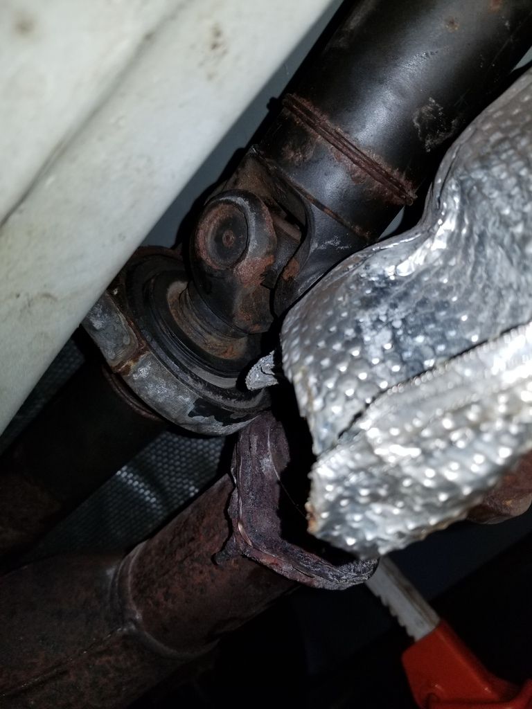

After dropping the 12 year old exhaust system to remove the driveshaft I was able to see it's time for replacement. After searching for nearly a week I've narrowed it down to this:

The flex section on the downpipe is strong. To get the driveshaft off I let the exhaust hang nearly a foot from the rear putting stress on the downpipe. The flange were the CAT and resonator mate is rusted away. If our CATs normally last over 200k I might cut off that flange and slide on strait exhaust pipe.

I have restored exhaust flanges with high grit grinding plates and wire brushing but this is near the end of it's life. I might try cleaning it with a stiff wire brush and see if it clears up the bolts enough for extraction.
The resonator pipe hanger and muffler hanger seemed to appear in fair shape.
Another negative factor is the top side of the muffler is badly corroded. The bottom side must be plated with SS. With the exhaust hanging I could wire brush the top side of the muffler then spray with ceramic exhaust primer.
I know the exhaust on ebay isn't high quality. I sent a message to Schutlz to get more information on the SS CAT.

That looks indeed fairly worn. I had to replace my flex downpipe two times and repair the flange after the cat. From this experience, if I was to do it again, I would go with a used genuine exhaust off Ebay, perhaps a unit from a southern state such as Florida. The aftermarket replacement exhausts vary widely in quality (same for the cat converter), even the replacement sold by the main dealer seems to last very little. The original parts were very long lasting in climates without winters/salt
Worth mentioning the flex downpipe is welded to the converter and not easy to replace separately because it must be welded back in place perfectly at the same position, or the flex pipe will stay under stress and start leaking soon. This is why I would be a little worried with aftermarket parts - I now run an aftermarket flex+car and the bracket was badly placed.
