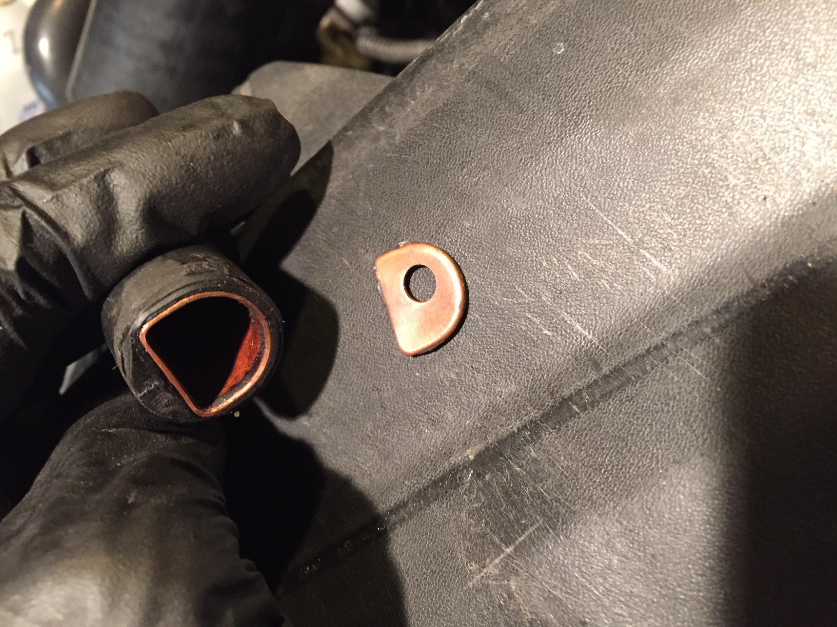

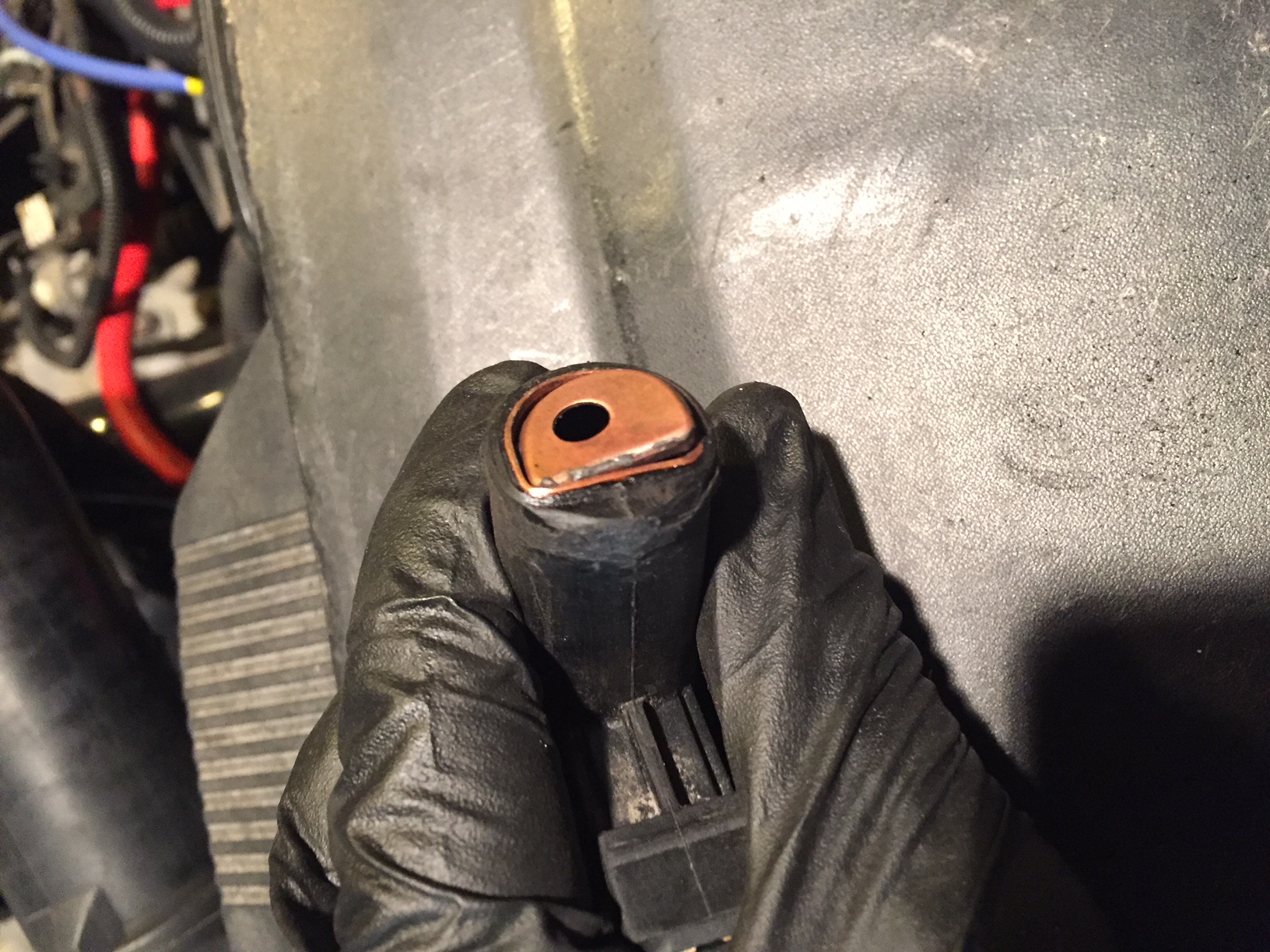

I first posted these in ZionXIX's thread viewtopic.php?f=1&t=84698. It's been 18 months now, with no ill effects on my 95 R.
The PTC is not available separately as a replacement part, good news is you will almost never need a new one, there's nothing to break or wear out. Great junkyard part in that sense.
The grommet for the base of the PTC is available separately from Volvo as part number 3507985, about 4 bucks. Very worthwhile to replace that!
