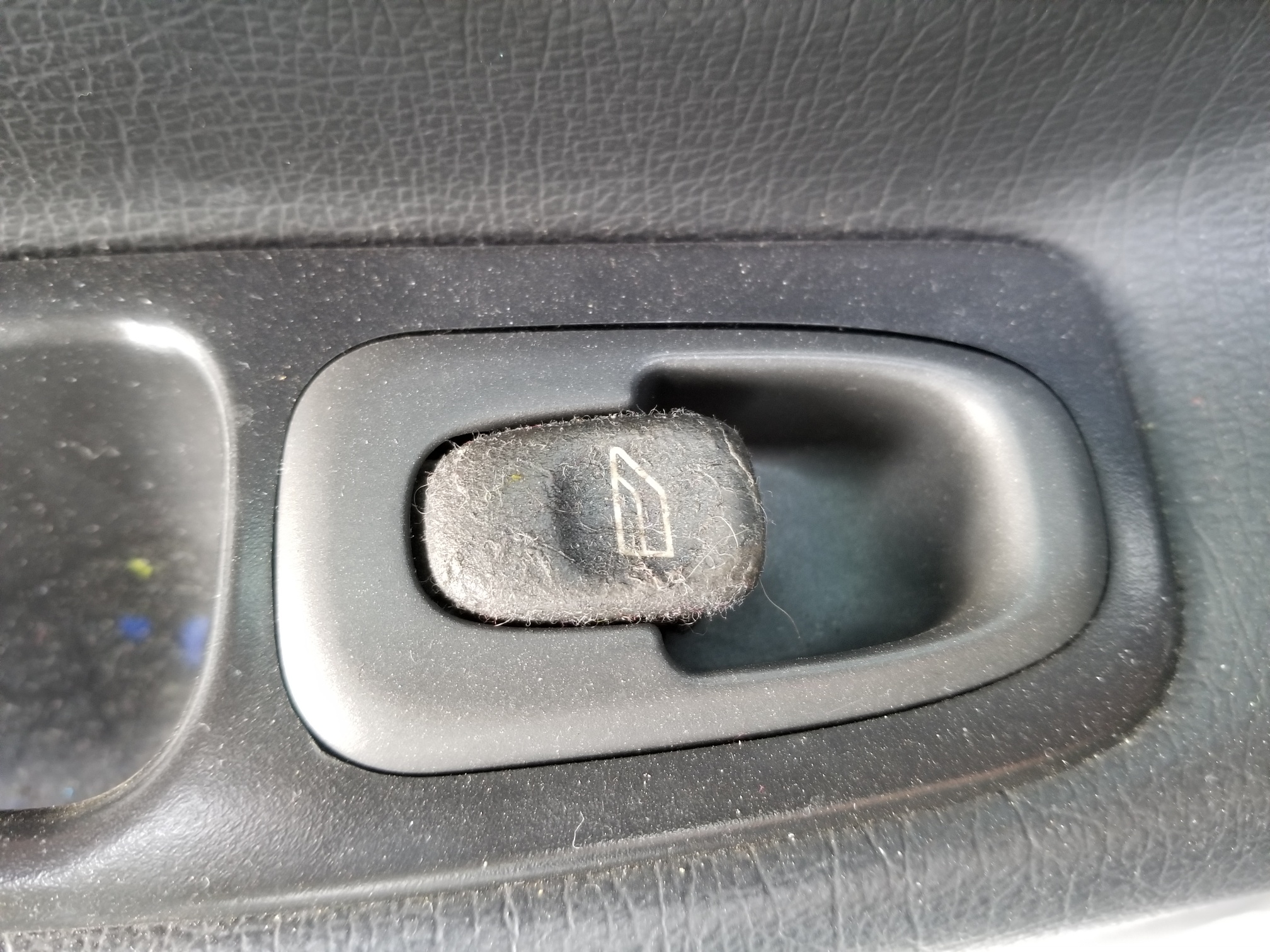

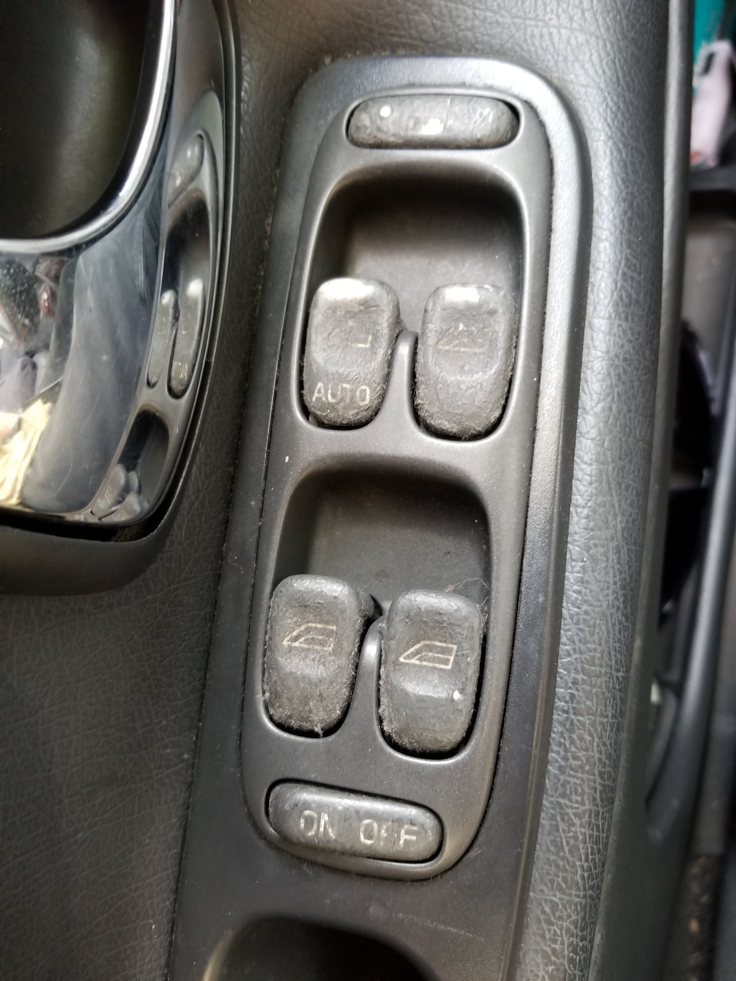

- what's going on with the plastic? A lot of the interior plastic is brittle, or has marks that don't look like wear marks. For example the power window controls and the climate control knobs. I stopped at a junkyard on the way home and interestingly the 850's that I saw didn't have this problem, but the three S70's all looked exactly the same as mine. I replaced my climate control knobs with the ones from the 850 (I think it was an 850, might have been a different Volvo, since some of them were too big). The stereo knobs have the same issue. Is this common? Any tips to fix?

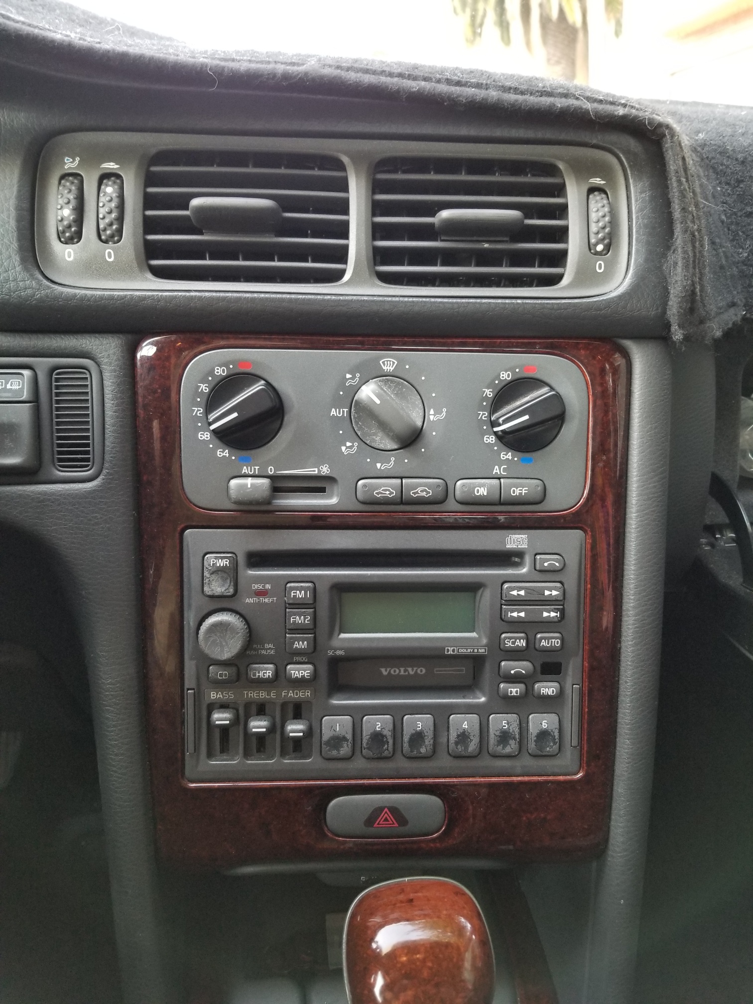

For example here's one of my old climate control knobs in the center showing the wear marks, surrounded by my replacement knobs from an older model:
The power window controls all have that same odd wear:

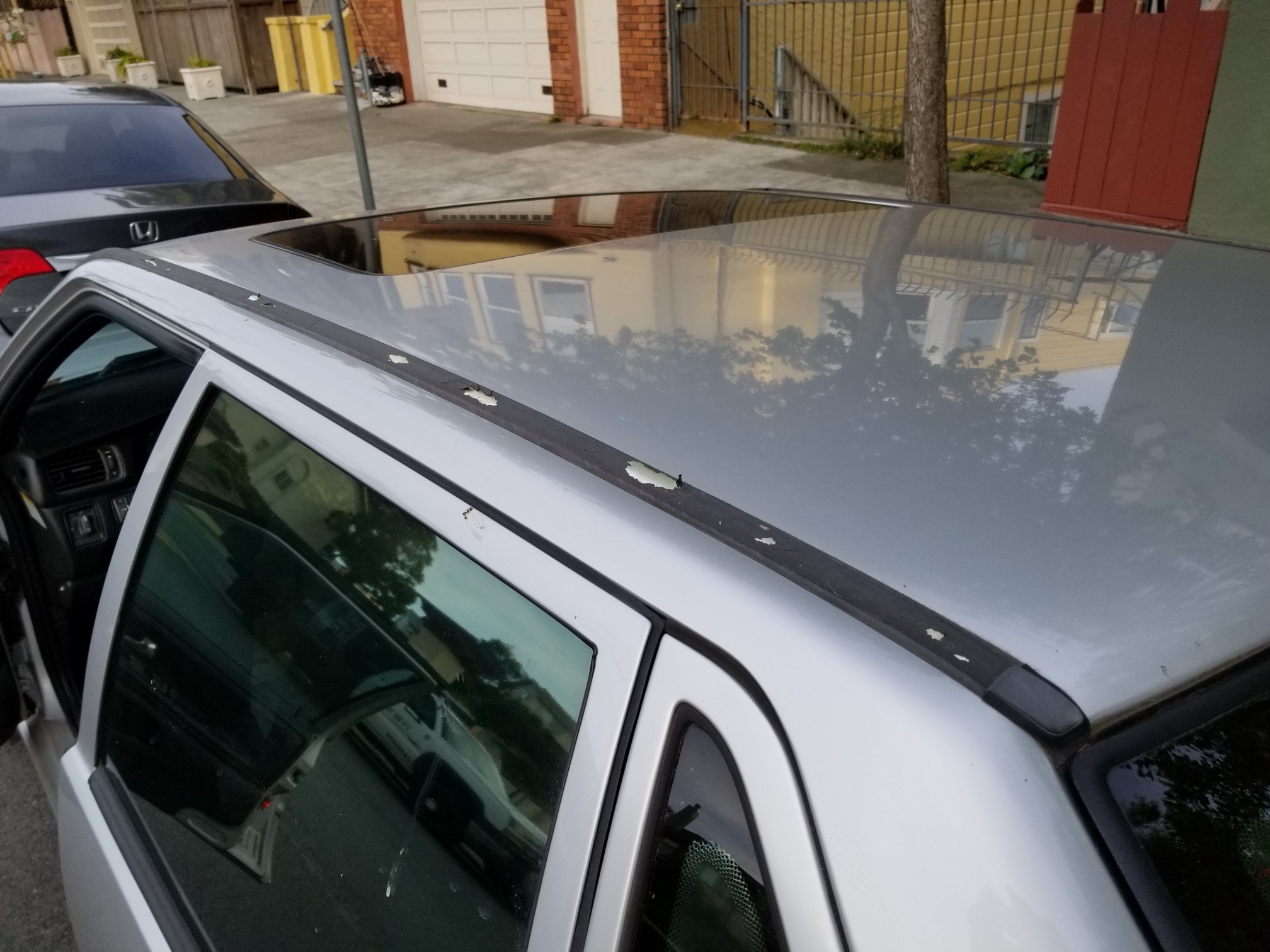

- The exterior is pretty pristine except for the (vinyl?) covering on the metal strip along the edges of the roof. Any tips on fixing that?

The knobs and switches are cover with grime (A concretion of Body oils, condensation, dust, fibers).
Take some Isopropyl alcohol on a microfiber cloth and buff off the grime. It will take a some work just keep the microfiber cloth damp with Isopropyl alcohol, flip as needed.
As the Isopropyl alcohol softens the grime, the cloth will pull it off. It will get uglier before it gets beautiful. Keep at it, they will shine again. Finish off with a clean cloth. A toothbrush can help.

Here's a post that explains the buttons in more detail, it is not as simple as "grime" but the best solution is indeed as simple as rubbing alcohol: https://www.matthewsvolvosite.com/forum ... hp?t=81022

And here's a thread on replacing that roof trim, which I think is called the "drip molding".
https://www.matthewsvolvosite.com/forum ... hp?t=76395
There's a link to a replacement for a bit over $100, and an interesting DIY suggestion from @clifford06 that I think I'm going to try:
"If you want a quick fix, get a spray can of "Flexi Dip" from local auto store. My roof strips faded from sitting for a year . I used painters tape and old newspaper to mask off for overspray. Sprayed several coats. I also did lower vents near fog lights and mud flaps on front wheels. It put a lot of life back in to the trim for just $8.00. I see 850's here in town that would look a lot better if the black bumper and body trim were brought back to life . Just a budget helpful suggestion."

Alcohol did a good job cleaning most of it, but on the driver side lots of the black paint is gone, with the white base exposed.
Volvo part number 8638452. After market as low as $25.00. Good quality Volvo OEM ~$150.00.
Ordered, thank you so much. $30 from Amazon.
