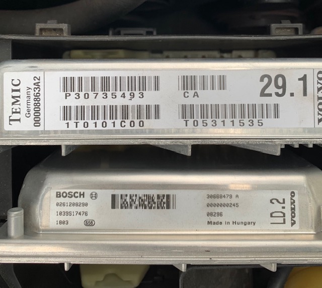

The next step is TCM (transmission control module) replacement. Dealership quoted $2100. I've been told this process is a hot swap and no software upgrade required. So I purchased from swedish car experts a used part and they also confirmed this is a hot swap process. They have found a donor 06 Volvo S60 98K.
When part arrived I noticed that all numbers are matching but one.
I have two questions:
a. Is it Okay to swap TCM even if one number is not matching? Please compare attached images. Do you see a difference in numbers: T05353085 vs T05311535. Not sure what these numbers mean therefore double checking.
b. Is it really a hot swap process and no software upgrade required? I just pull out and insert a new module?

TCM swap
Since nobody replied I went ahead and swapped TCMs. Computer gave an error - Urgent Transmission Service Required.
I was told by techs it's a hot swap but looks like not always a case. I put my original TCM back and error got cleared. Everything seems is back normal.
Just for the record, if someone will have same question.

They CAN be a hot-swap if the same level of firmware is fitted to the car's system. If car went back to the dealer for a Canbus upgrade they will have different firmware versions. Both cars (donor and receiver) would have left the factory with the same level of firmware.
The hardware is the same. It's a 50:50 chance of getting a match.
