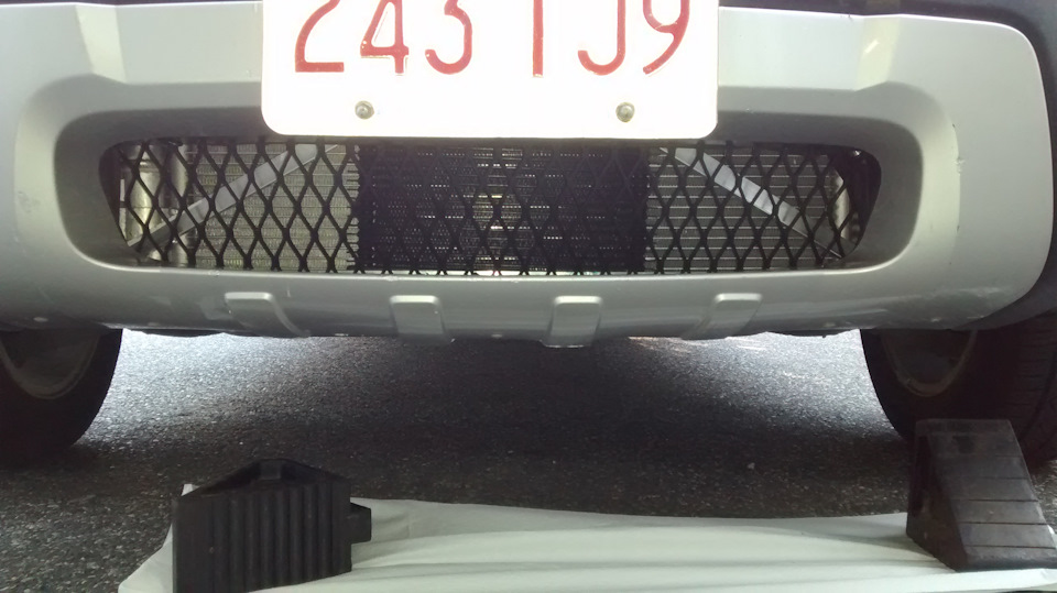

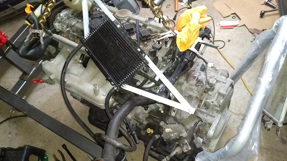

Installing additional oil cooler is a very basic job. Get Hayden Rapid-Cool of your choice and aluminium angles and bolts/nuts in Home Depot. Here's my frame for the cooler that mounts onto A/C radiator (it has mount holes):
And that's how it looks on the car:
Wise to install a 3/8" Magnefine inline transmission filter at the same time.
