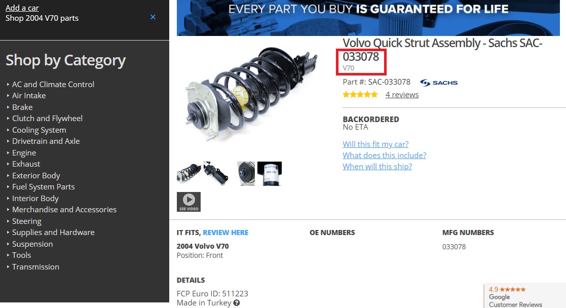

I need to buy the quick strut Sachs 033078 (Plug-and-Plug) but FCP says it is out for now.
This is the quick strut I want to buy:
https://www.fcpeuro.com/products/volvo- ... sac-033078
From my extensive search using Volvo web catalog, FCP website and many Volvo dealer websites, the V70 and S60 in the P2 platform share the same:
- Strut Bearing
- Spring Seat
- Coil Spring
- Strut (Sachs or Bilstein)

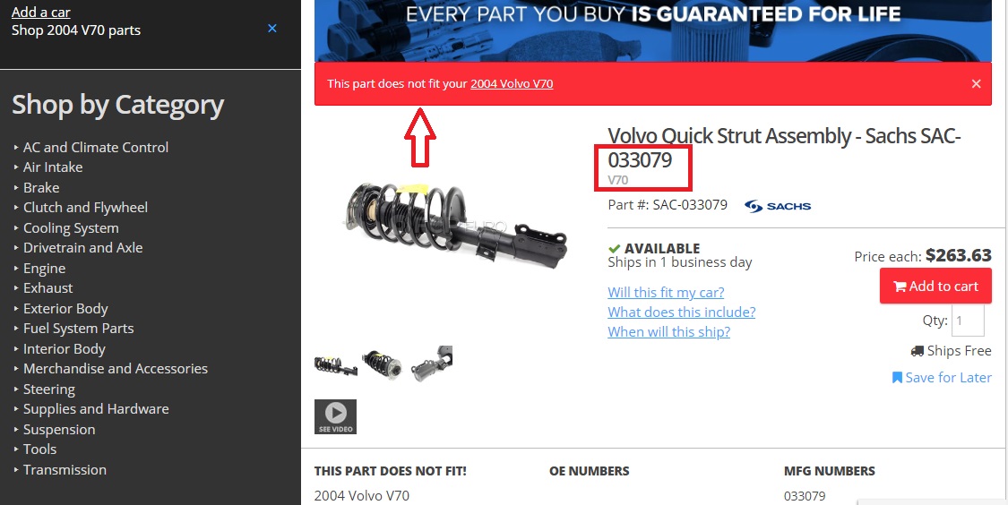

What I don't understand is why Sachs says:
- 2004 V70: use Sachs 033078
- 2007 V70: use Sachs 033079

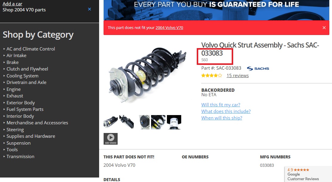

- Let's say 2004 S60: use Sachs 033083
I wonder if they are all the same stuff...
I can find some Sachs 033083 as they are still available on some websites and wonder if this S60 thingy fits in my 2004 V70...

Thanks but I already called IPD last week.
They do not have it in stock.
Also, IPD web listing says 033079, but photos show one with 033078.
I personally think all these Sachs numbers I posted above are interchangeable for 2001-2007 P2 such as S60, V70 (non-R models).
But if anyone has tried this (using 033079 in a 2004 V70), I'd like to know.
I have verified all individual PNs such as spring seat, strut bearing, strut itself from different vendors, and they fit these years.
I don't know why Sachs 033079 says "From Chassis Range: 547727", whatever it means...
