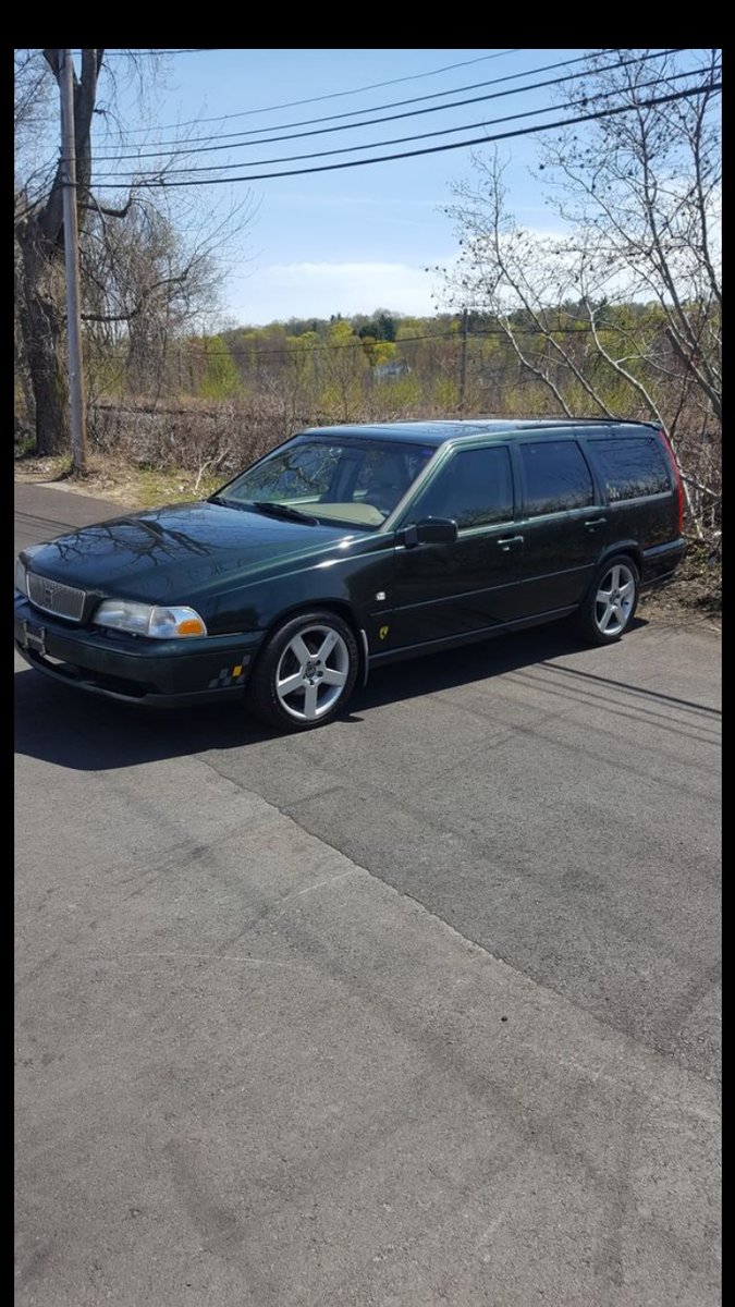

Hello guys. So first off i havent been here for awhile but have recently rejoined the volvo family after a 2 year break. So my wife picked up my daughter her first car. I find this out when i return home and its parked in driveway....
So cars a 2000 v70. Looks great perfect pegasus rims new tires great interior nice type r spoiler and some nice stickers like the dancing moose etc. First thing i noticed is reconstructed title..wife didnt know what that means..2nd dash says 180k title says 195k 2 years ago...so i start it up and heres how it goes:
First started up perfectly and she purrs at idle perfectly. New suspension,brakes,battery,alternator, pcv system done recently have no smoke or pressure out oil cap etc.
So then i shift it into gear and it starts to vibrate,shudder. I drive it and the shudder is constant through all speeds and gears. Feels like a dead cylinder would at idle but engine checks out perfectly. So i take it on highway and it shifts perfectly through all gears but this shudder/ shake/vibration is constant and does not feel good at all..off hand i was thinking torque converter. Im very mechanically inclined and have done engine swaps etc just never had to diagnose anything like this. Im praying someone can give some advice.
