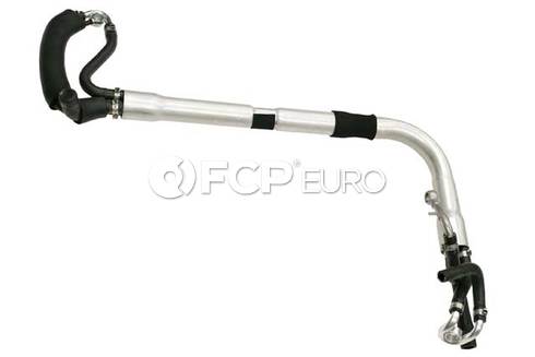

Did you check the Crankcase Vent Hose for leaks? $390 part.
ÜRO makes a rebuild kit for the Crankcase Vent Hose, which can be found on eBay for as low as $50.00
Yea I know ÜRO does not have the best reputation but $50.00 vs $390.
As far as I can see ÜRO the only ones that make a rebuild kit.

if you are sure the PTC hole is open, then its the hose. either clogged breather or broken vacuum.
