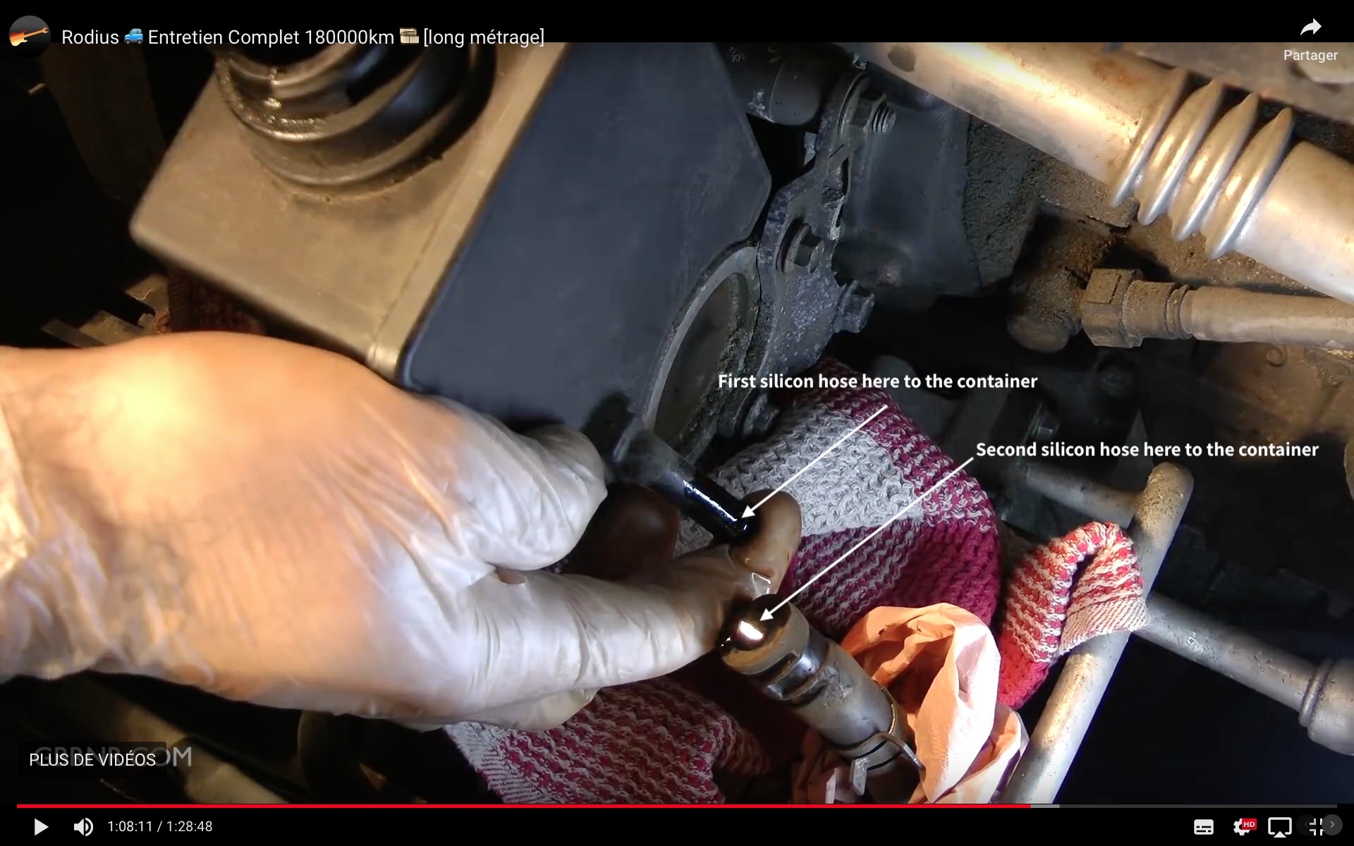

Hy
I would like to know how I can purge the power steering circuit from Blue. The car is from 1995, and I think to change the liquid wouldn't be a bad idea.
Any tip somewhere ?

On the early cars, most just remove the old oil by sucking it up with a tool like a cooking baster ( tube with rubber bulb, maybe faufilure en Francais? ) and then replacing it, and repeating this three times.

Hy Abscate,
Thanks for your tip. I've found another solution. 2 silicons hoses, plug one to the bottom of the steering reservoir, one on the "return - low pressure hose ", then the 2 hoses in a container. Turn steering wheels on a side, and on another, without forgetting to watch out to the steering fluid level...

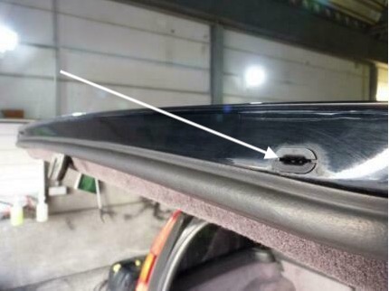

A little question : Does someone know what's that thing ?
