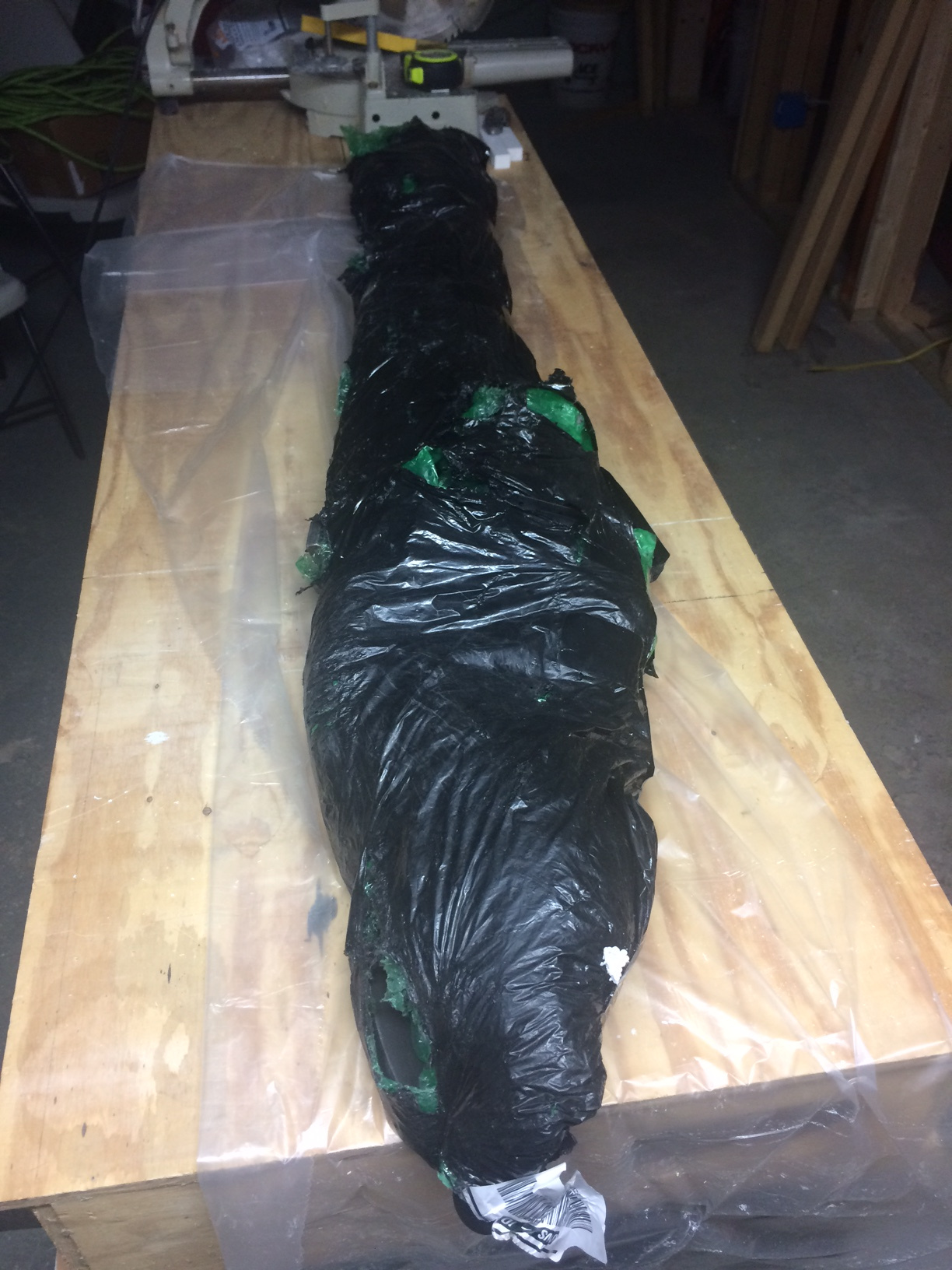

The supposed speed-sensitive rack I recently ordered from eBay showed up 1) in a plastic bag (!) and 2) as a non-speed sensitive rack. The journey continues. The application of the bar code stickers to prevent the tie rods from breaking through the bag were a nice touch, but ultimately unsuccessful.

It’s just not a place to source auto parts unless it’s a place with a real presence and uses eBay as a portal, IMHE.

Agree, but sadly this is a real place.that does as you say. The first rack I received was a thing of beauty, just the wrong kind. I believe that others in this forum have suggested a place in PA (name escapes me right now) so I'll look in that direction moving forward.
