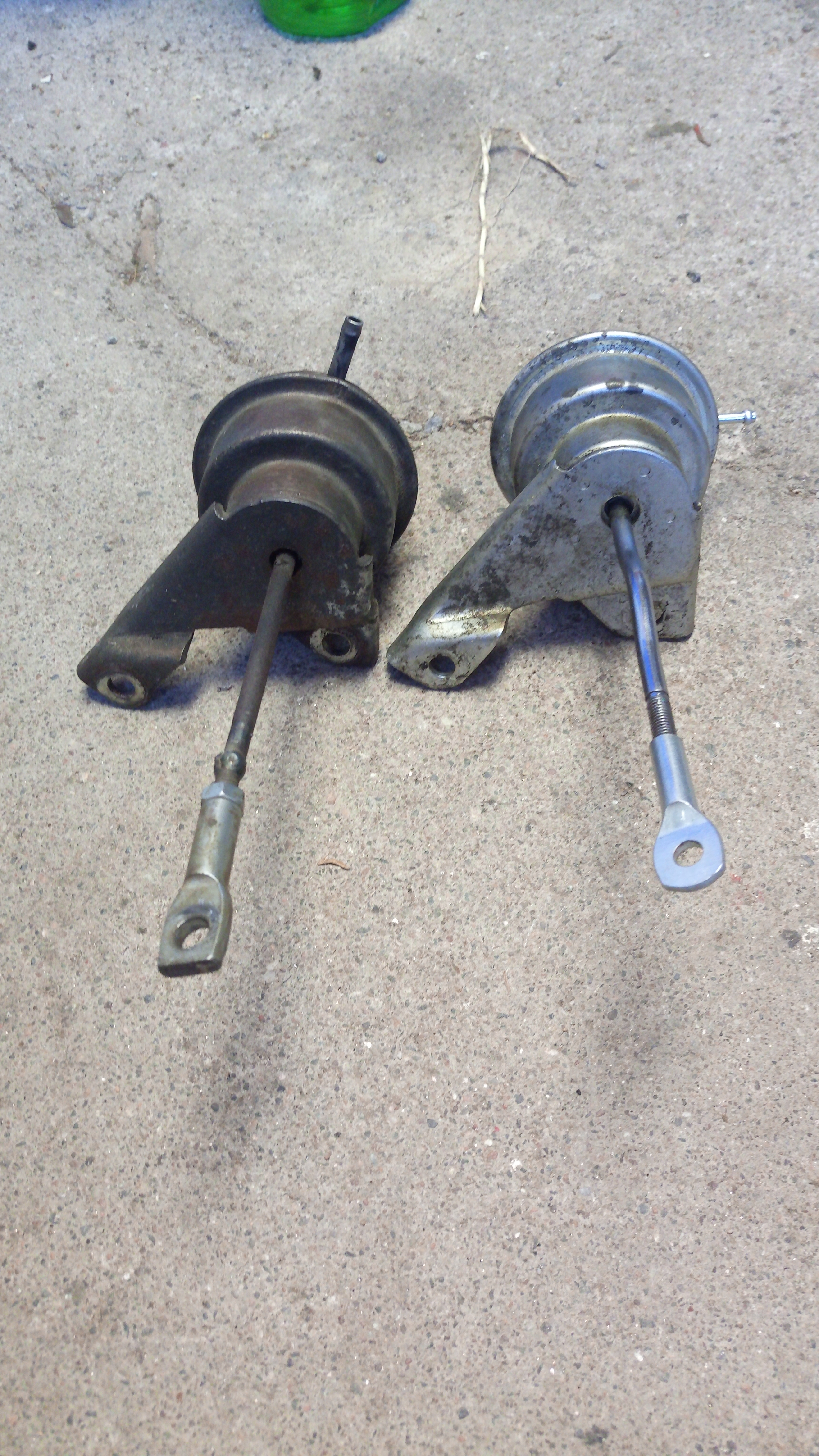

I just swapped wastegates and oh boy what a difference vs stock old wastegate! I actually answered my own question on this tropic. before it was boosting 1.2 bar and peaking 1.4 during shifts (Automatic) + the VTEC feeling at 4k rpm. Totaly gone. On the old wastegate i had 4mm pre tension now i have a total of 2 turns, about 1.5mm pre tension and boost is quick, linear and predictable! No VTEC feeling. Goes quickly to 0.7 bar at 2500rpm and as the rpms increase the boost also increases to about 3500rpm and it has a smooth sweep on the aftermarket gauge. With the new wastegate max boost is 0.9bar with 1bar at shifts but i guess its only because i got a custom tune to suit the worn wastegate and needs to be re-tweaked to suit the new. Heres a picture with the old and new wastegates and why i was worried to use the supplied wastegate that came with the turbo.
Case Closed.
Thanks! :D

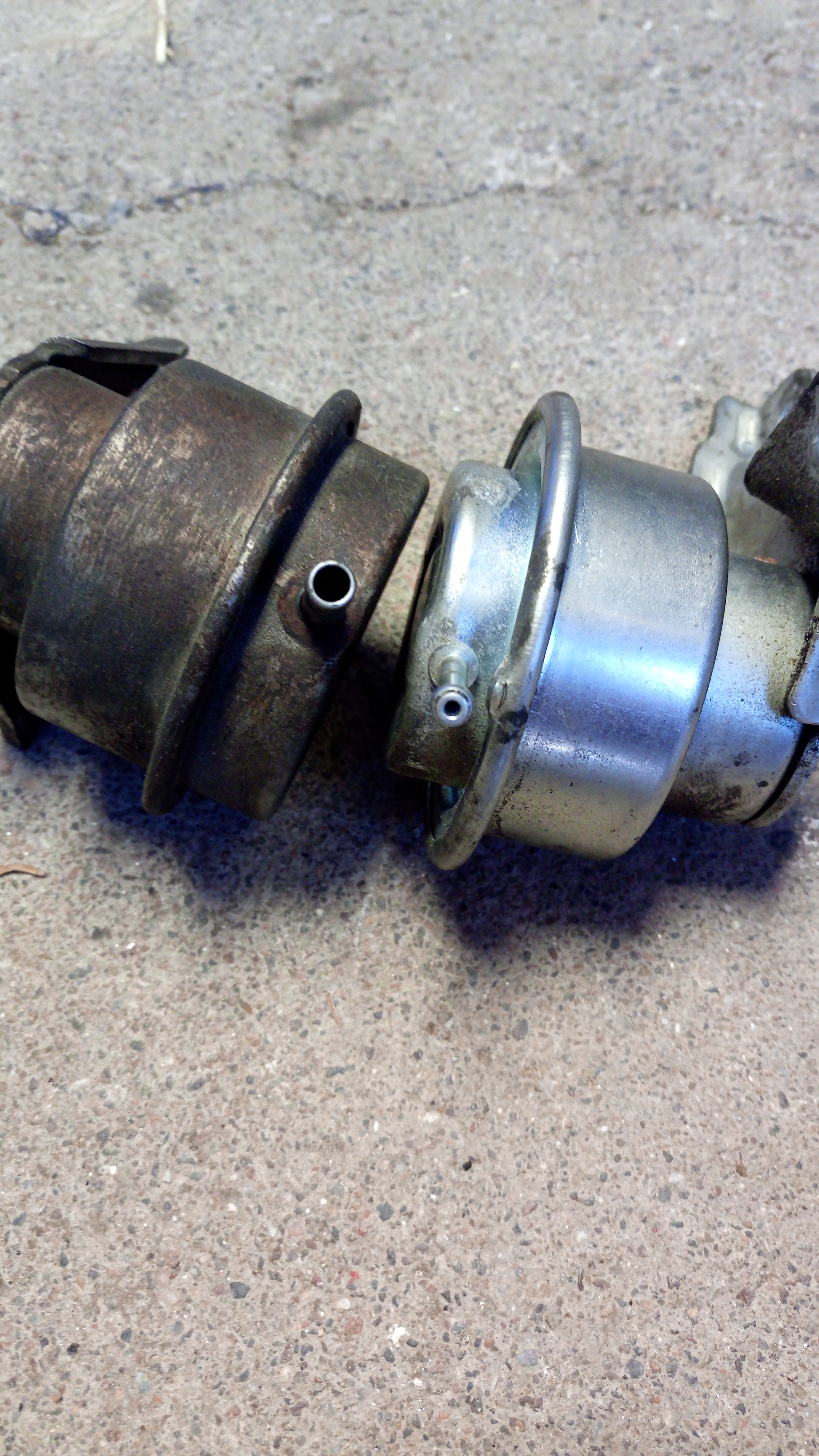

If you look closely that's a home made restrictor shoved into the vacuum nipple,, It appears to be a piece of break line end. now I have to scratch my head as to if thats good or not. it would slow the reaction but still reach max limit of overboots. I would think it would allow boost to come on dangerously early, but maby the 18t is slow to boost and engine would be protected at low rpm by that.

tardcart wrote: 21 May 2019, 15:59 If you look closely that's a home made restrictor shoved into the vacuum nipple
I see why you’d think that, but I doubt it. My 1 bar Kinugawa actuator looks just like that, right out of the box.

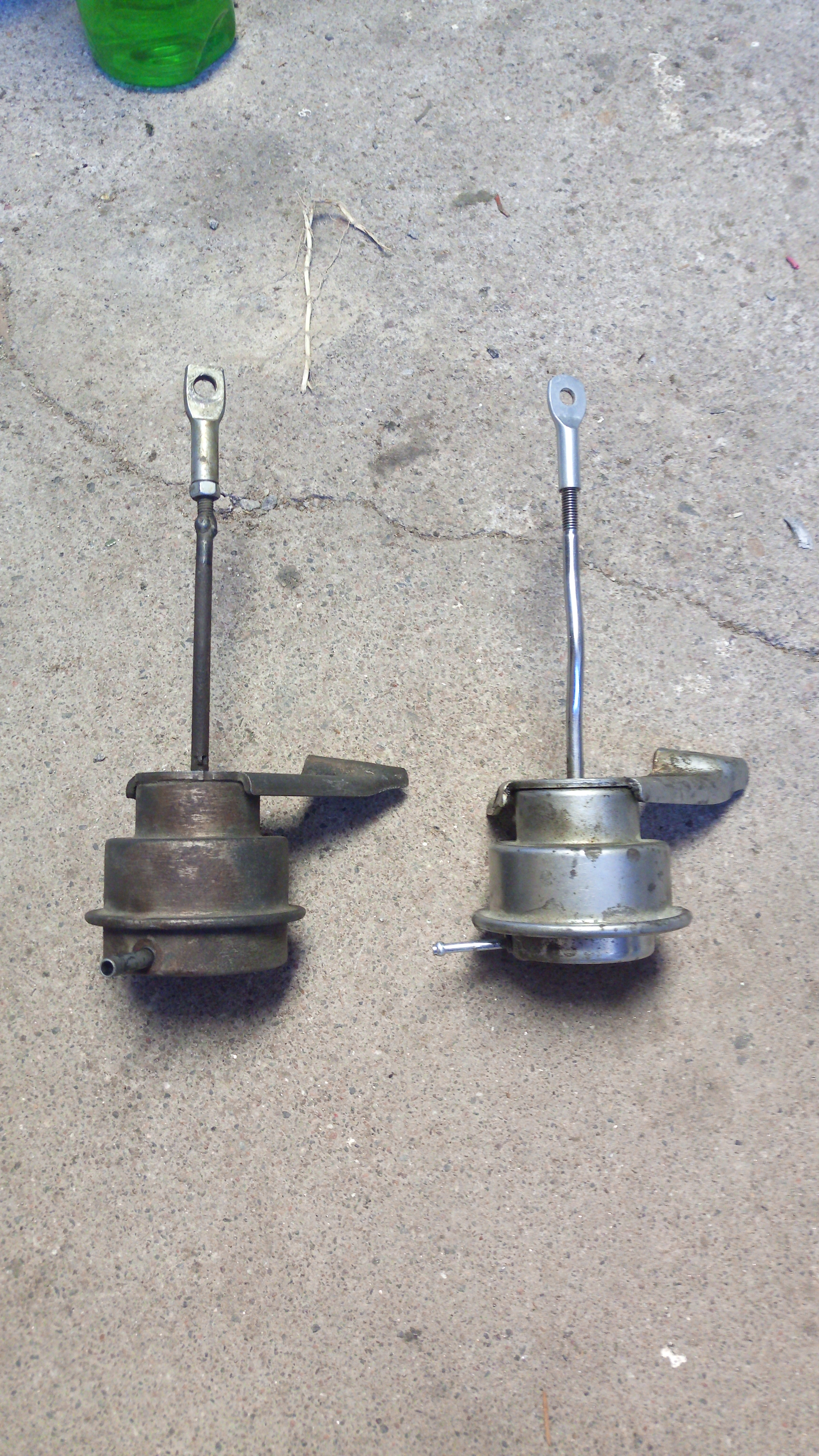

Nope it came like that in the box. Yep wierd! No homemade stuff here. Heres comparison stock mitsubishi and the new
