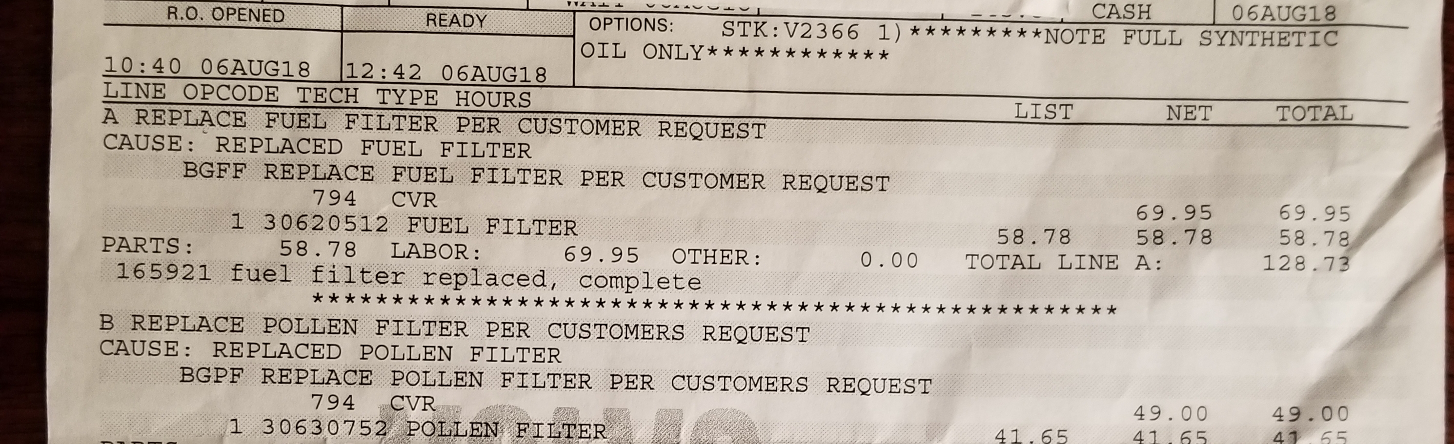

My Volvo dealer charges $128.73 for a fuel filter change and around $100 for a full synthetic oil change so you were grossly overcharged!!! Also all Volvo dealers use only Genuine Volvo parts. So +1 for run away fast from your shop! They charge 100% more than the dealer! I attached a picture of a fuel filter replacement last year at my dealer. June
