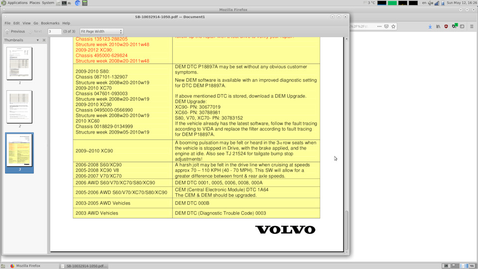

There's a software update 30677019 for DEM that fixes a few problems, one of them is what you've described:

So mine, falling under the 2003-2005 AWD vehicles category, DEM DTC 000B = "oil psi faulty value".
I honestly have no idea what the last software update was, there hasn't been one to this car since we bought it @127K back in the end of 2012.
But noting the condition of the filter media & such couldn't that 000B have been created by the pump not being able to suck through the original 280k filter?
Edit: not having VIDA, I have never seen any of these codes. Just what I'm able to pull via ELM327 type readers.
