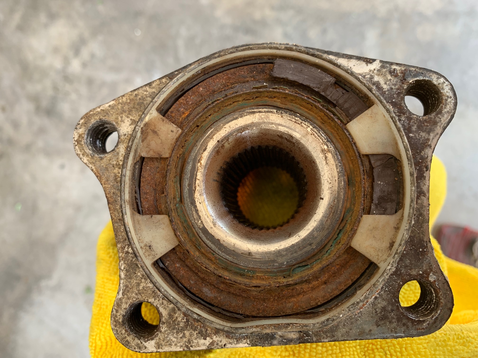

Replaced the rear sensors and still have the same issues and error codes. Not sure which code to keep troubleshooting. First code and light is the traction control and the second light is the ABS..... not sure if the first traction control light is associated with the second ABS fault.
ABS code says the left rear sensor is not responding.

Nasty. I used a Centric rear hub on my FWD but I think your XC uses an expensive rear hub,,,sorry.
Jim from MN just did one and found source ow price about $120 or so, vs $176 for FAG from usual supply chain.
