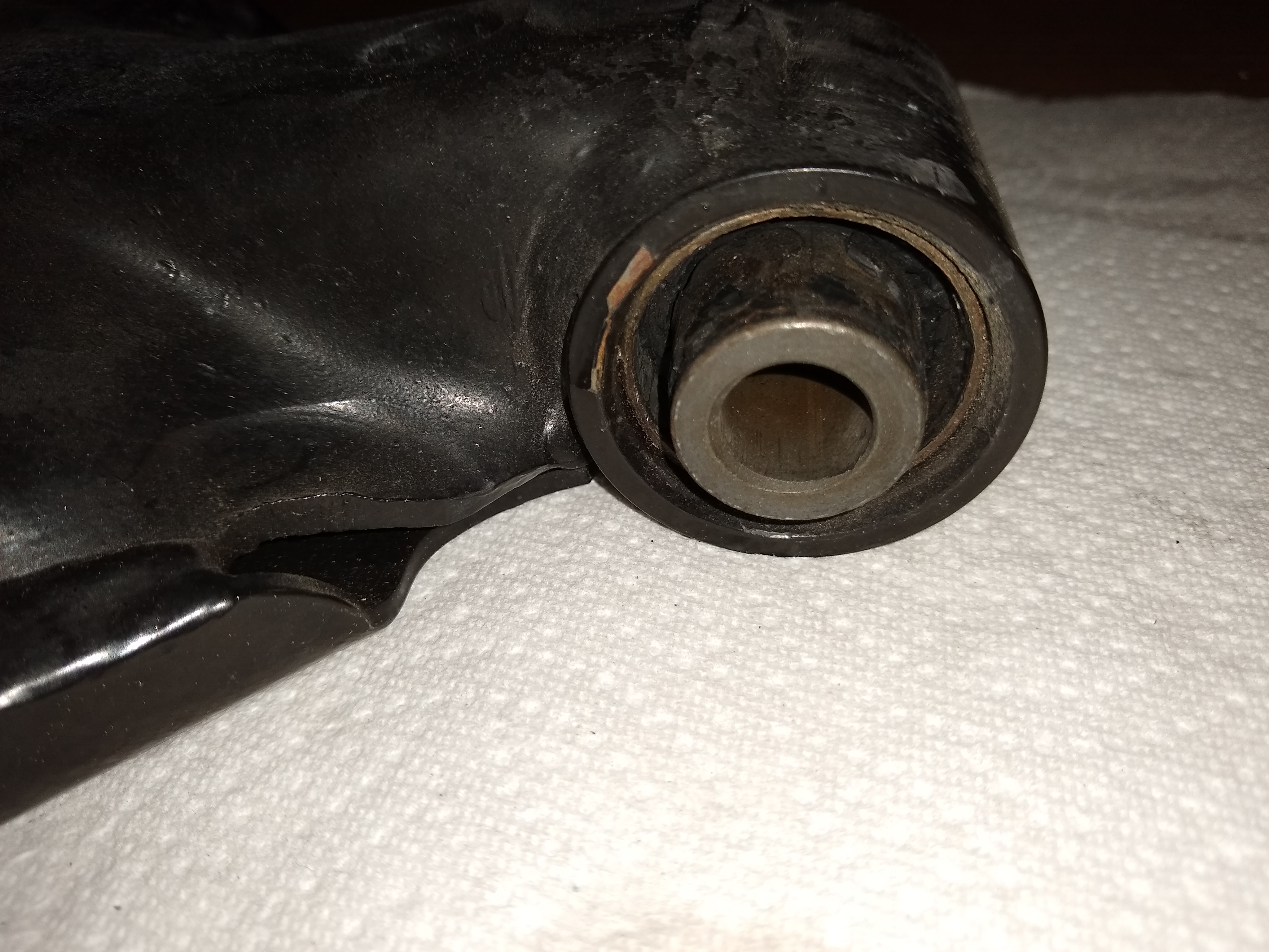

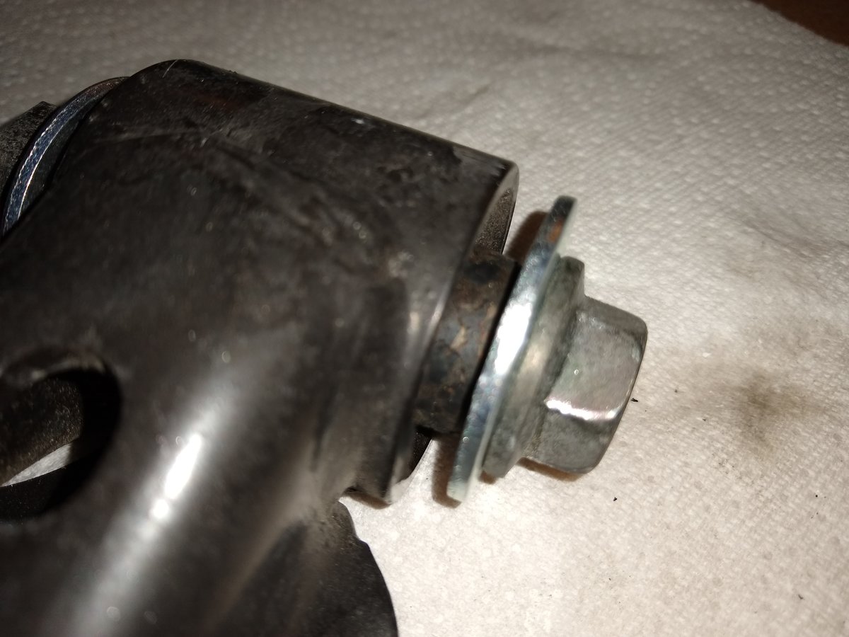

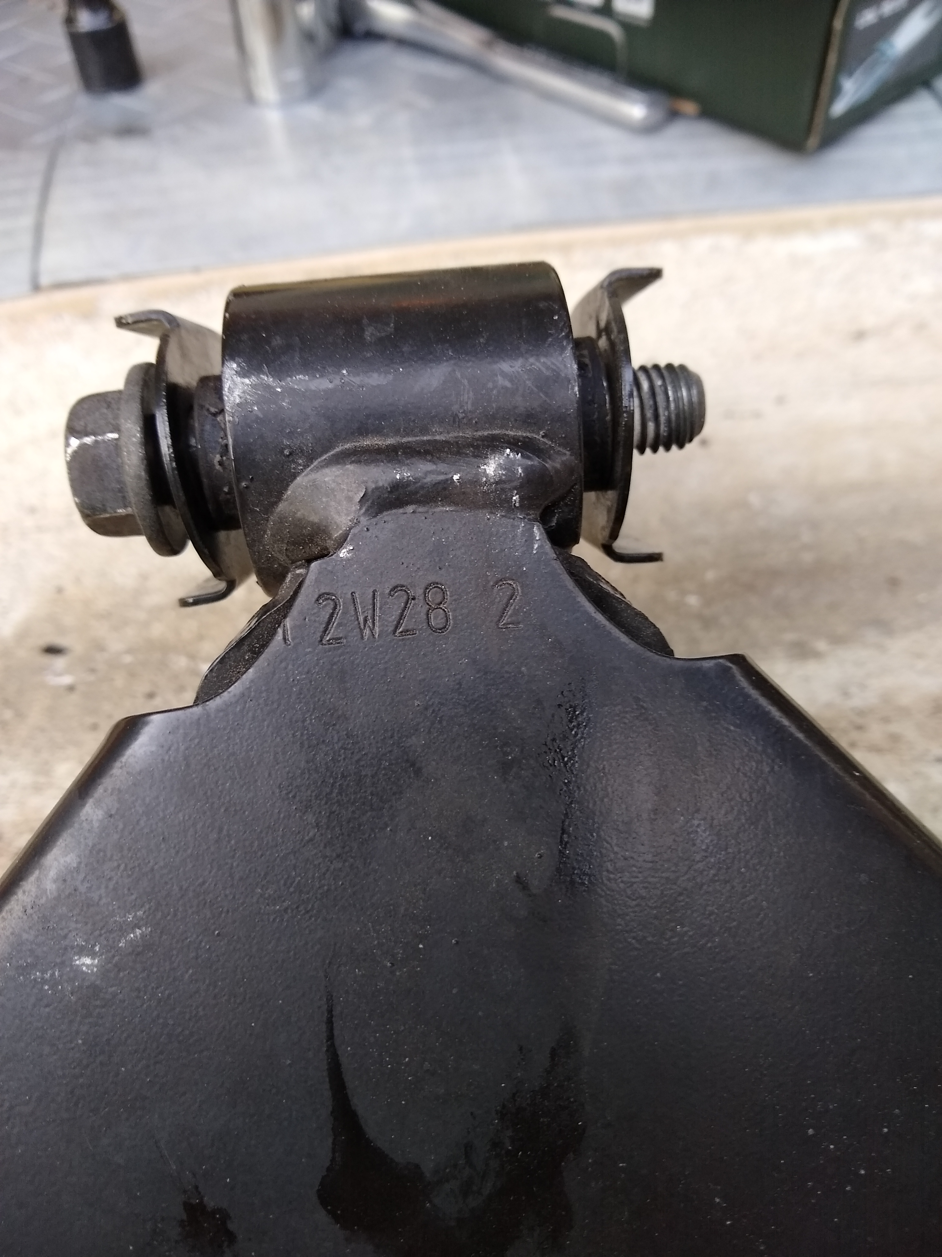

There is however a slight pulled of the steering to the left for a split second when moving from a stop. I suspect it could be the lower control arm bushing as most the mounts except the transmission torque mount looks pretty good. It could potentially be the sub-frames bushings also. The thought of removing the bolts on the driver's side control arm front bushing just wasn't appetizing as the Trans-Pan is almost next to it. Seems like you have to jack the engine up a little to get to it. I thought of what I can do to maybe insert some spacers into the bushing in case the rubber was not torn, if indeed it was the bushing.

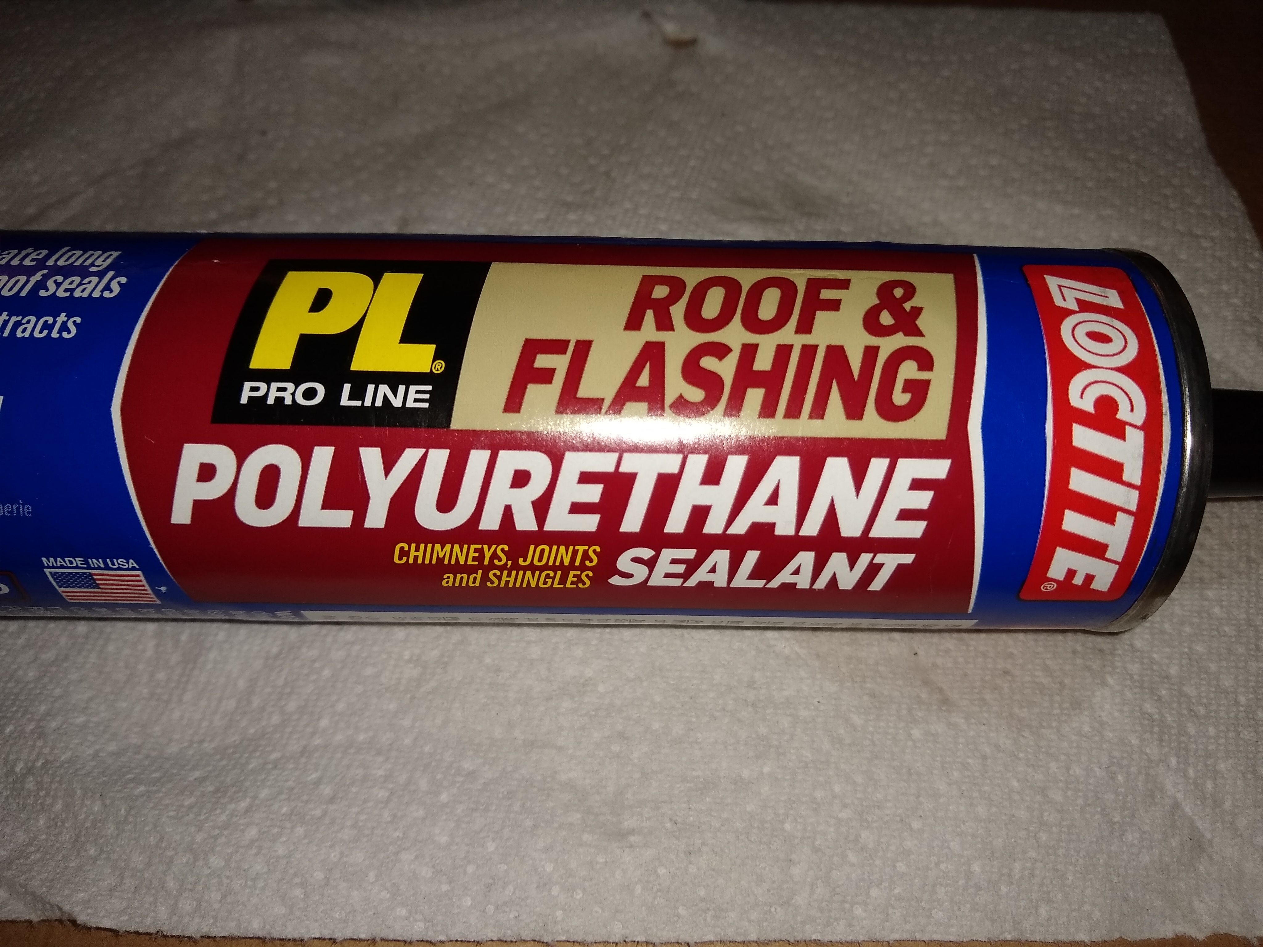

The two common products used are the following:
3M 08609 Window-Weld Super Fast Urethane Black Cartridge
https://www.walmart.com/ip/3m-08609-Win ... e/17039480
PL 10 fl. oz. Black Polyurethane Roof and Flashing Sealant - New Stock Does Not Have S30 On Label @ HD
https://www.homedepot.com/p/Loctite-PL- ... /203163733
Poly has good adhesion and flex.

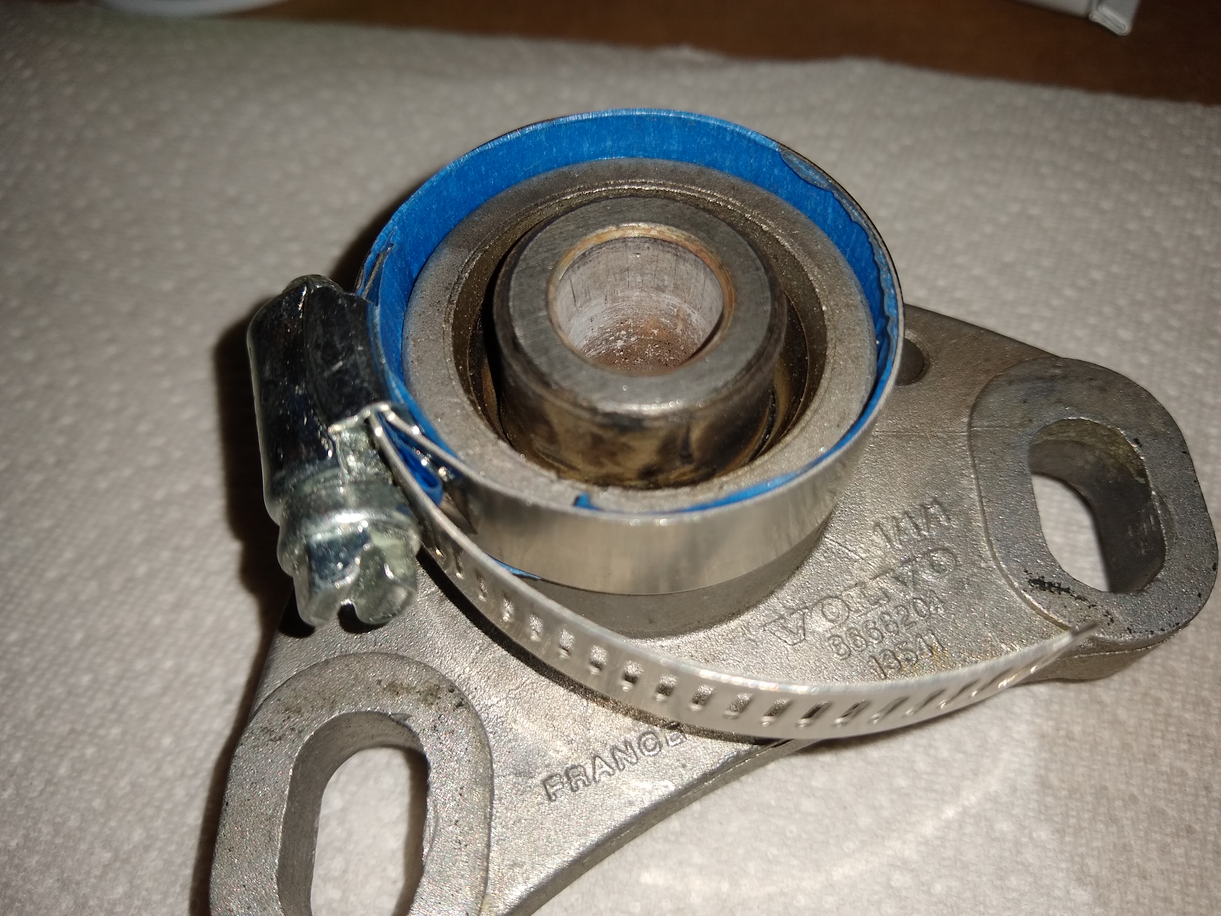

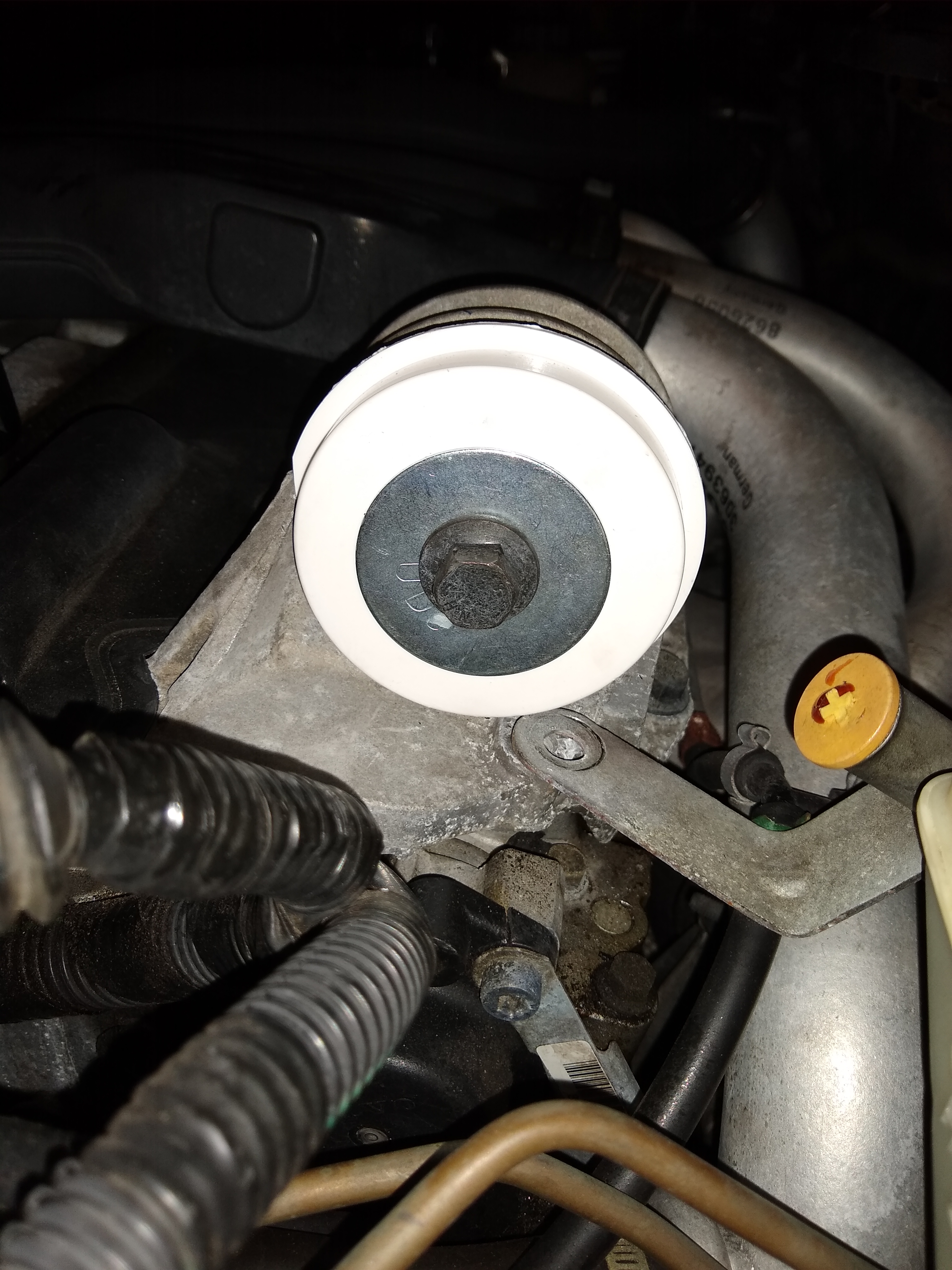

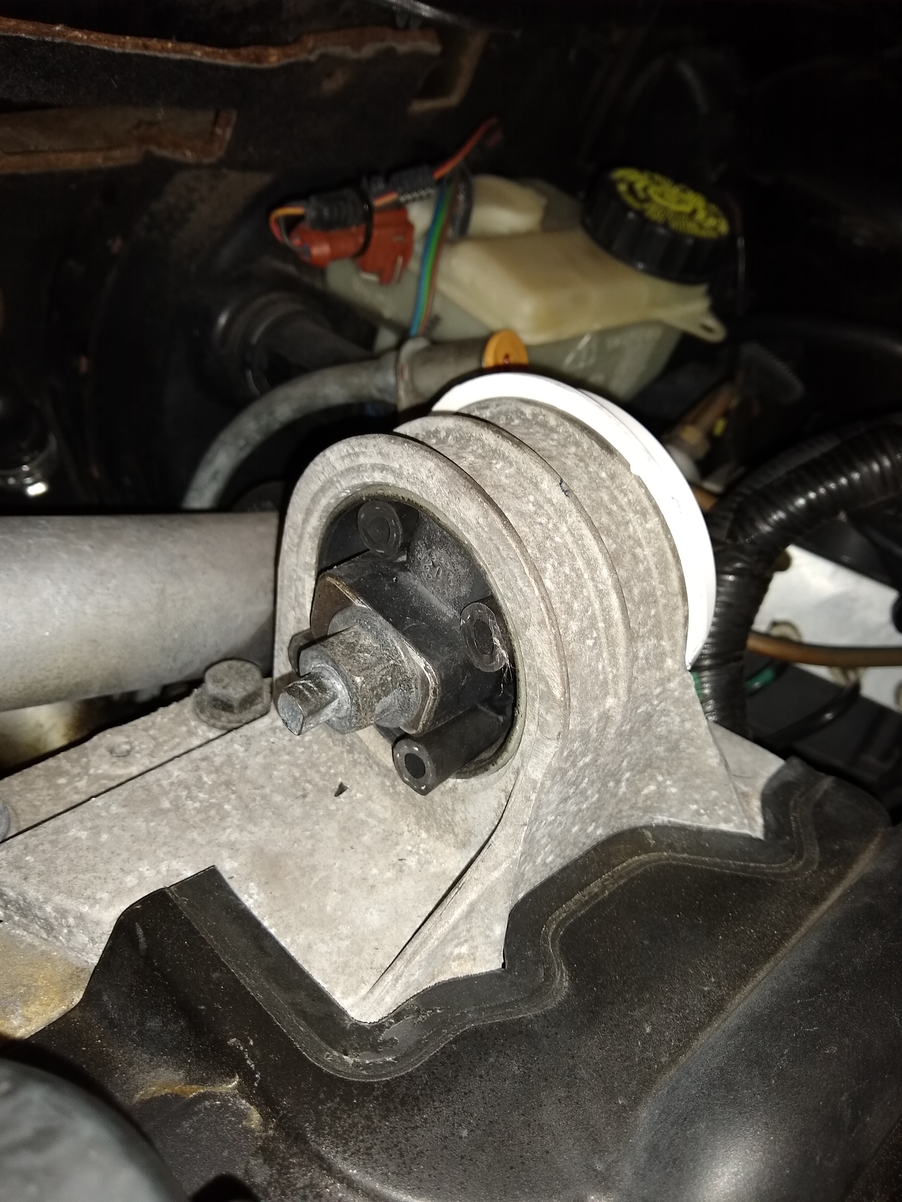

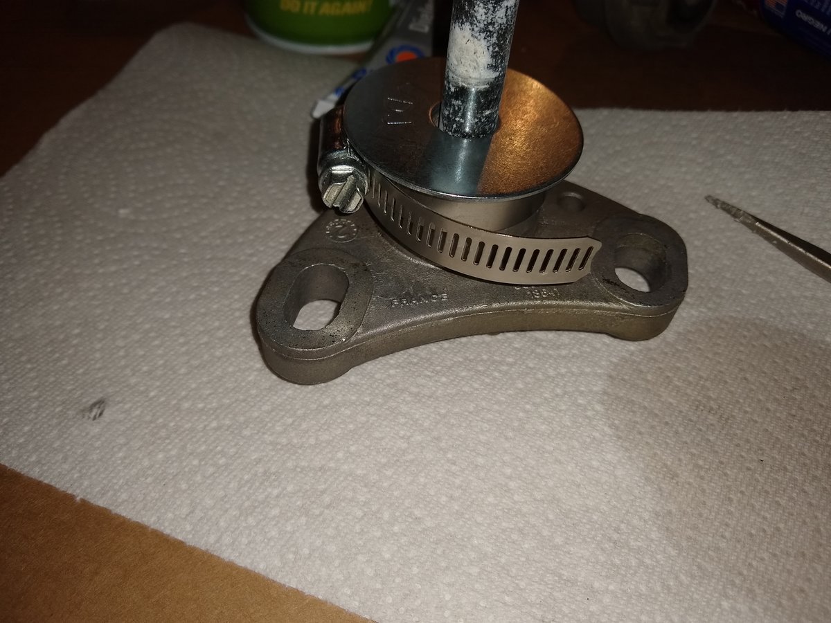

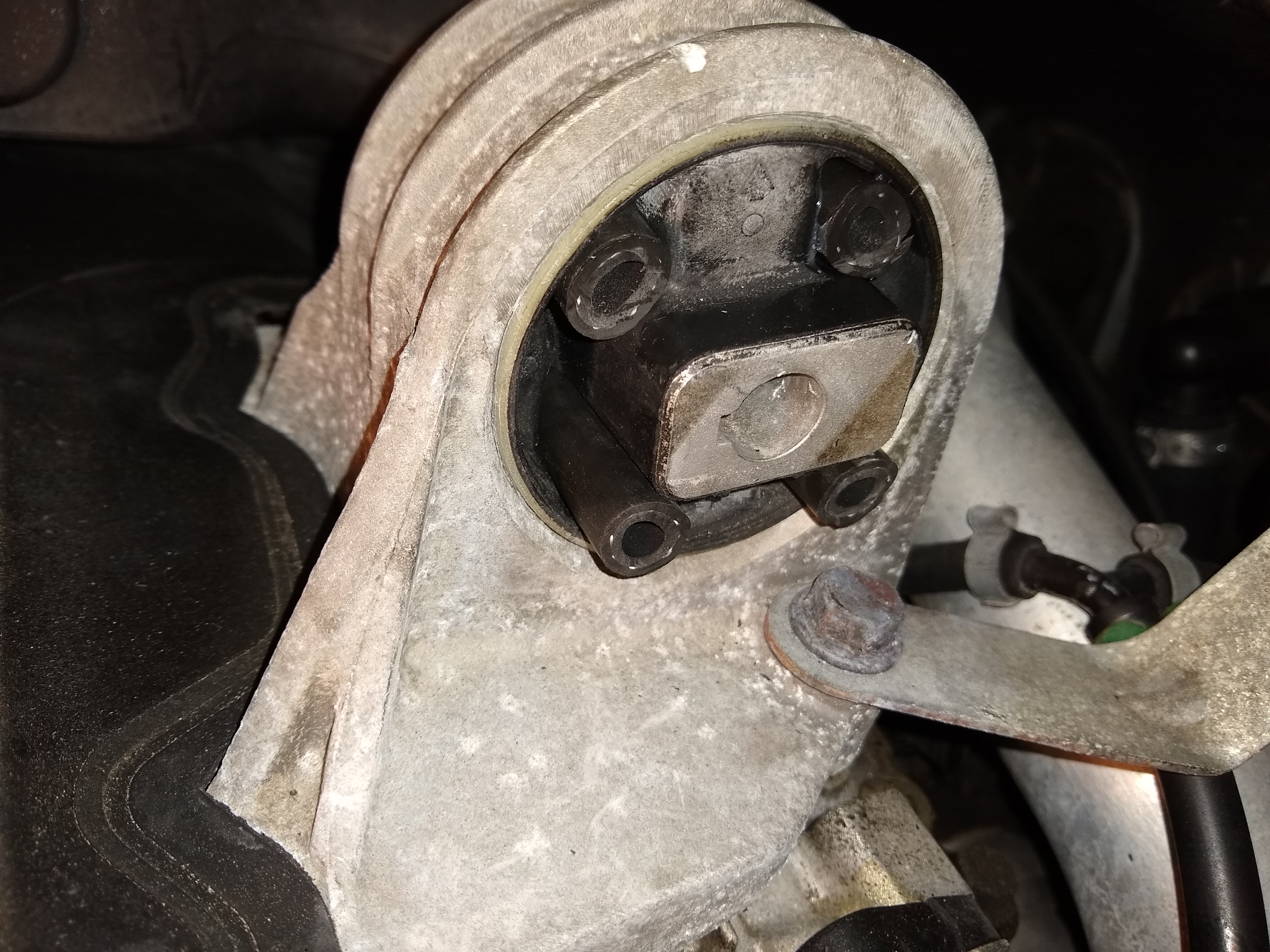

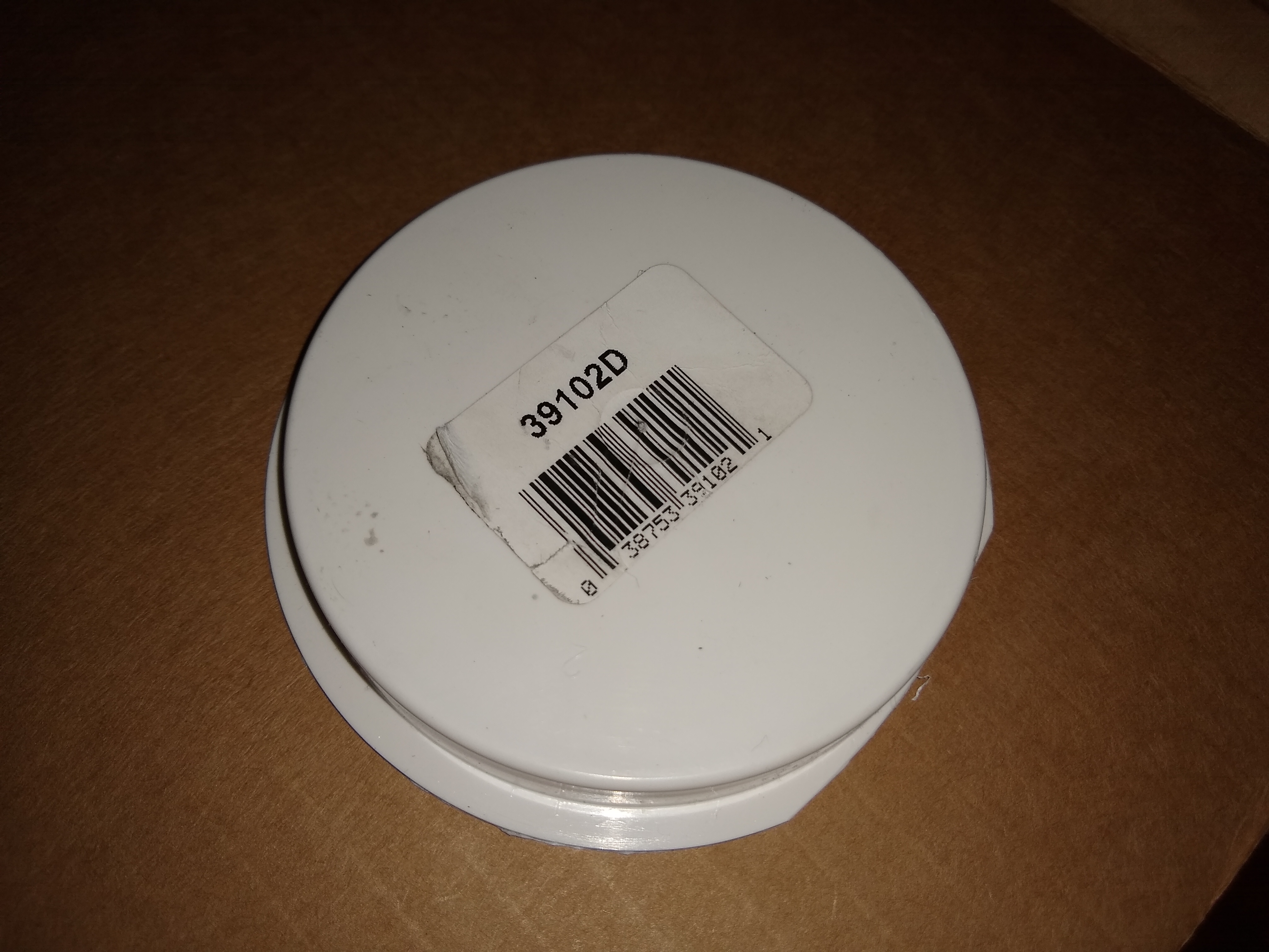

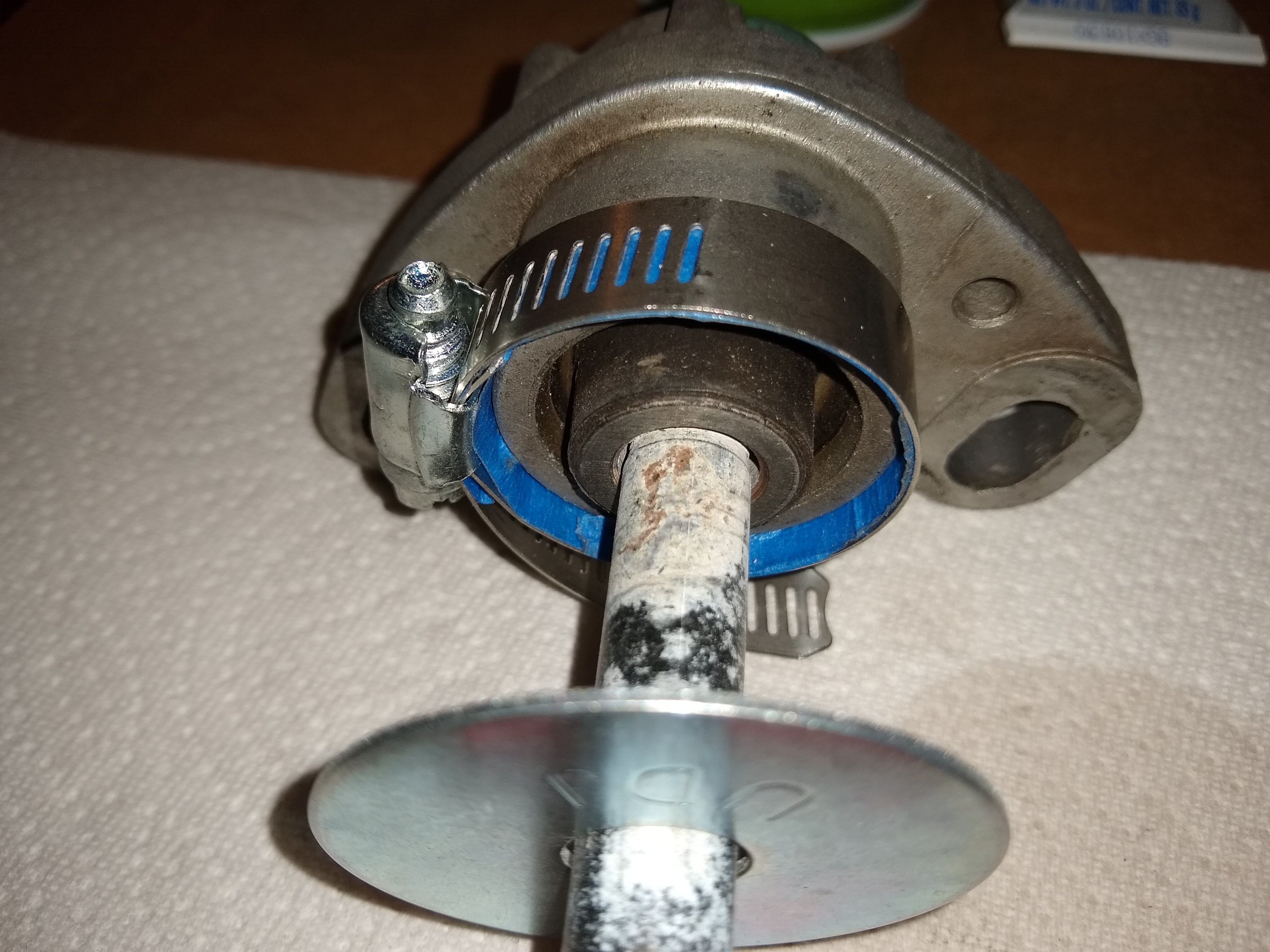

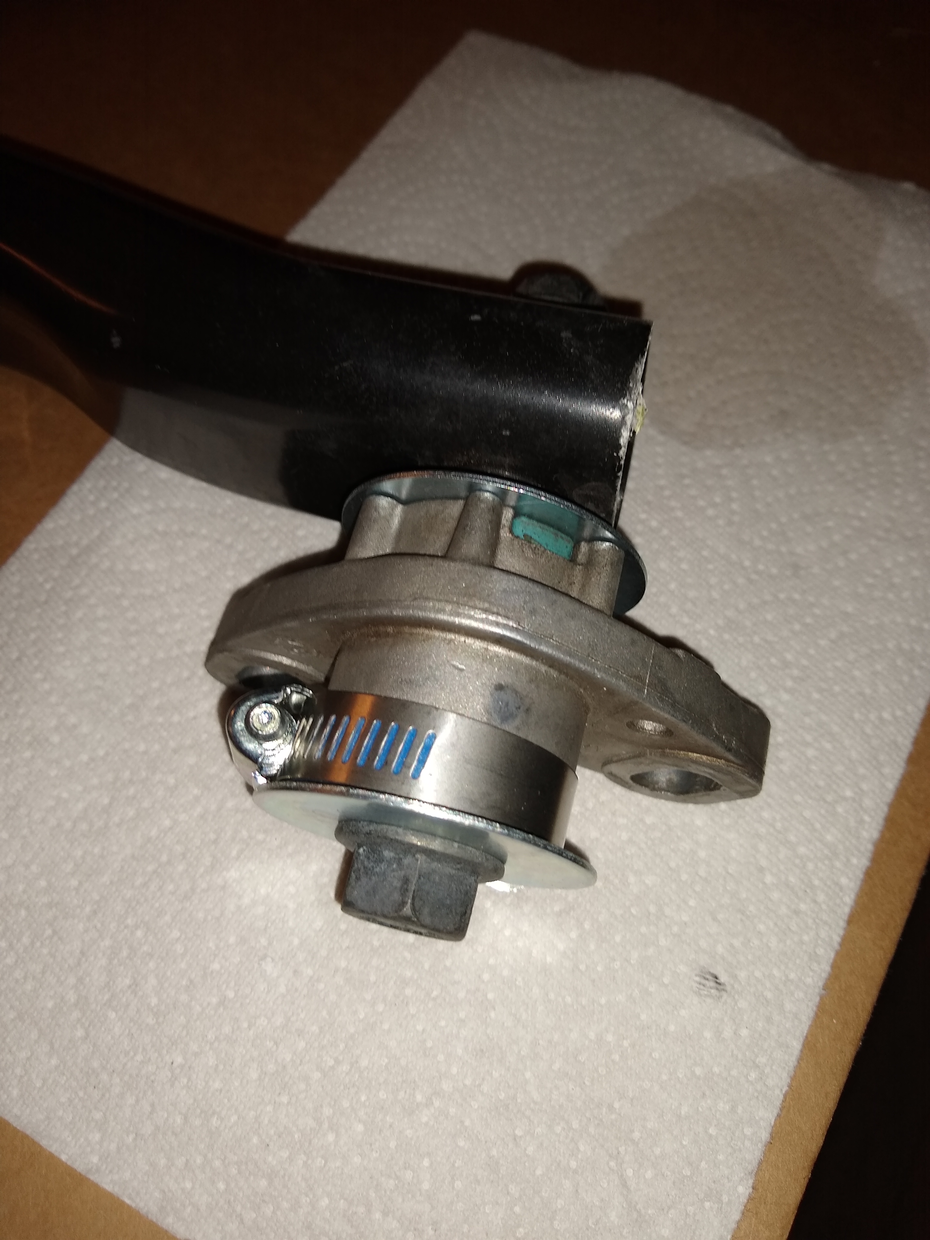

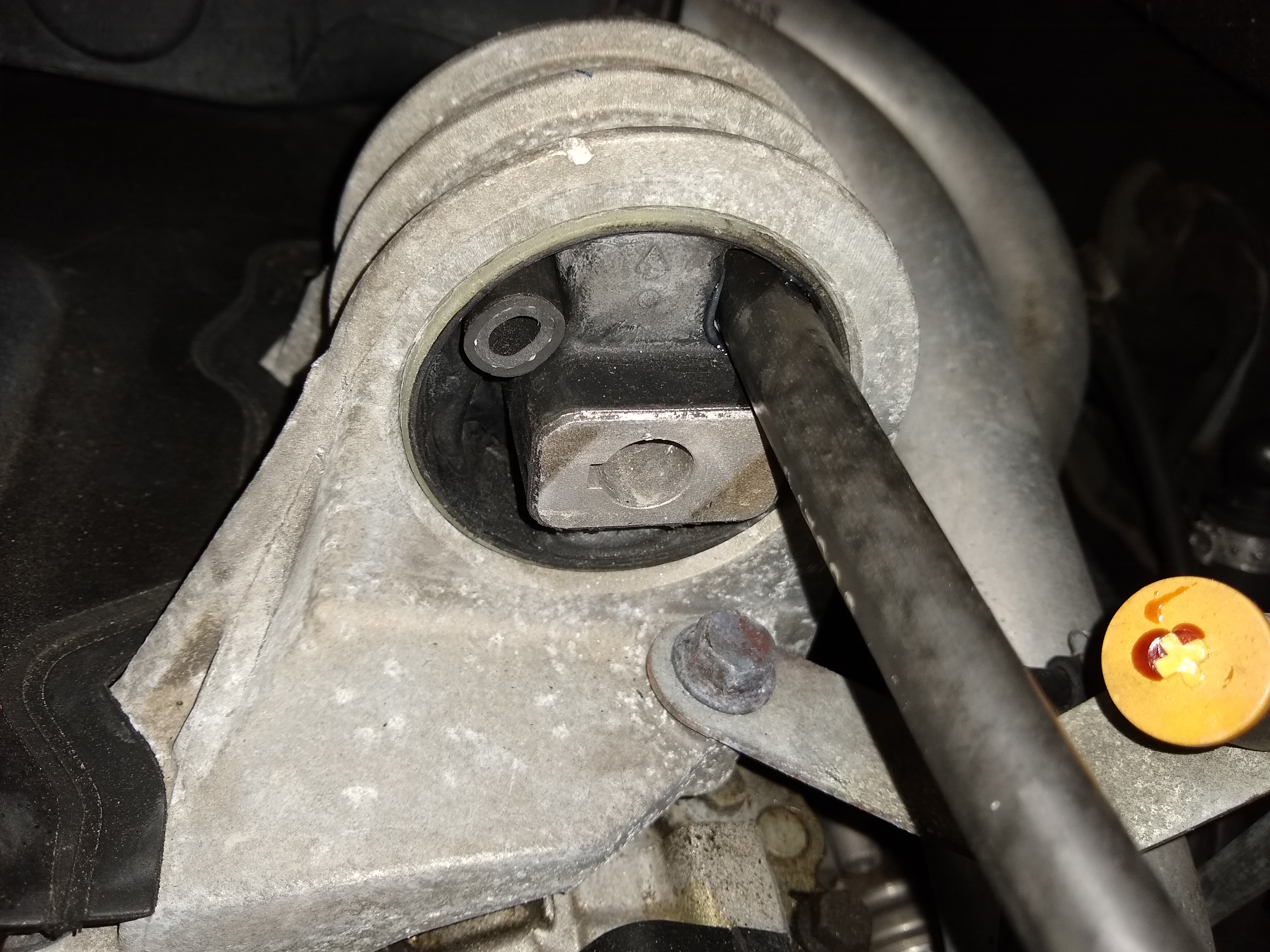

I plan on starting at the top and later to the torque mount, sub-frame bushings, control arms and lastly front engine mount. Everything will be cleaned de-greased and sanded where possible for adhesion. The Upper Mount inserts are shorter allowing for a greater amount of Poly while the bottom will provide a connection for the inner and outer poly. The white PVC Cap (Home Depot) was trimmed in two spots so it can be centered on the mount. Doing one side at a time for better curing.

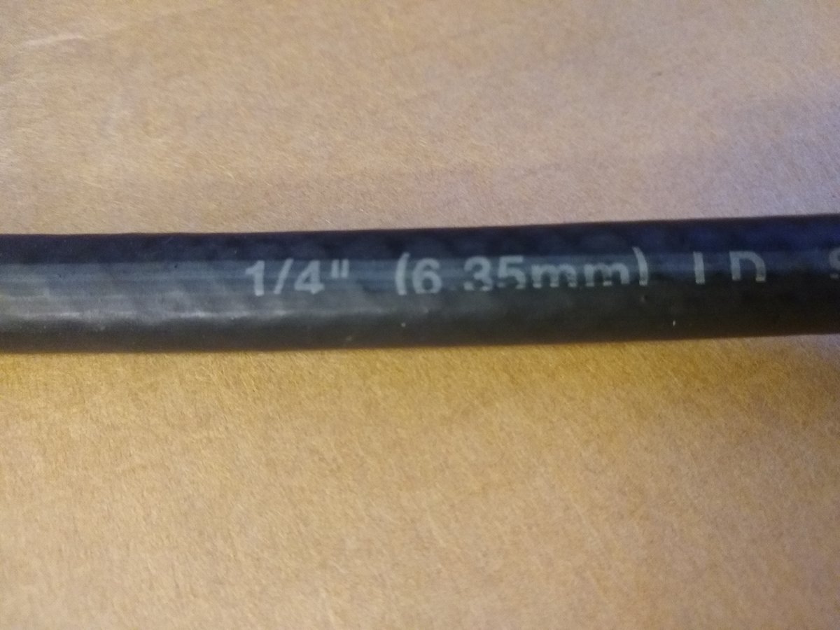

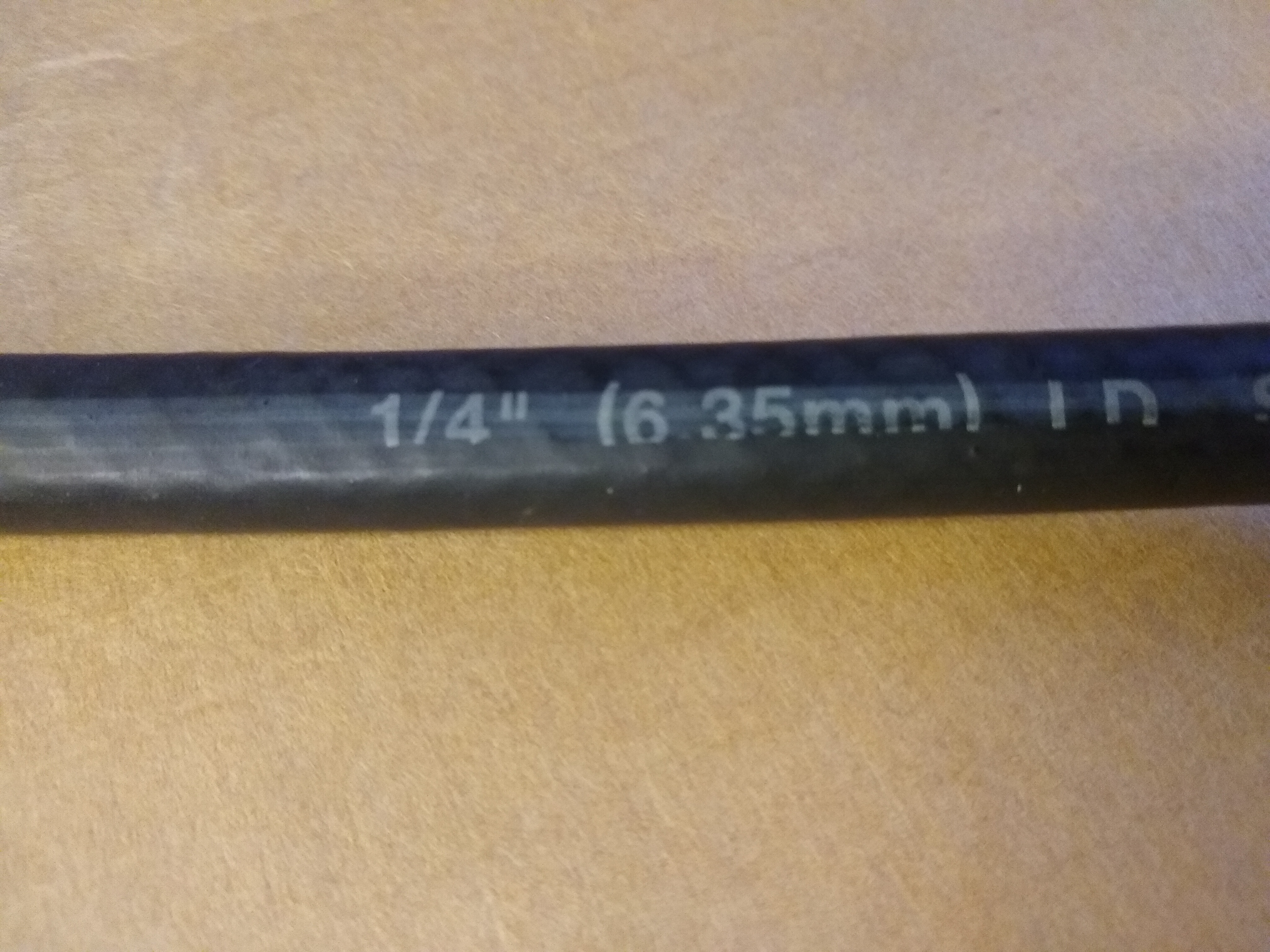

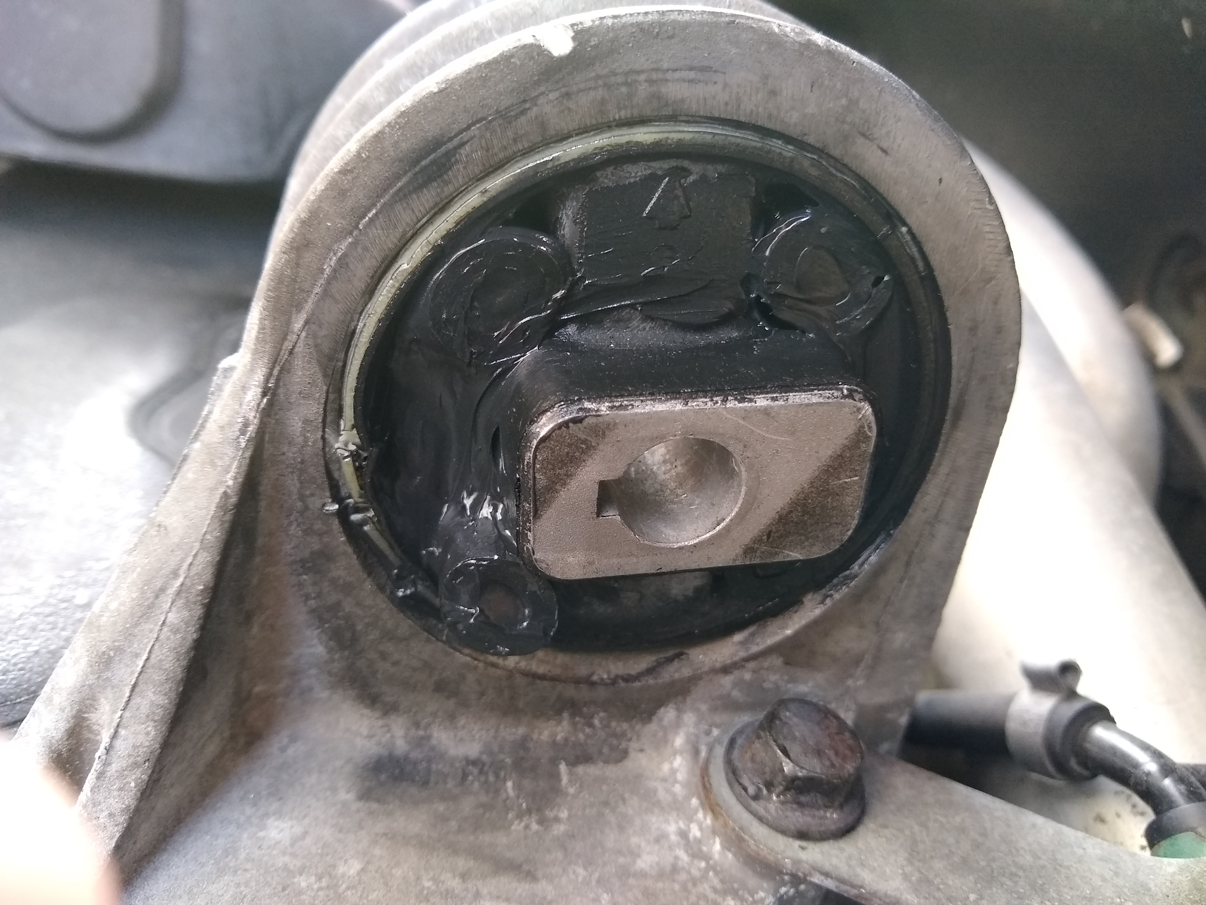

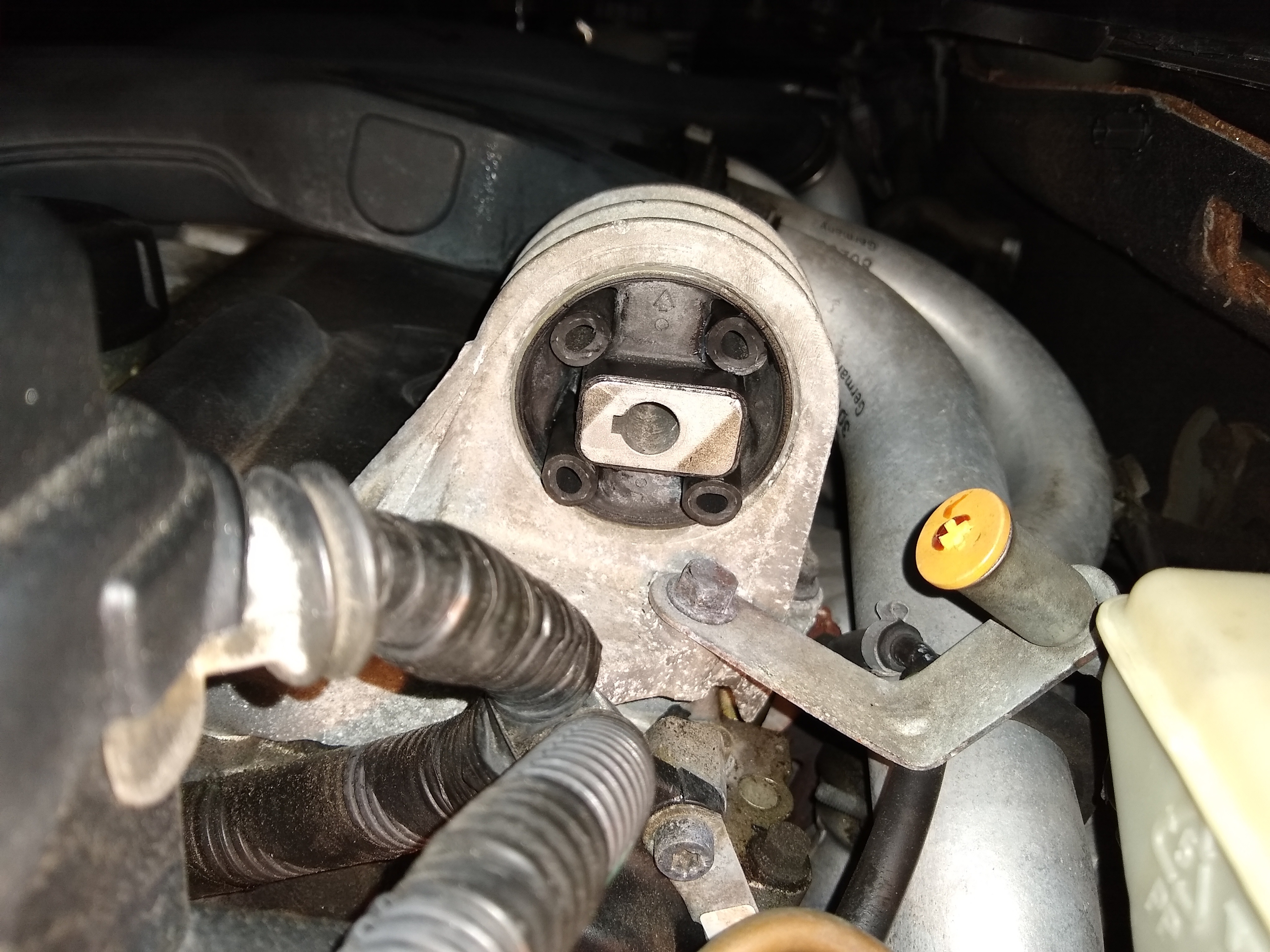

Upper Engine Mount - Saw IPD selling inserts for their Poly Mount so came up with this before applying the Poly to the entire cavity. This alone would add longevity to the mount.
If you want to try this and think the hoses might slip out just use a zip tie around each or a little Poly Sealant.

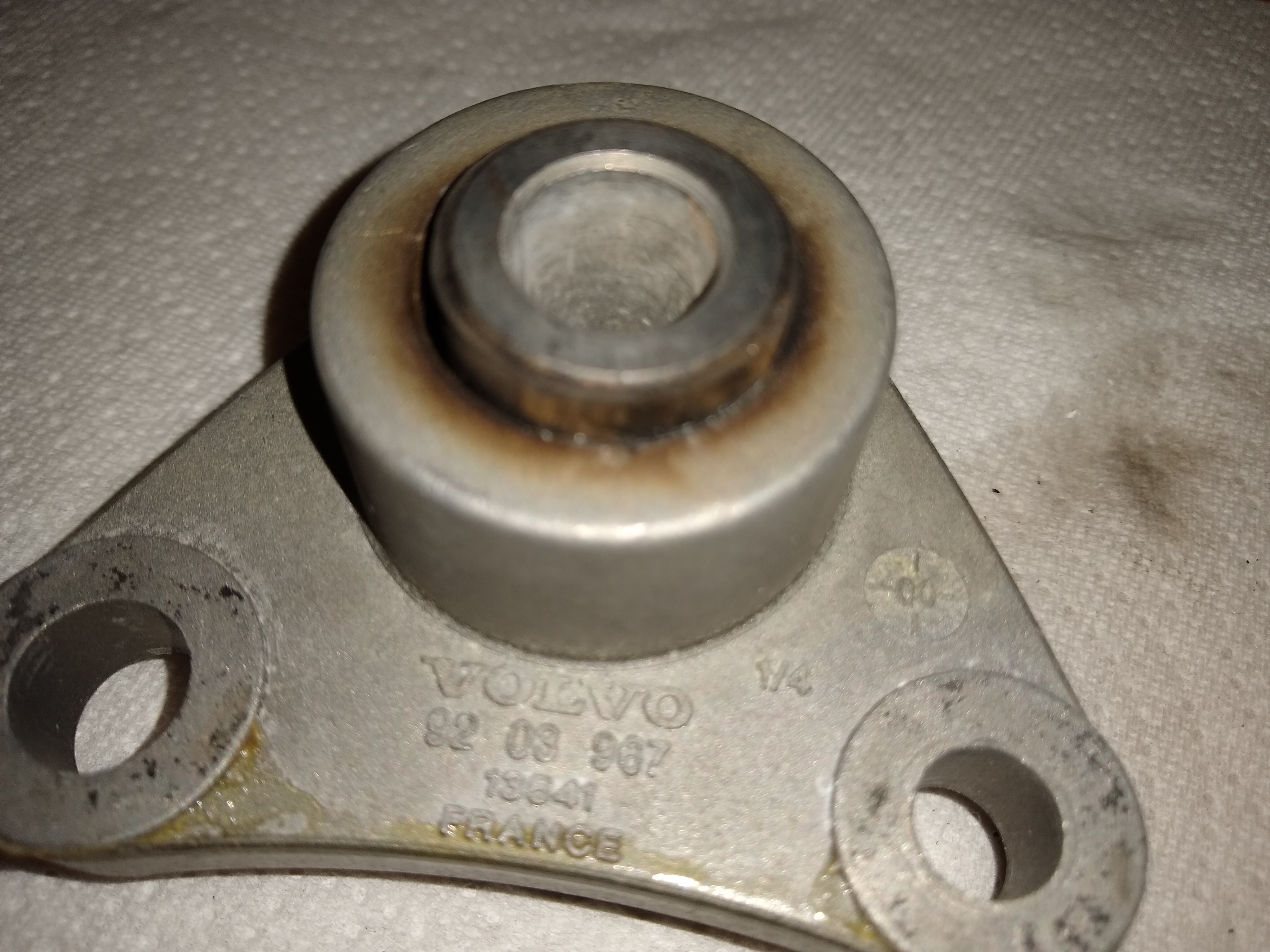

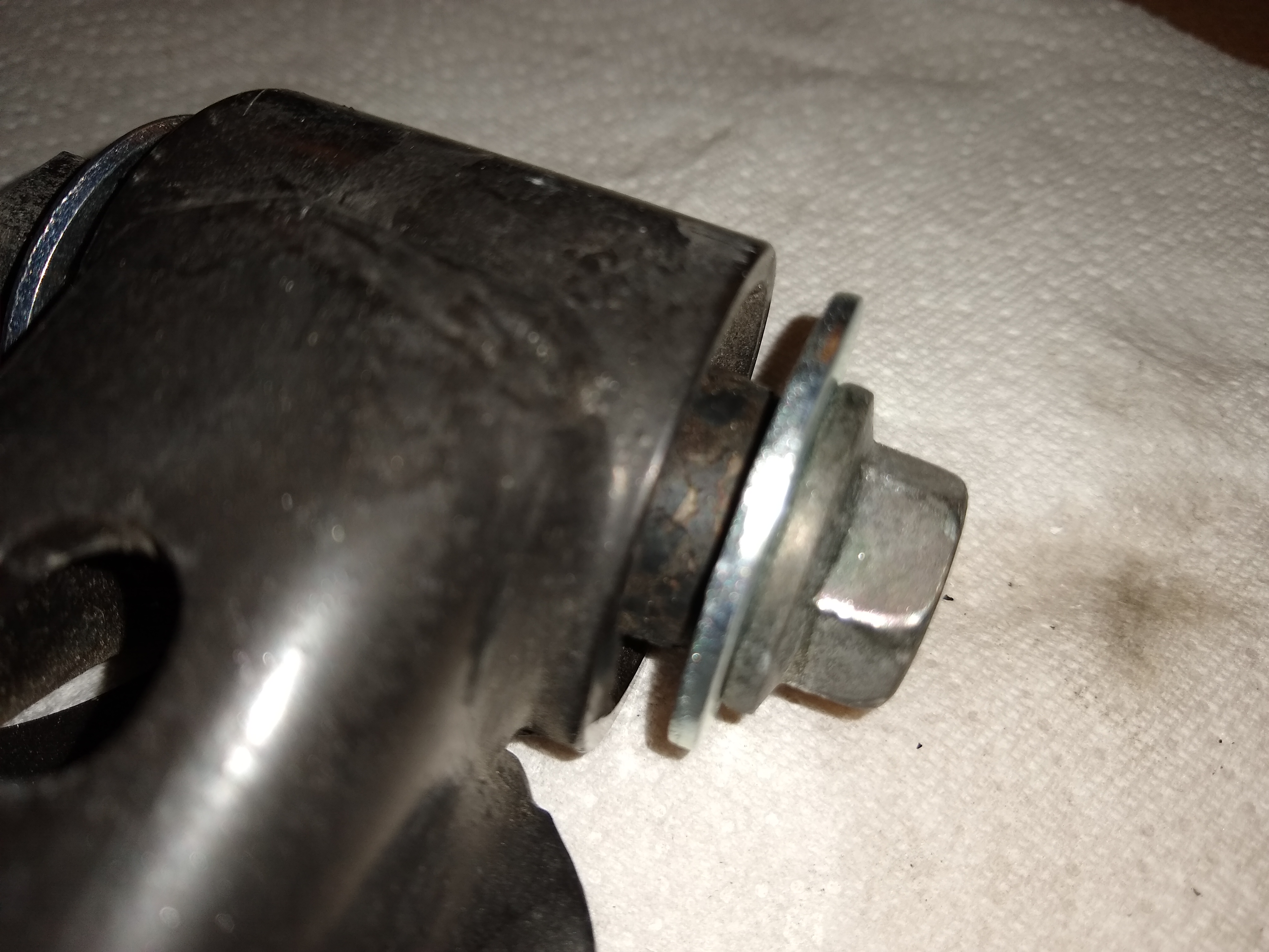

Strut Bar Mount I discovered I couldn't use the IPD Poly Inserts as one is solid on the bottom. Will try using the middle washer to tie it solid to the Strut Bar and hopefully the extra Poly will absorb some of the vibration. If not the center washer will be remove to allow a little more flex. Regardless both will receive the Poly treatment including what little I could put on to the top of the mount.
Strut Bar Mount Lastly, the strut bar mount. This is a solid mount but if you hit it with a dead blow hammer you'll see it shift some what easy from side to side so Poly will be added and smooth out with the finger around the bar and washer.
I will apply a thin coat of dielectric grease on the the PVC cap and washers in hope it can be removed easier after everything cures. Read somewhere that Volvo should have used a slightly larger bolt or have smaller holes so the bolts don't bounce around. During installation the bolts will be coated with Poly to fill the gaps and provide some vibration and dampening properties. Let me know what you think whether good, bad or improvements. Thanks.

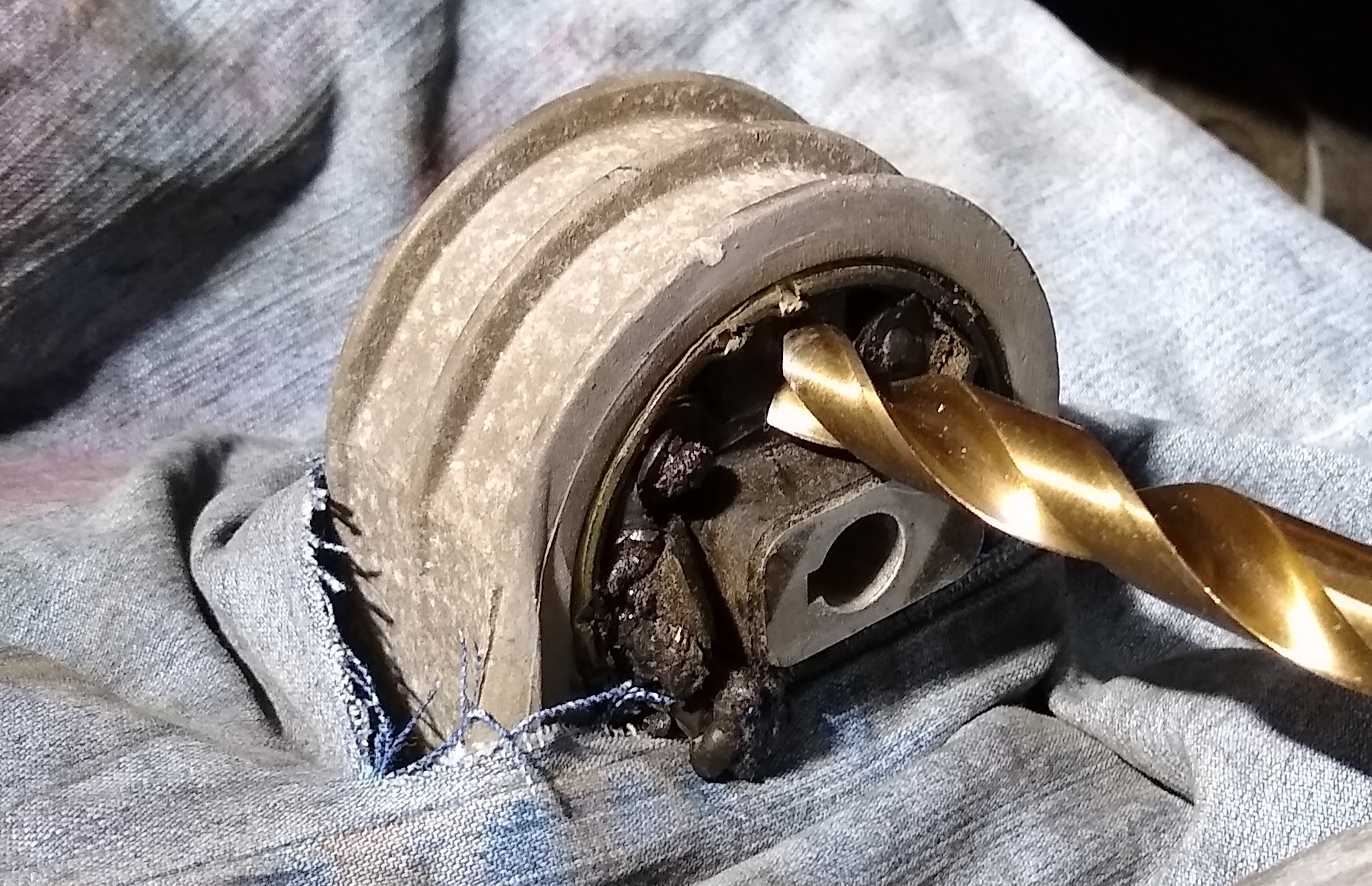

.MoVolvos wrote: 15 Jun 2019, 01:29Thanks. I will Guinea Pig the torque mount and sub-frame bushings shortly.
Long Term Use: Oozed over time as the roofing material never cured. Can work if one can find the appropriate goop, use metal, plastic rods or even fat glue gun sticks, much like filling the sub frame with bushings.
