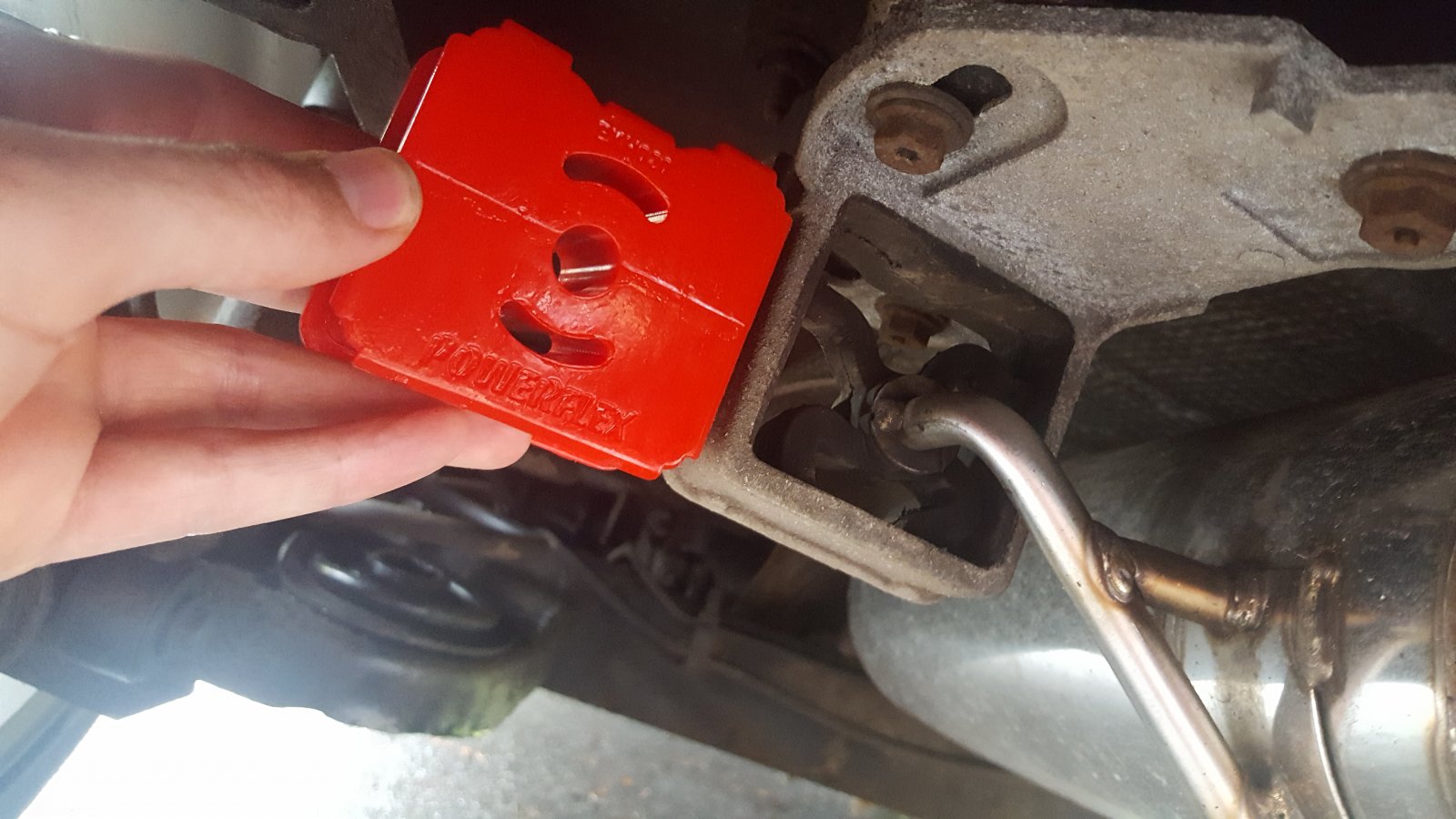

I just remembered that this is a tried & tested mod in Renault Clio land (I owned a Clio RS Phase 1 in the past). The last exhaust mount is such a bad design that is breaks within very short time.
Powerflex made a bushing for this shortcoming

ndphotonl wrote:
Mon Apr 13, 2020 4:29 am
So there is nothing new under the sun. Heat doesn't help on such a small amount of rubber. So you do have small Asian hands :).

Post by ndphotonl » Mon Apr 13, 2020 1:58 pm
They arent my hands on the pictures haha
