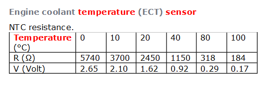

Kerpre wrote: 26 May 2019, 20:57 My thought exactly, have a new temp sensor on its way, attacking the cheaper stuff first. Thanks you
That can actually be tested with a multimeter so you don't just start throwing money at the car randomly...
That said, if it is over 10 years old then I'd just replace it.
RickHaleParker
Posts: 7195
Joined: 25 May 2015, 14:30
Location: Kansas
Has thanked: 8 times
Been thanked: 977 times
Post by RickHaleParker »
wizechatmgr wrote: 26 May 2019, 22:53 That can actually be tested with a multimeter so you don't just start throwing money at the car randomly...
R ~ 5321.65903 + (-144.171747 T) + (0.95432339 T²)
Example T = 10°C:
R ~ 5321.65903 + (-144.171747 10) + (0.95432339 10²)
R ~ 5321.65903 + (-1441.71747) + (0.95432339 * 100)
R ~ 5321.65903 + (-1441.71747) + (95.432339)
R ~ 3975.373899
~ 7.5% error from the chart.

Ok so I got 3k ohms at 16 Celsius
Car started so letting it idle to operating temp and will test again
Kerpre
Posts: 47

Post by Kerpre »
At operating temperature (needle won’t go any higher)
I get 0.5k ohm
I also get 0.5v on one pin and 5v on he other
