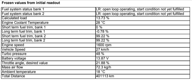

VIDA had the following freeze frame data stored:

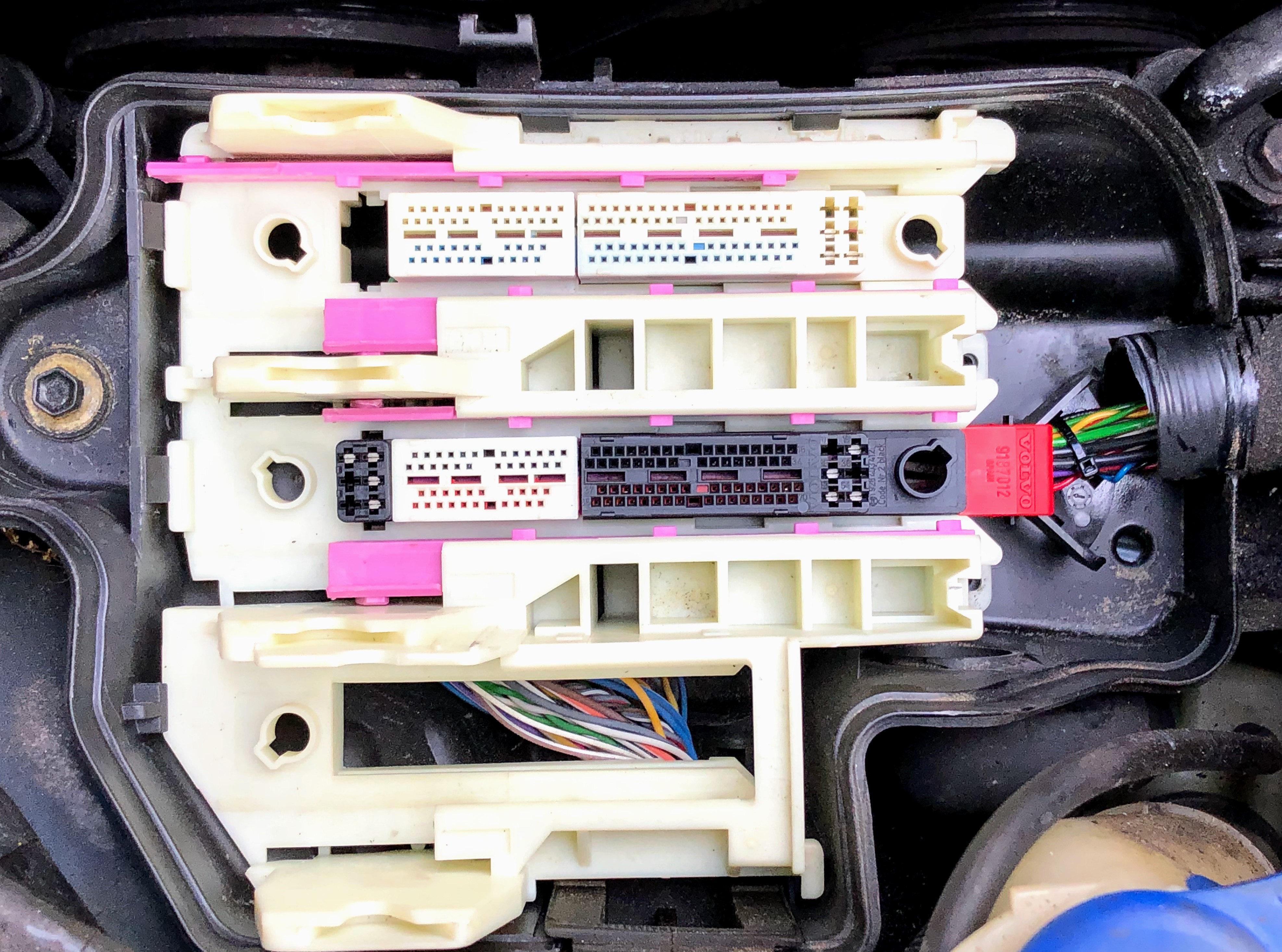

- Ran fault trace procedure for ECM-3320/ECM-3340:
This showed 0 resistance for both ignition coil connectors in question.

When you pulled ECU to check the continuity, did all the connections look fresh with no corrosion?

Yes, everything looked pristine, in fact. I gave both the male and female sides of the interface a shot with QD electric cleaner and dried with compressed air just for good measure, though.abscate wrote: 29 May 2019, 08:00 When you pulled ECU to check the continuity, did all the connections look fresh with no corrosion?

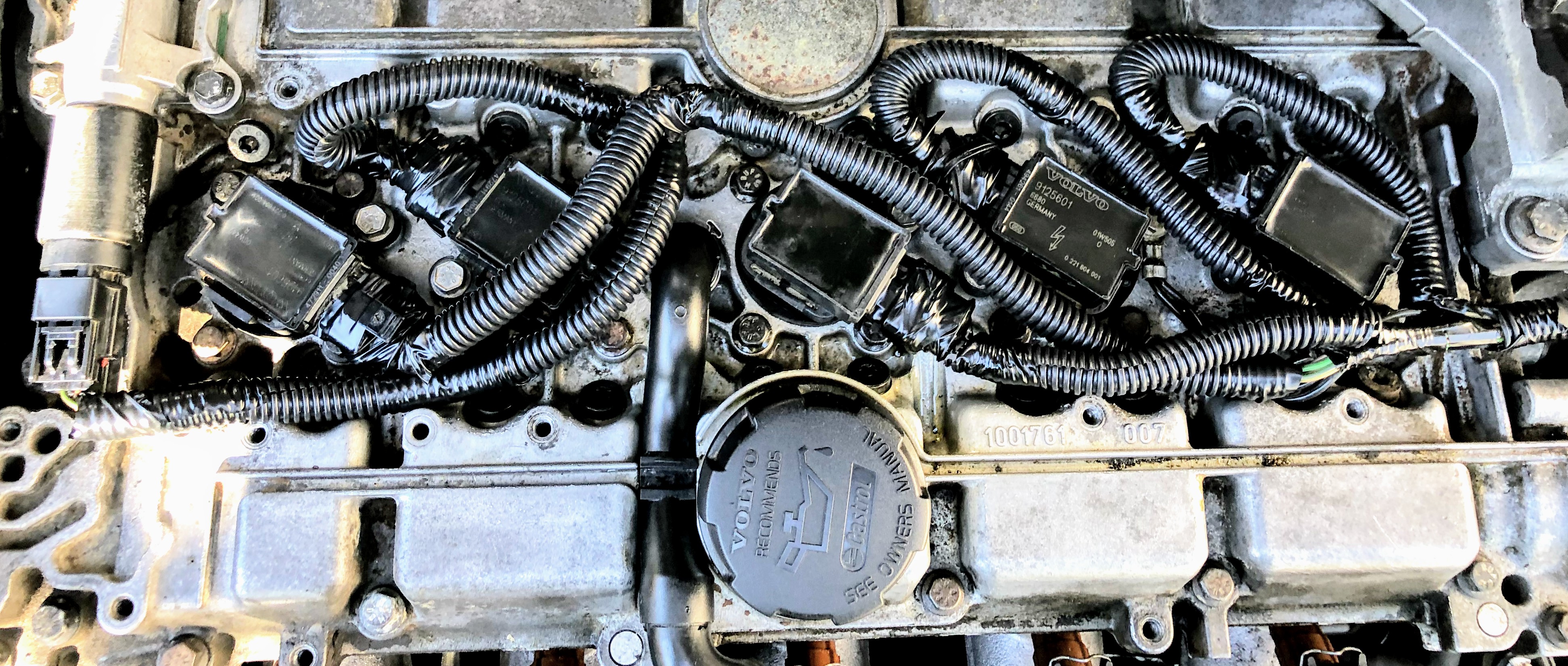

Here's a recent photo of the ignition coils... BTW for those keeping score, I did in fact redo the wire looms recently (when I was replacing the spark plugs).

errr.. those are pretty old. That Number 1 is 19 years old.
I think it might be time.
Definitely move them, one at a time, and see if problem moves.

Whoah, how can you tell? I can barely make out any of the markings?abscate wrote: 29 May 2019, 08:50 errr.. those are pretty old. That Number 1 is 19 years old.

00W44 date code on Coil one Year 2000 Week 44

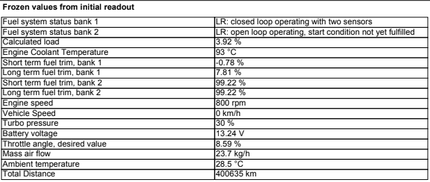

Here are the freeze frames from the latest instance:
ECM-3320:
ECM-3340:
Given that the codes indicate failure on the same ignition coil even after swapping said ignition coils, it seems logical that the fault is not in the coils but in the wiring leading to the coils. Since I tested 0 resistance between the ECM terminals and the ignition coil connectors, is it possible that there is still a fault in the wiring, but one that occurs under conditions that the ohmmeter cannot duplicate?
