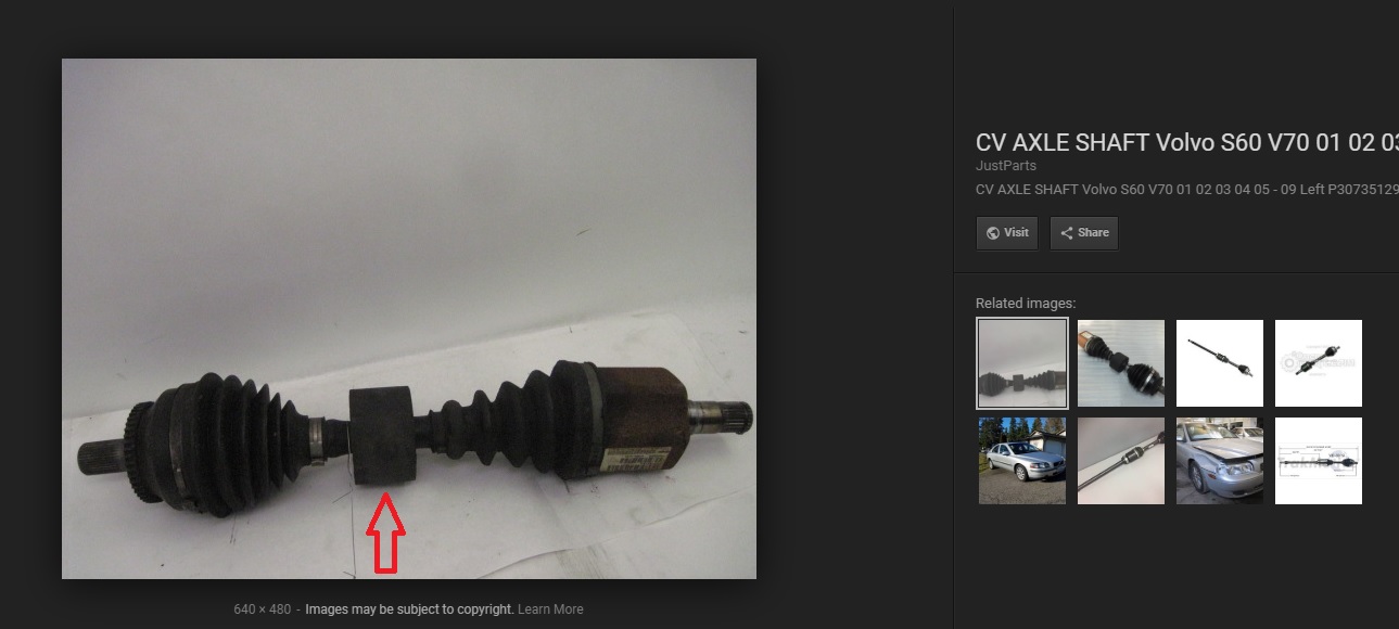

The problem is: the Big Round Rubber Cushion: how do you remove this thingy?

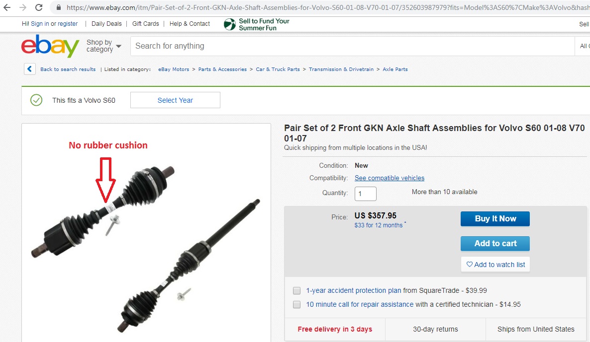

Looking at GKN replacement axle sold by eeuroparts etc., the Big Round Rubber Cushion is not even fitted any longer.
Does this part do anything important? Can I simply get rid of it?

This is what I mean by brand-new GKN Axles, the rubber cushion is probably a "useless part", I don't see it fitted in brand-new replacement axles...

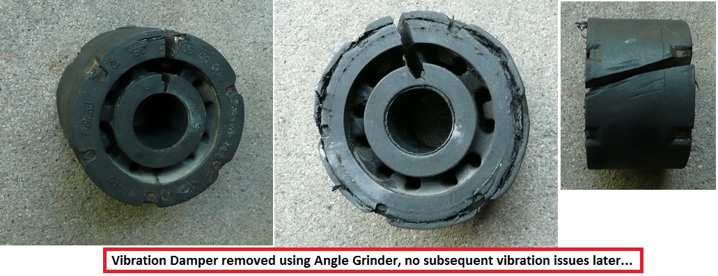

I tried your technique of rubber mallet but it was so tight and did not come off. I got the Vibration Damper off using an Angle Grinder.
No need for the Vibration Damper. Car runs fine at highway speed. This is over-engineering.
FYI, grease is a combo of soap + oil. Over time, the soap portion wears off, leaving the oil alone.
New boots and grease solved axle ping issue, which is due to axle going back and forth along the axle axis. With liquid oil (not grease), the axle makes noise when you reverse direction such as R to D.

I don't know how one can remove this rubber cushion using Volvo procedure as posted above. It is so tightly bonded to the axle shaft!!!
Since I had the OUTER CV out using the CV Removal Tool, and since I did NOT want to grind off the little dimples that hold the INNER CV Joint in place, I removed the Big Round Rubber Cushion using an Angle Grinder.
This way I can slide the new INNER CV Boot to replace it.
The Big Round Rubber Cushio is just a combo of steel and rubber vulcanized together, probably a useless piece of rubber.
You can live without this thing, car runs fine, absolutely no vibration whatsoever.
