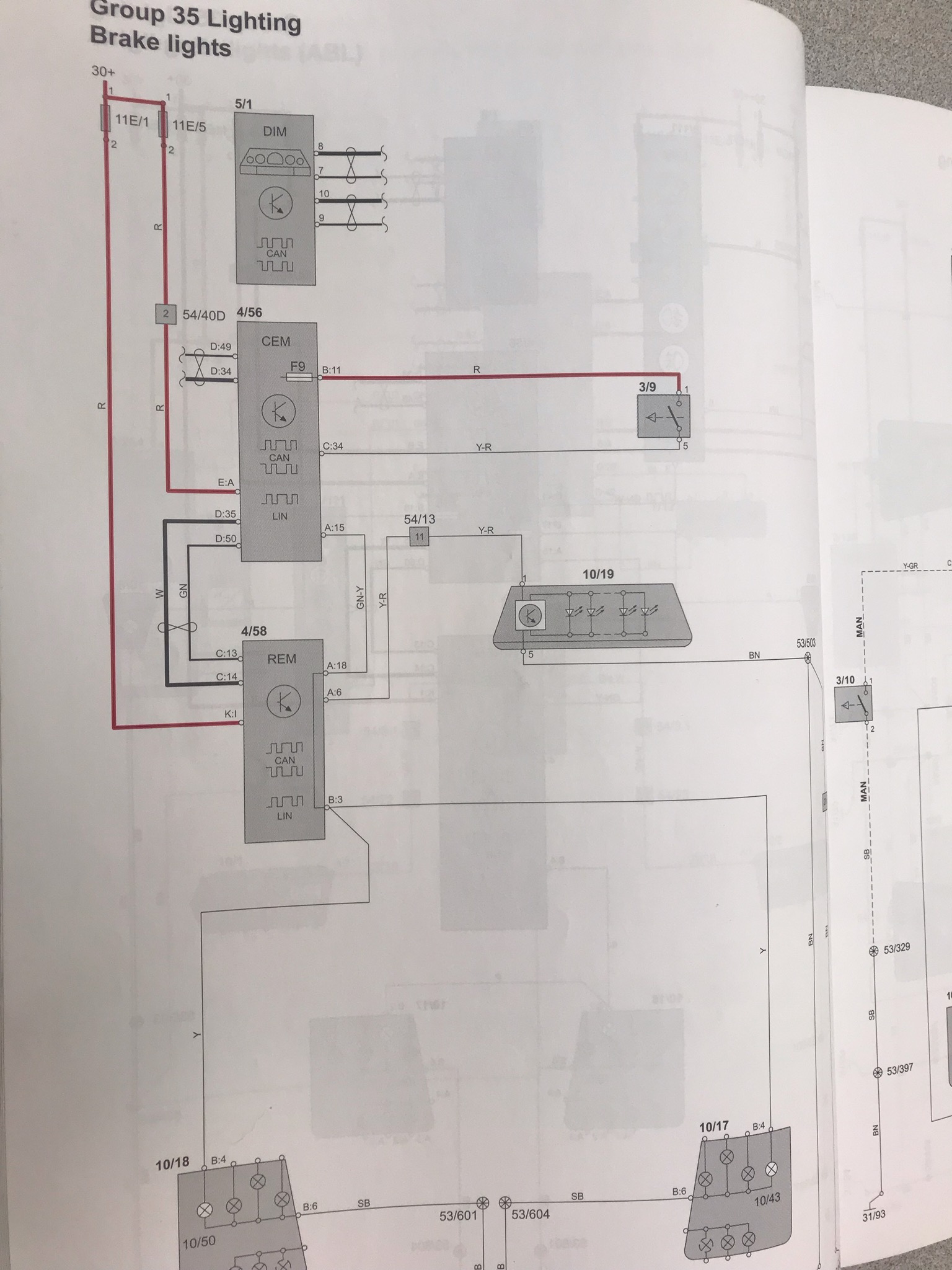

What else can I check? I have the wiring diagram attached.
Thank you very much in advance for any inputs.

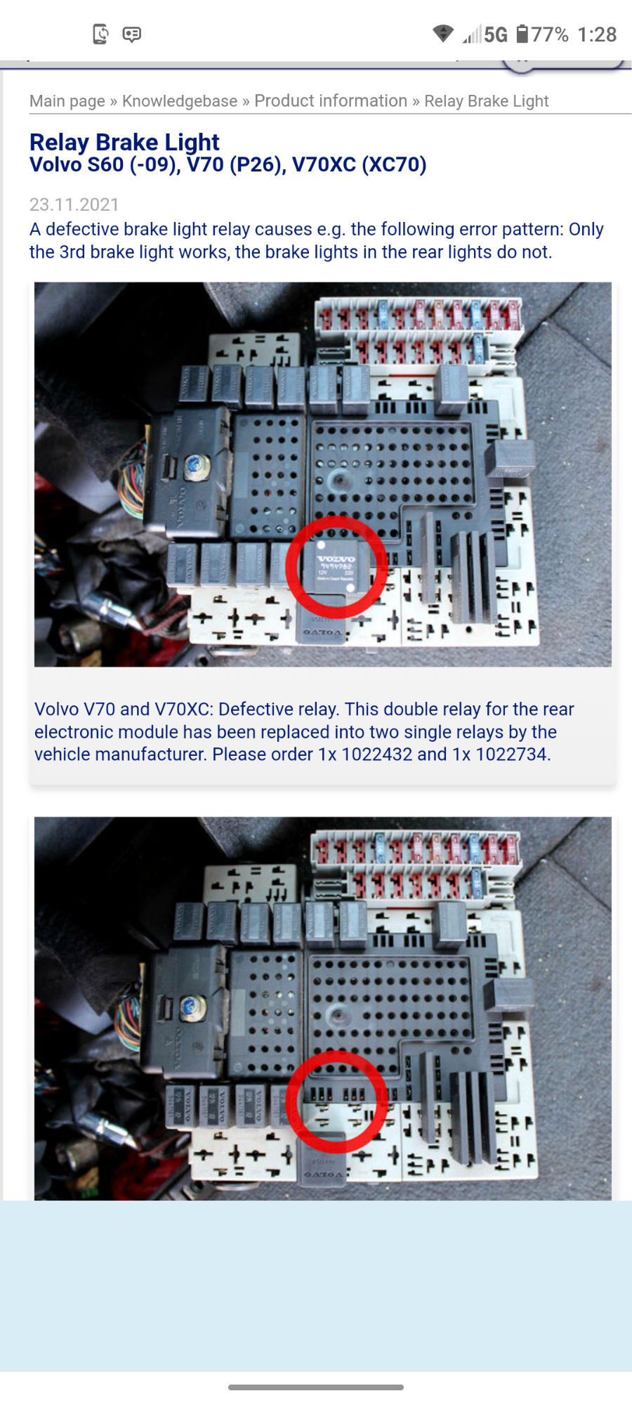

My kids 02 S60 had same issue and it was the relay for the brakes located on the panel in the trunk.

Post by cn90 »
This is from Skandix seller website...
