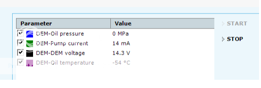

I got communication with the DEM today. Only working with VIDA for several months I'm still learning. :oops:
Could only communicate with the pump and not the sensor. Got 0MPa pressure and -54C temp reading from the pressure sensor.
At least I know the DEM isn't bad. I either have a faulty pressure sensor or bad connections with it.

I was able to communicate to the DEM but got default readings from the sensor. With default readings you predict the sensor is faulty? If there was no connection to the sensor chances are no values would appear.
Until I get it fixed I pulled the DEM 7.5A fuse so the pump doesn't get burnt from being on all the time.

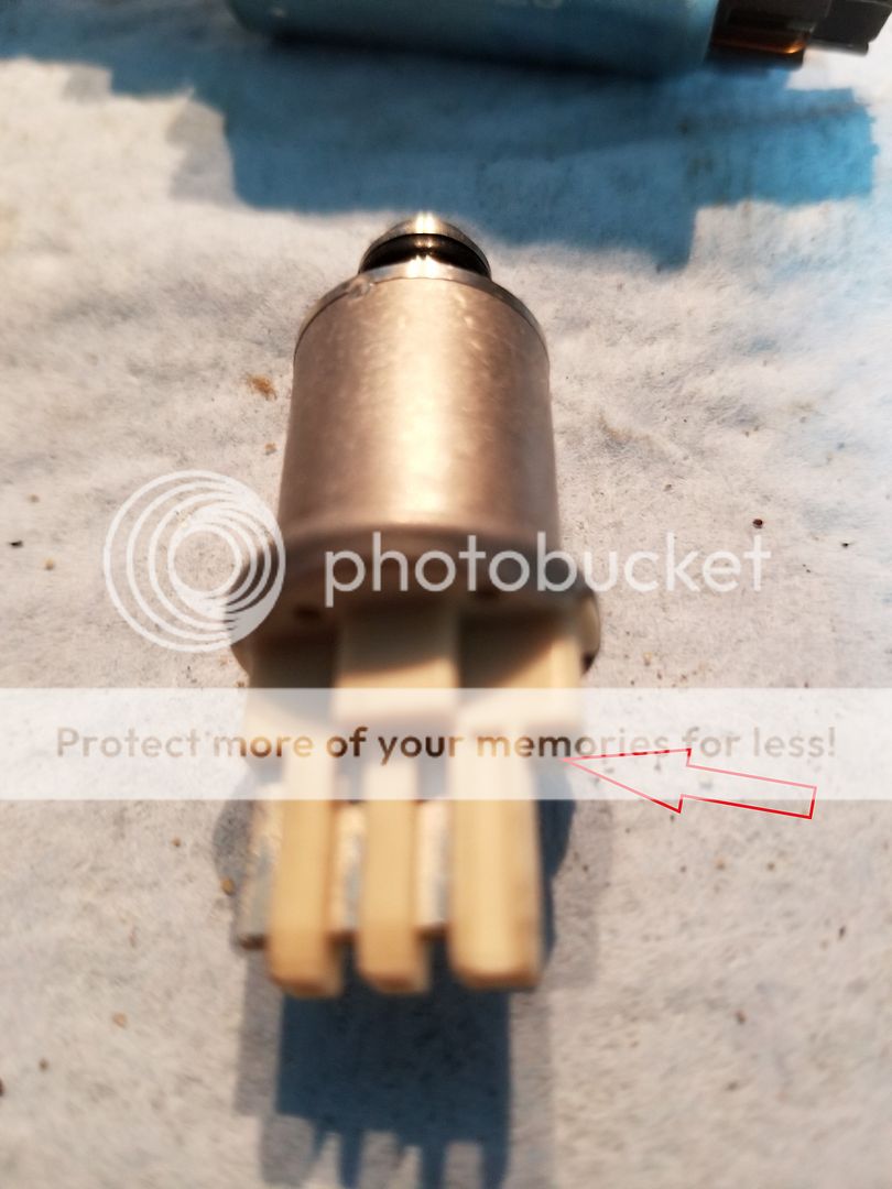

The outer pin on the sensor was broken off. I gave too much force when first installing it last week.
Couldn't find an 80 Bar sensor locally. I did get a 40 Bar sensor. It will read the temperature but not the pressure.

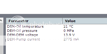

After installing a brand new 80 bar sensor and repair kit the DEM-0001 cleared but now I'm getting DEM-0007 (hydraulic pressure faulty value). The sensor reads both pressure and temperature. It reads 20C on a cold start then climbs up to 33C after a 15 minute drive.
For some reason the sensor isn't getting any pressure reading. It only reads 0Mpa. The Haldex fluid is full. I tried testing the pump with a 9V battery but got no response. Does it need 12V to turn on? The pump current is reading 2.5 to 7amps. Does that verify the pump is being activated?
The solenoid valve current never varies. Is the solenoid always fed just 6mA? I tested it with a 9V battery and the valve opened.
