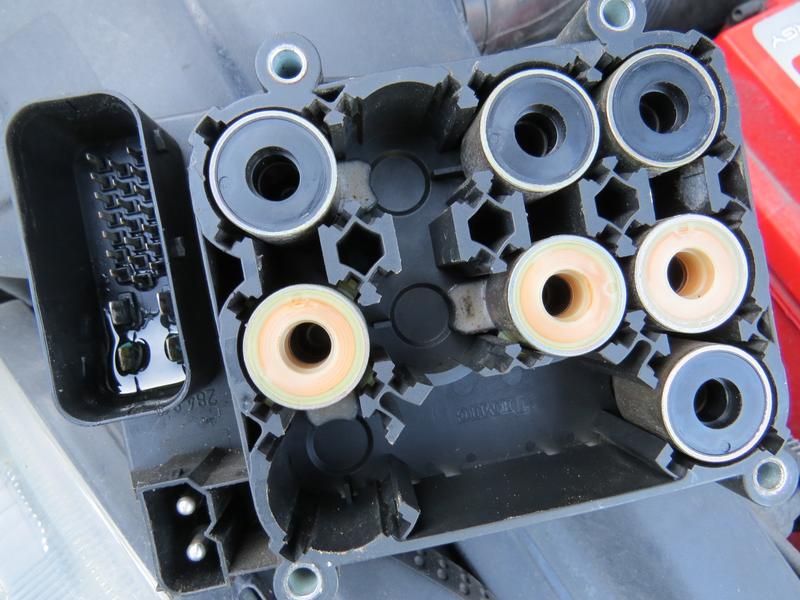

Hi everyone, I come here as my Volvo have a strange problem. About a year ago the ABS light came on so I took the module out and noticed that there was brake fluid inside the big, sealed connector. No idea where from so I cleaned it, I did the re soldering the logic board, resealed it and it fixed the problem for about 2-3 weeks until the dash light came on again.
I thought I did a poor job and had to do it again. So about 2 months ago I removed it for the second time and the plug inside was again full of brake fluid. No leaks abound it, no leaks from ABS pump just inside the big connector. Cleaned it but it didnt work.
Now got the module out again, same fluid inside the plug, very little inside the module around the plug areal like a drop or two. All around the brake pump is dry, not a drop or sweat, dry like a desert. Im going to work on the logic board again to see if there's any more faults but my question is where is this brake fluid coming from?

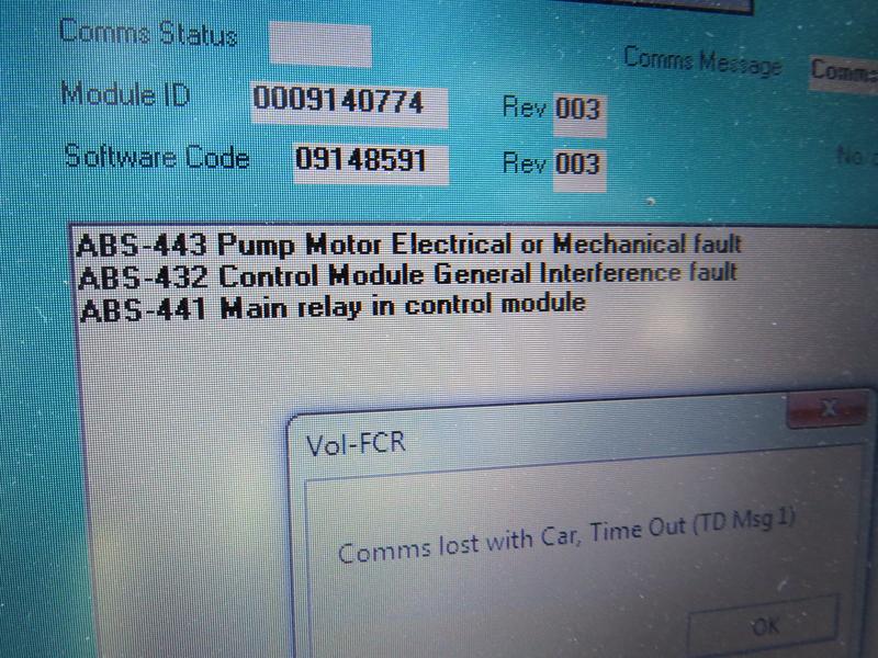

List of errors and picture where the fluid is collecting:

gikxer
Posts: 2
Joined: Wed Jun 19, 2019 1:11 pm
Year and Model: 850 1996
Location: Poland
Has thanked: 0
Been thanked: 0
Poland
gikxer
Re: ABS module wet
Post by gikxer » Thu Jun 20, 2019 4:03 pm
Last year, before the light came on the car was sent to have the clutch replaced. They did a poor job, like missing screws holding the gearbox.. So I thought that they spill some fluid on the module or something but it is not the case as it keeps happening and the reservoir or master cylinder is clean and dry. I kinda suspect the abs pump leaking by the sticking pins but no leaks there, not a bit. And if they where leaking somehow why there is a fluid only in the plug area and not inside the module? Only a tiny amount inside where the plug is so I guess it must have gone through the pins.
Below a picture of the plug, nice and dry. My solution for now is that I've drilled a 1.5mm holes so that the fluid can get out and will see how it goes :)
