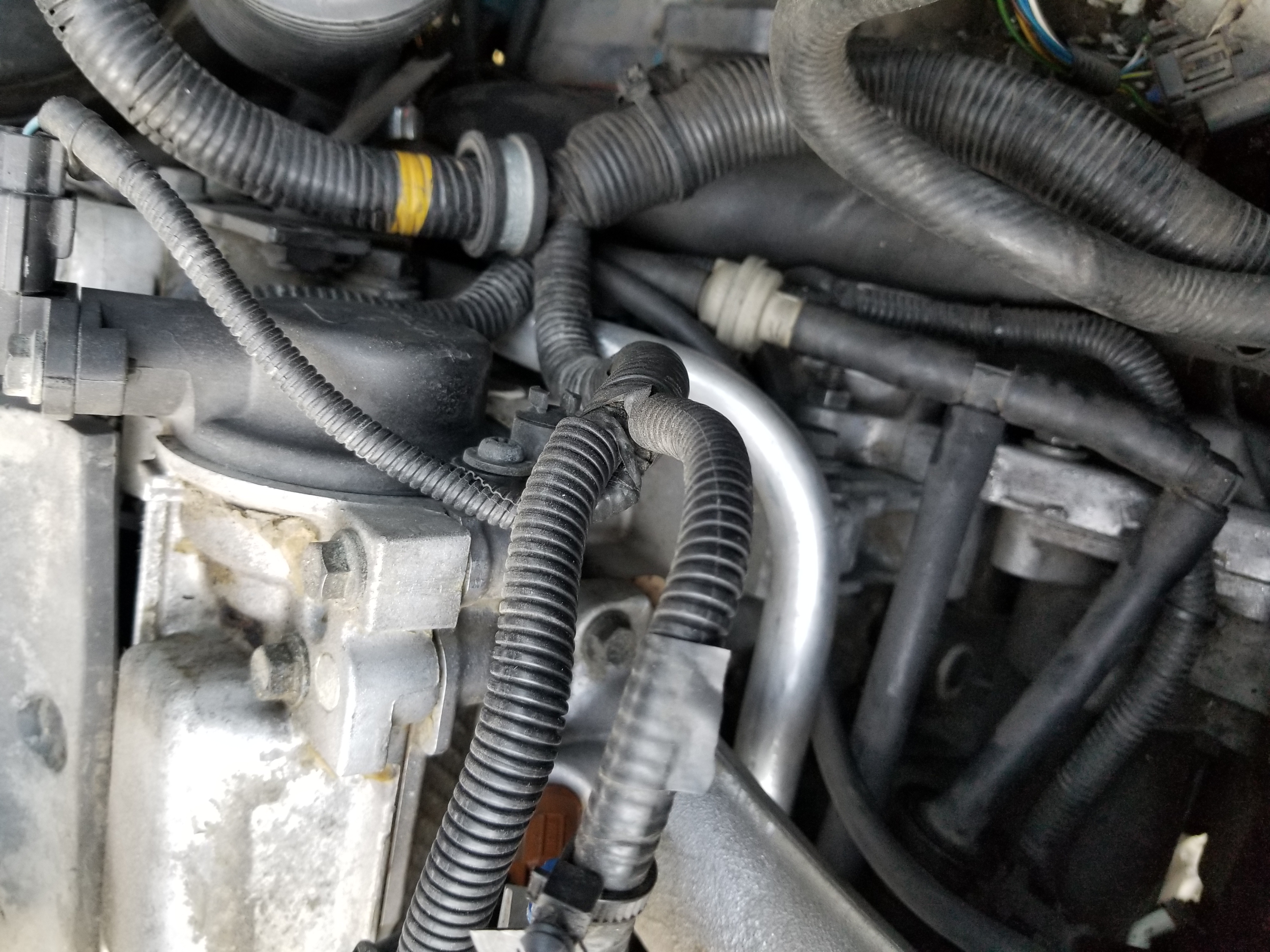

I need help in identifying these two items in my engine bay. One is obviously broken and the other is a were that is not connected. Pictures attached. Thanks!

#4 is the brake booster switch.

If I recall correctly the top picture is of a harness holder which keeps the MAF connector anchored to the Airbox. You can fashion a zip tie to hold it or just install it as is.

I will look at it tomorrow in the light but I dont think the airbox has the MAF attached.

Looking at picture 3 - I see the MAF attached to the airbox, but the connector is installed so it is not the MAF plug.
Is this the 2.5T engine?

Fuel pressure sensor connector but the fuel rail does not have the provision for a FPS. That fuel rail has the fuel pressure test port where the open end should be for insertion/attachment of FPS. Is your check light on? There should be a STC for open sircuit to the fuel pressure sensor, probably two DTCs as the temperature of fuel signal is also missing. The retainer clip on the harness lead would have been popped into the black plastic cover that is not present in the pictures.

Yes

That makes sense. Is there a good place where I can see a picture of what you are talking about?
