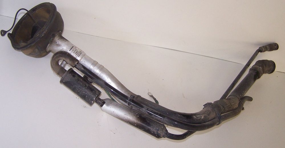

I found a description of the problem on an S80 that has a photo looking up from the ground towards the filler neck. I took a peek under my 2004 V70 bumper and found that it has the same arrangement.
http://www.fixya.com/cars/t2562789-2002 ... _shuts_off
Here are other photos of the filler neck with the vent tube

For everyone's information:
The fitting pointing downward (which the spider homesteaded) has a barb fitting.
It was onto that fitting I shoved a foot of old garden hose so I could blow into it.
I was able to locate the hiss of the escaping air.
It was my bad J-hose.
