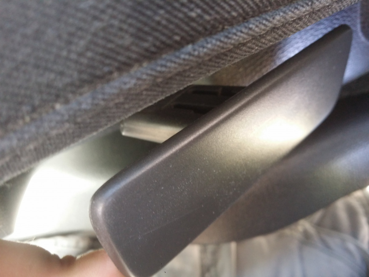

Now my car is a 2002 and they did change the seats I think for the 04 MY but maybe this helps. You have to remove the lever handle first. Pull it up to reveal a clip on the inner (seat cushion facing) side. Release the clip and remove the handle.
Lever and handle
Lever and handle

Thanks. Handle is different on 05. Tough to find any clips

Well, I half expected that. The clips are too obvious on the variant I have. Good luck finding the solution!
