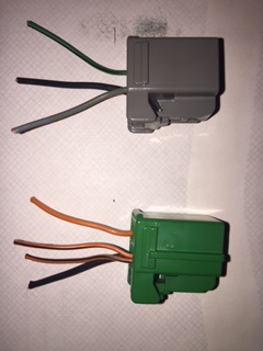

The next thing I did was located two new connectors that plug into the "bulb holder" a green one and a gray one( I spliced them in). This did not work either, the taillights came on briefly, then blinked off.
All other lights still work brake, back-up and blinker. Only the taillights on the passenger side do not come on. The drivers side works fine. It was suggested to me that a simple option or fix that would work....is to straight wire from the tail light (drivers side) a single wire from the harness to the passenger side to get power to the tail light, but make sure I clip the same wire on passenger side
Problem I have is how do I know which wire to splice from the driver side to the passenger side?
My suspicion is the gray connector is the the tail light and the black wire is the hot wire in that connector.
Does anyone know?
The green connector has 4 wires... a solid black, solid orange. 2 orange with black stripes.
The gray has 3 wires...green with black stripe(I presume the ground) a solid black and a bluish with red/orange stripe.
Does anyone know?
