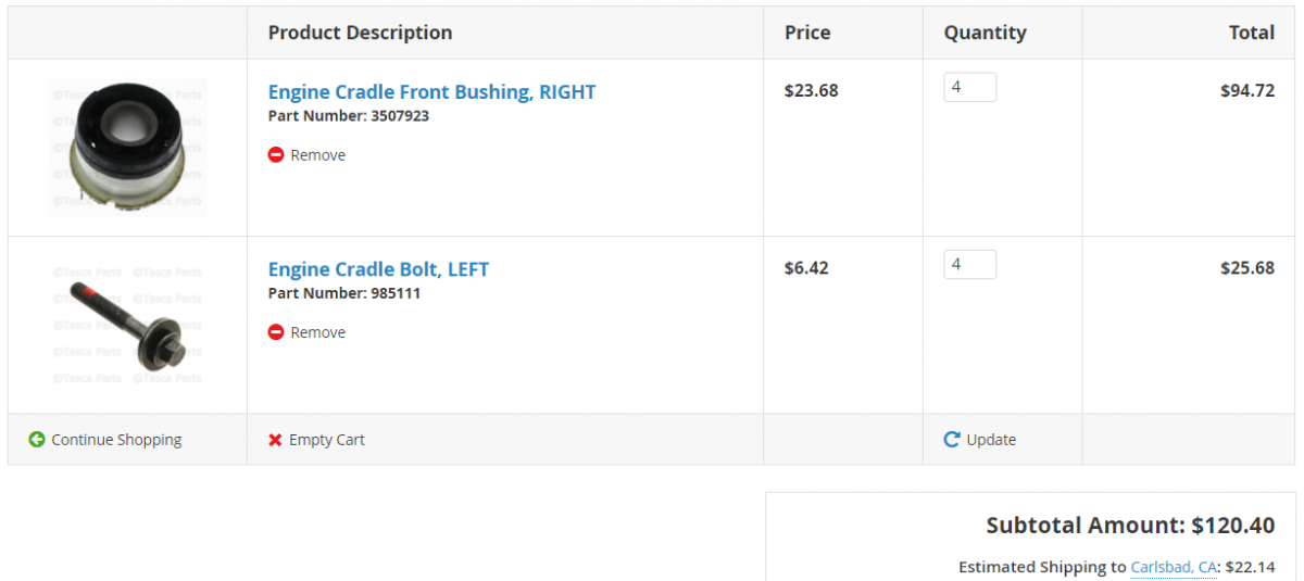

Hey all, just wanted to check I've got the right parts before I replace the front lower subframe on my 2006 S60 2.5T AWD. It has a big dent in it that has been bugging me so I'm going to get a "new" subframe from a junkyard, replace the bushings, and install it with new bolts. I might do the front and rear lower engine mounts while I'm at it too but I'm undecided. Car has about 100k so it might be time for those. Anyway if anyone who has done this or is smart on it could confirm I've got the right parts picked out, I'd appreciate it, just a little uneasy because some posts I read indicated one of the bushings/two of the bolts might be different, and I don't want to be stuck mid-install because I ordered the wrong stuff.
Anyway here's what I think I need as far as the bushings and bolts go:
4 of these bushings: https://www.tascaparts.com/auto-parts/2 ... nents-scat
4 of these bolts: https://www.tascaparts.com/oem-parts/vo ... NS1nYXM%3D
And if I decide to do the front and rear mounts (I'll leave the side for later since it's more accessible), two of these:
https://www.fcpeuro.com/products/volvo- ... 0-30778951
Thanks, all. Happy 4th!

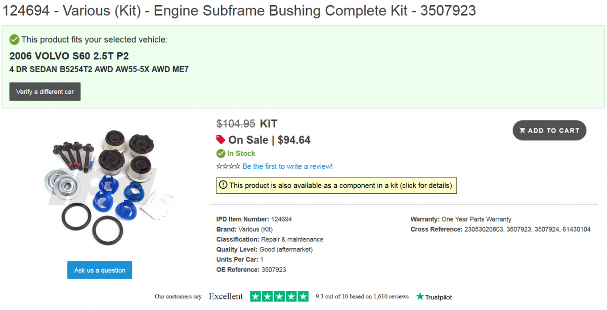

Looks like a 4th Sale from IPD?

OP should check his Tasca order. The bushings differ (see the kit). Not all 4 corners are the same.
Also, I believe the bolts are stretch bolts so they're single use. (of course I reused mine when I installed my poly inserts)

Gents, just wanted to say thanks for the info and replies. I'll follow up here:
MDK: I'm planning to replace the bushings because I just assume that they'll be bad or close to it on any subframe I'm getting from a junkyard - also there's apparently no better time to do it than when you have the subframe out (easier to remove the old bushings and press in the new ones, both of which appear to be not much fun to do while laying under a car). The bolts are supposed to be replaced any time you pull them per VIDA because of the stretch or something, and well, I'm just paranoid about contradicting VIDA. The inserts I might do later, I went and read some about them and they seem like a good compromise between the Delrin (added vibes at idle but better feel while driving) and the standard bushings (kind of mushy feeling). What is a strut tower brace converter, this thing? https://www.vivaperformance.com/strut-t ... e-s60-v70/
MoVolvos: Dude, thanks! When I first searched for the part numbers directly on IPD, nothing came up, but when I searched for that kit I found all the bushings, bolts, etc. I just ended up ordering the bolts and aftermarket bushings, and also the IPD sway bars (~$407 during the 4th sale, ends tonight!). Tasca ended up being out of stock so you totally bailed me out with that kit info, otherwise I would have had to venture down the more questionable eBay/amazon roads.
Georgeandkira: I ended up ordering 4x 3507923 bushings, which is what Tasca and IPD's sites recommended. IPD does sell another but it looks like that is a front bushing for an XC90. So maybe they are different front and back on the XC90 but same all round on the S60? Also the Delrin bushings I checked out appeared to be 4x identical pieces, so I'm hoping they're all the same, otherwise I'm going to be in for an unfortunate surprise and my Volvo is going to be stuck up on jacks for a bit (very uncool). If you're 100% sure, then please show me what I should have ordered, otherwise I'm going to be in a tight spot come Saturday afternoon.
