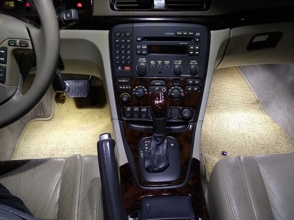

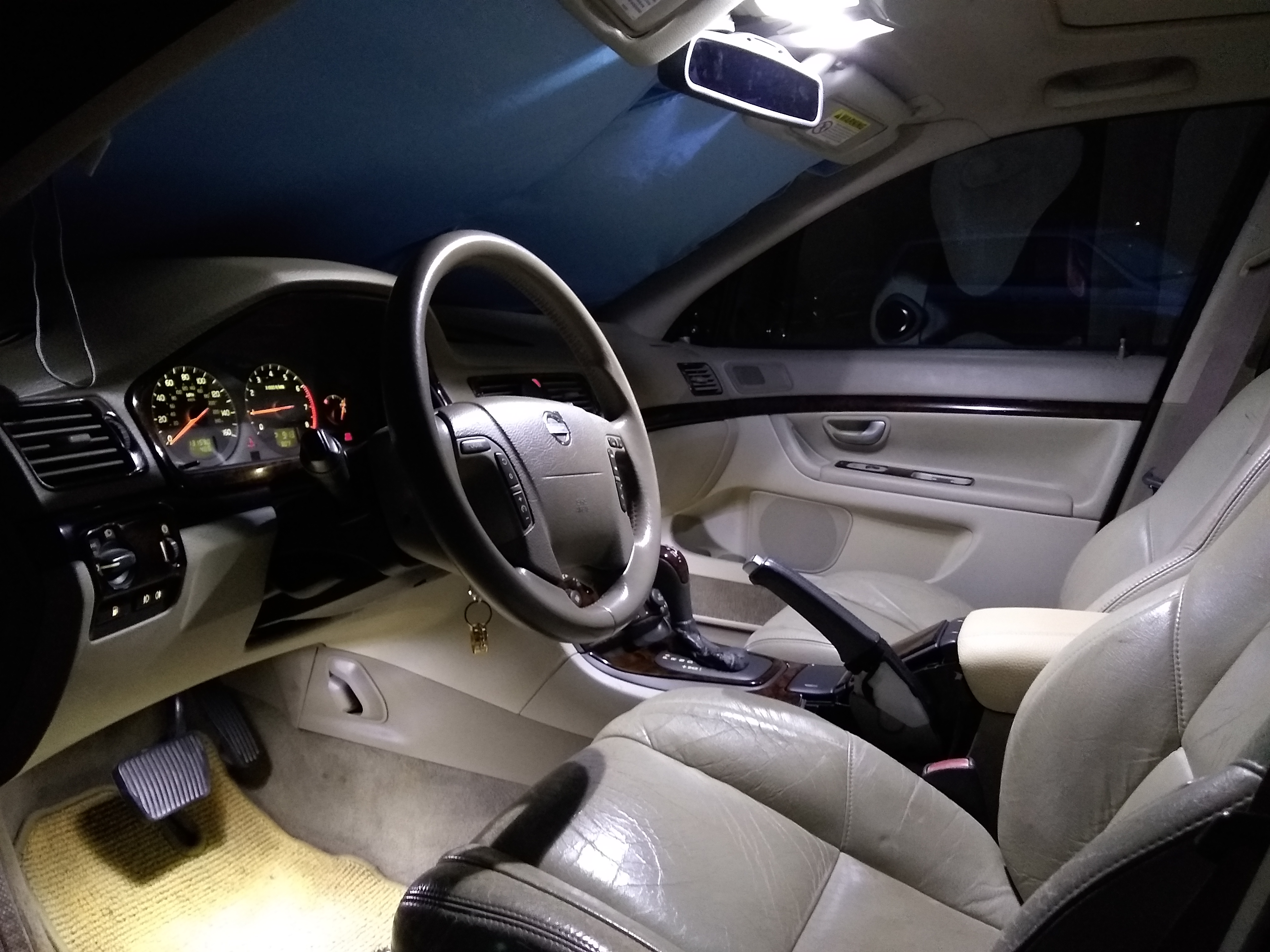

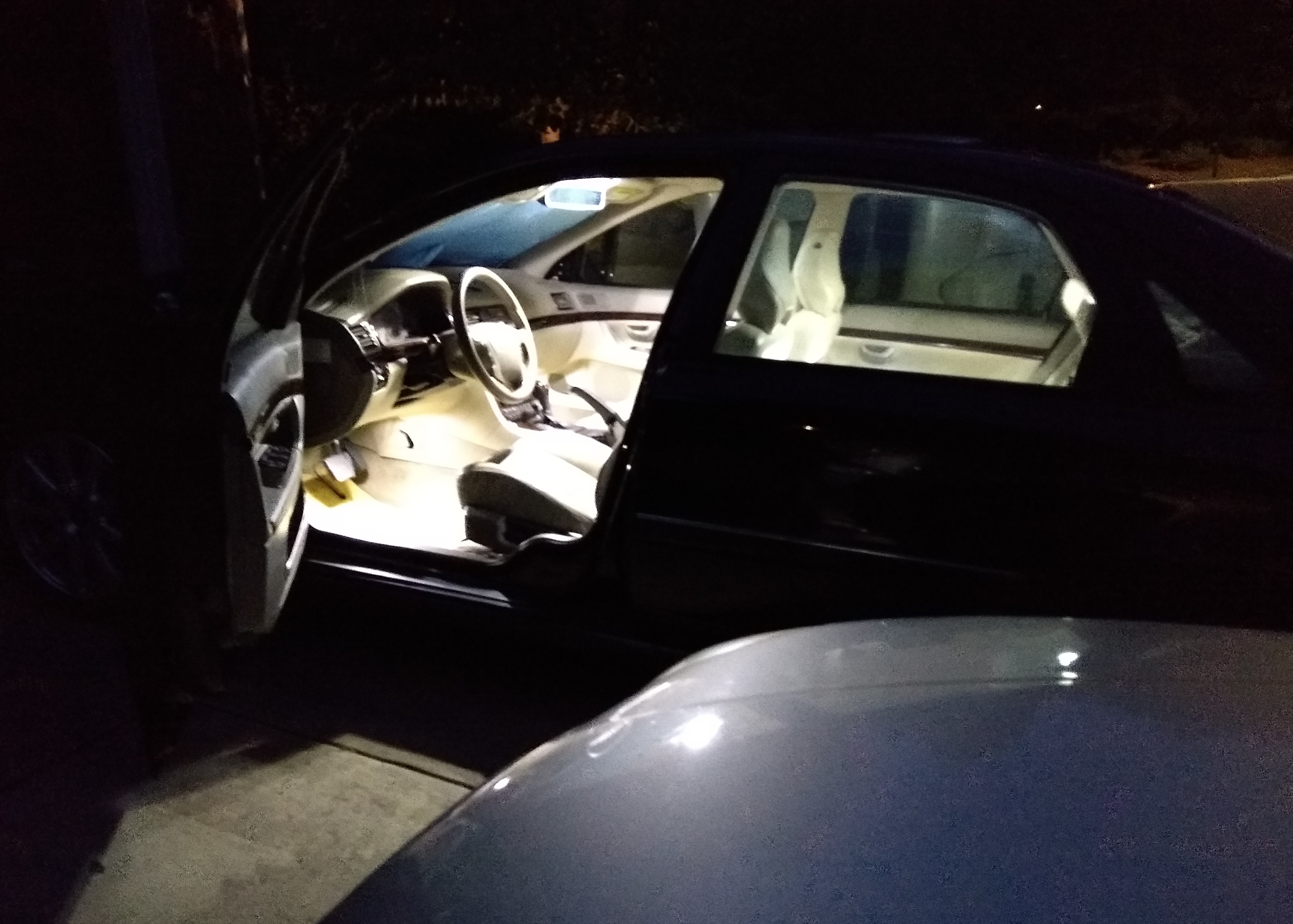

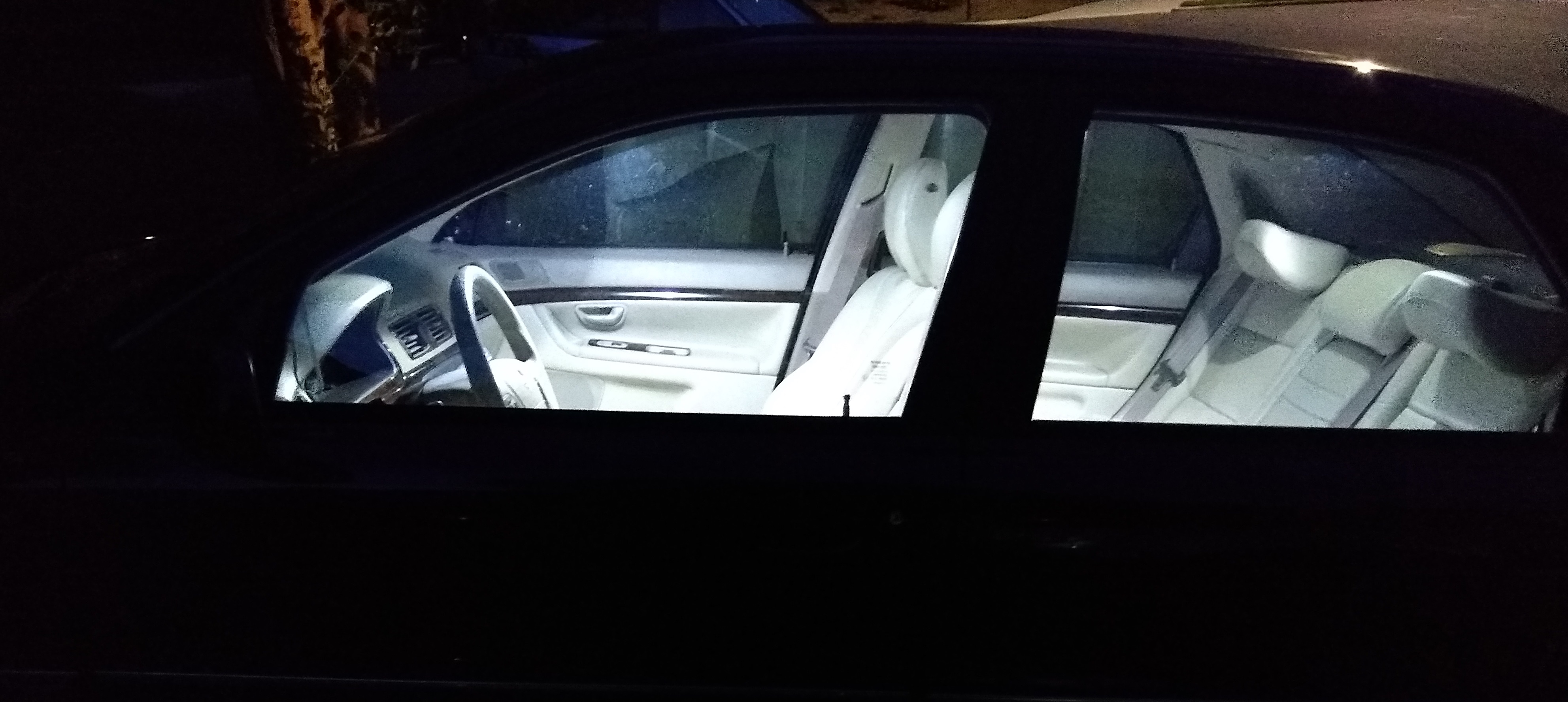

Just installed 8 LEDS in the interior of the 03 S80 T6. I've experimented with quite a few LEDS in the pass 5 years and the 4014 Chipset is suppose to be the newest. The 03 Odyssey has a full set installed a few years ago and it is quite an improvement for the vision. One purchaser said these might be too bright so I decided to give them a try. Son says it's like daylight.

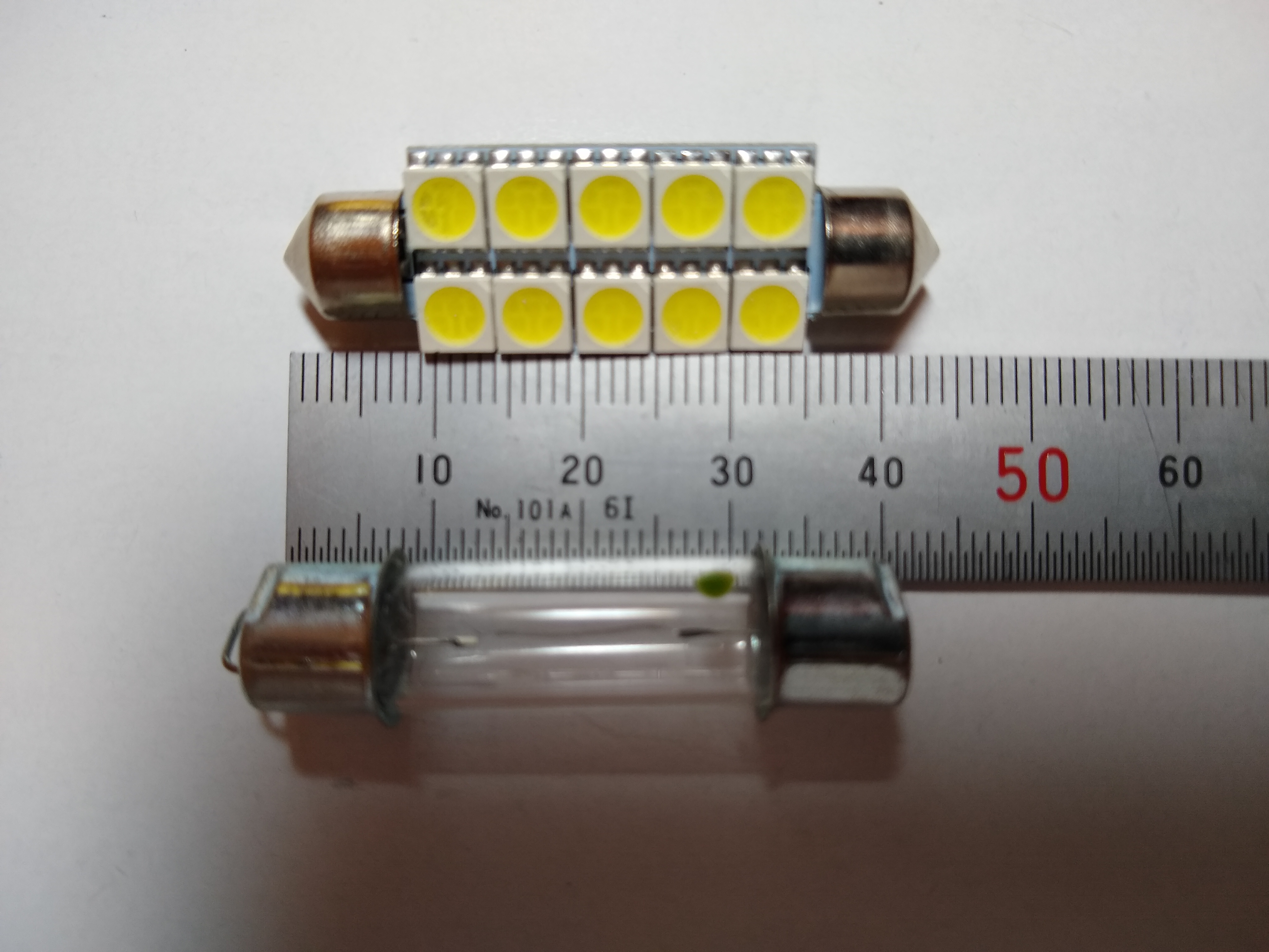

39mm Festoon LED Bulbs ,Viesyled Super Bright LED Interior Car Lights White 12-SMD 4014 Chipset Canbus No Error Car Interior Dome Map License Plate Dash Board Cargo Trunk Door Lights Pack of 20
Price: $15.99
https://www.amazon.com/gp/product/B07D7 ... UTF8&psc=1

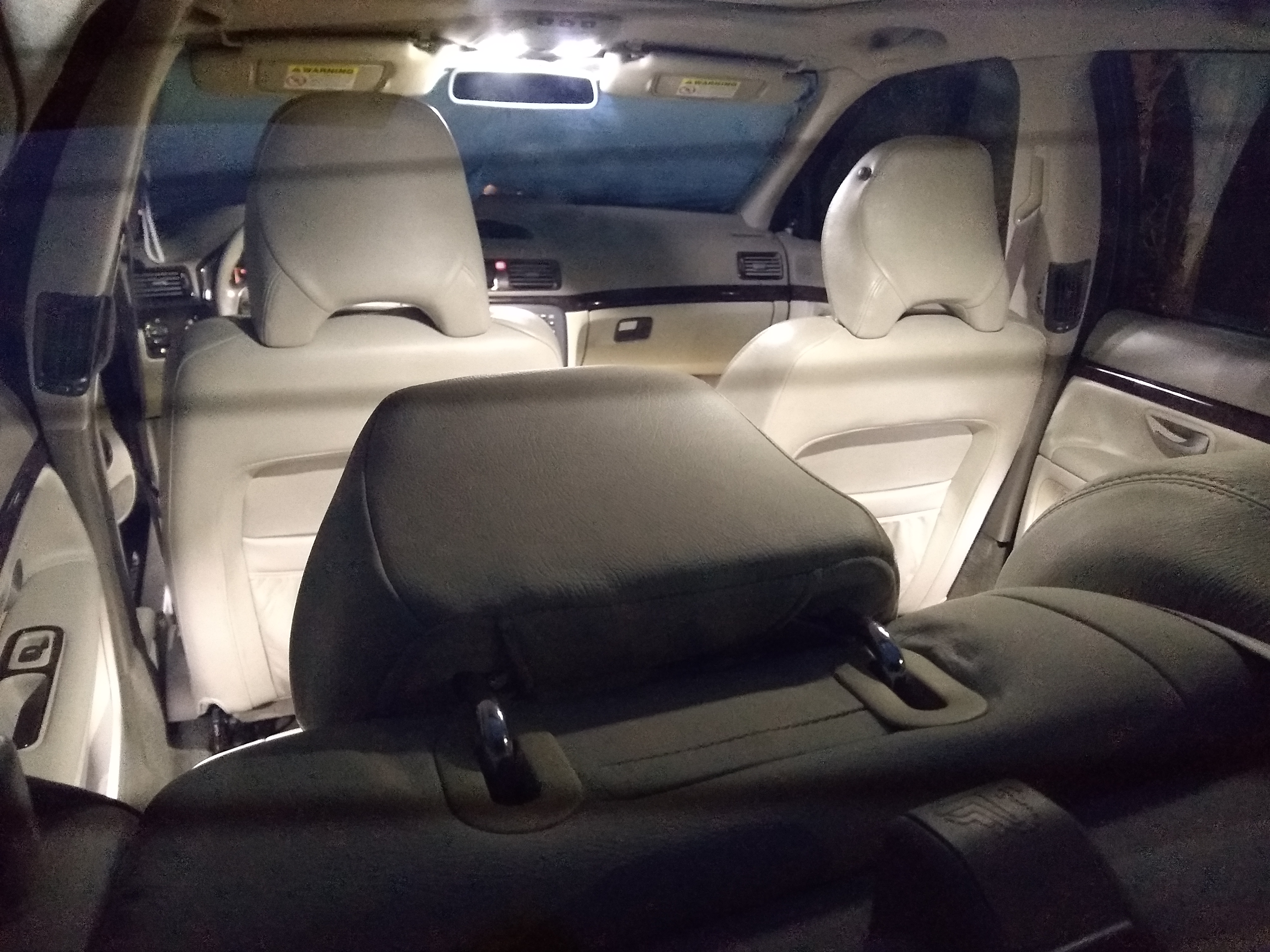

2 - Front Dome Reading
2 - Front Dome Courtesy
2 - Rear Dome Courtesy / Reading Combo Function
2 - Front Foot Well Lights
6 of the 8 originals are numbered 212-2.
The 2 original Foot Well lights in the front were slightly smaller so had to bend the tabs slightly wider to accommodate the larger Amazon bulbs. Purchased a set from eBay numbered 212-2 with 40mm to 44mm description and they were way too large. Waiting for a refund.

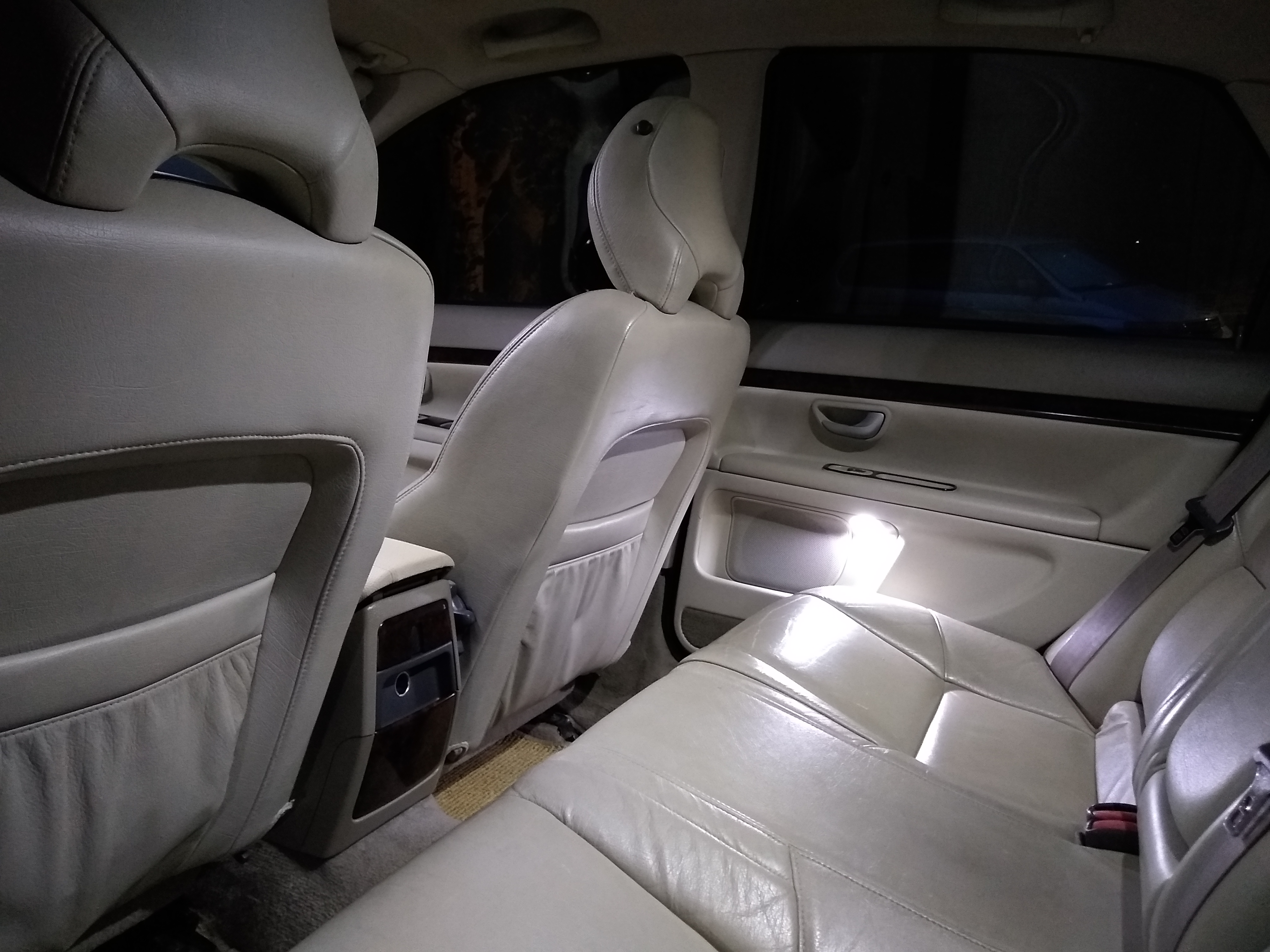

2 - Rear Door Courtesy Lights T10's were from eBay
10x AUXITO super bright Canbus 194 168 LED light Bulb xenon white 24-SMD 2825 DF
https://www.ebay.com/itm/10x-AUXITO-sup ... SwJcdc0pcm
