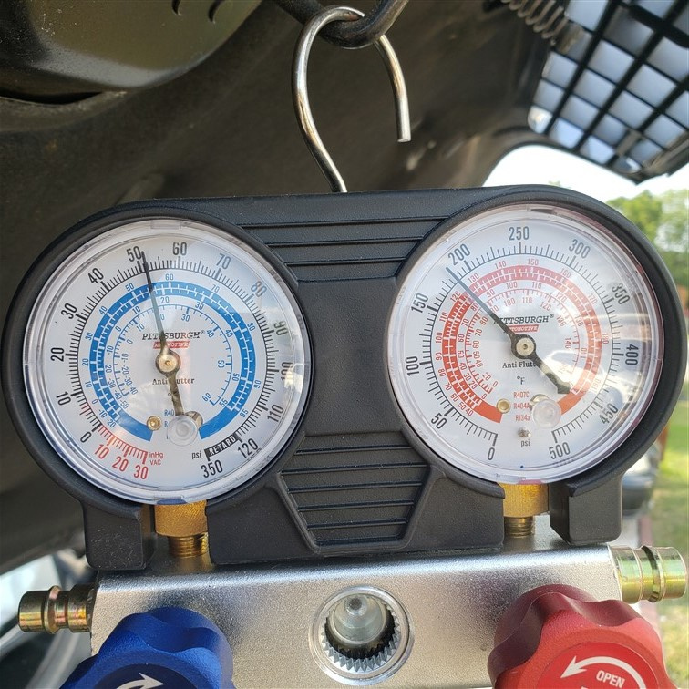

Hello all,
I checked the pressures yesterday evening and got the readings below.
@ Idle: LP: 51psi, HP: 185PSI, Vent Temp around 66F
@ 1500 RPM: LP: 44psi, HP: 215PSI, Vent Temp around 61F
The outside temperature was around 101F.
I also checked the fan. When I started the car with AC off the fan came on right away but at a slow speed. Turned on the AC and after about a minute or less fan started turning faster and always ran at that speed.
- ac2.jpg (254.79 KiB) Viewed 2041 times
- ac1.jpg (271.63 KiB) Viewed 2041 times
