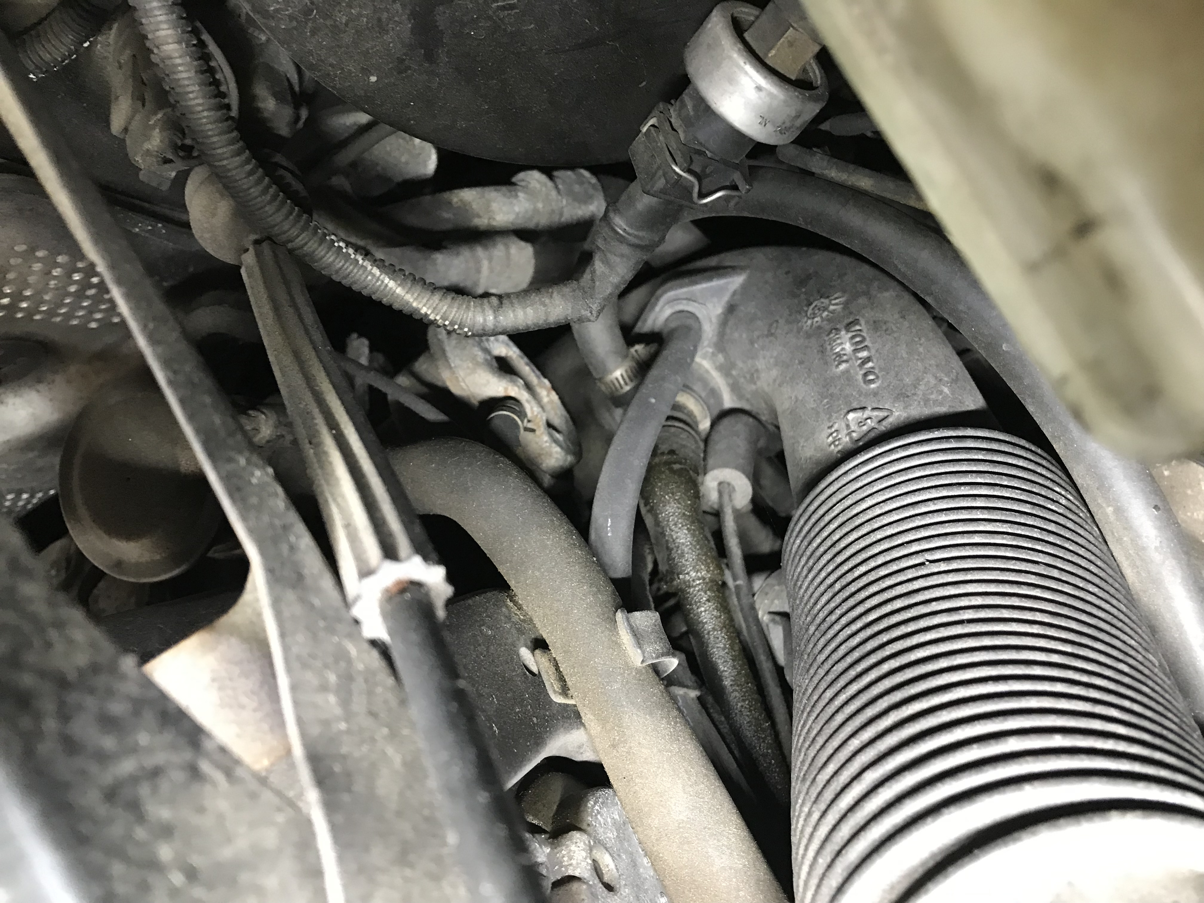

I took a video of the smoking dipstick, I will leave it slightly open.
I also noticed the hose connecting to the ptc valve is oily. I believe that hose is part of the pcv if I’m not mistaken. Does that hose rupture or seep due to pressure?
What do you guys think?
