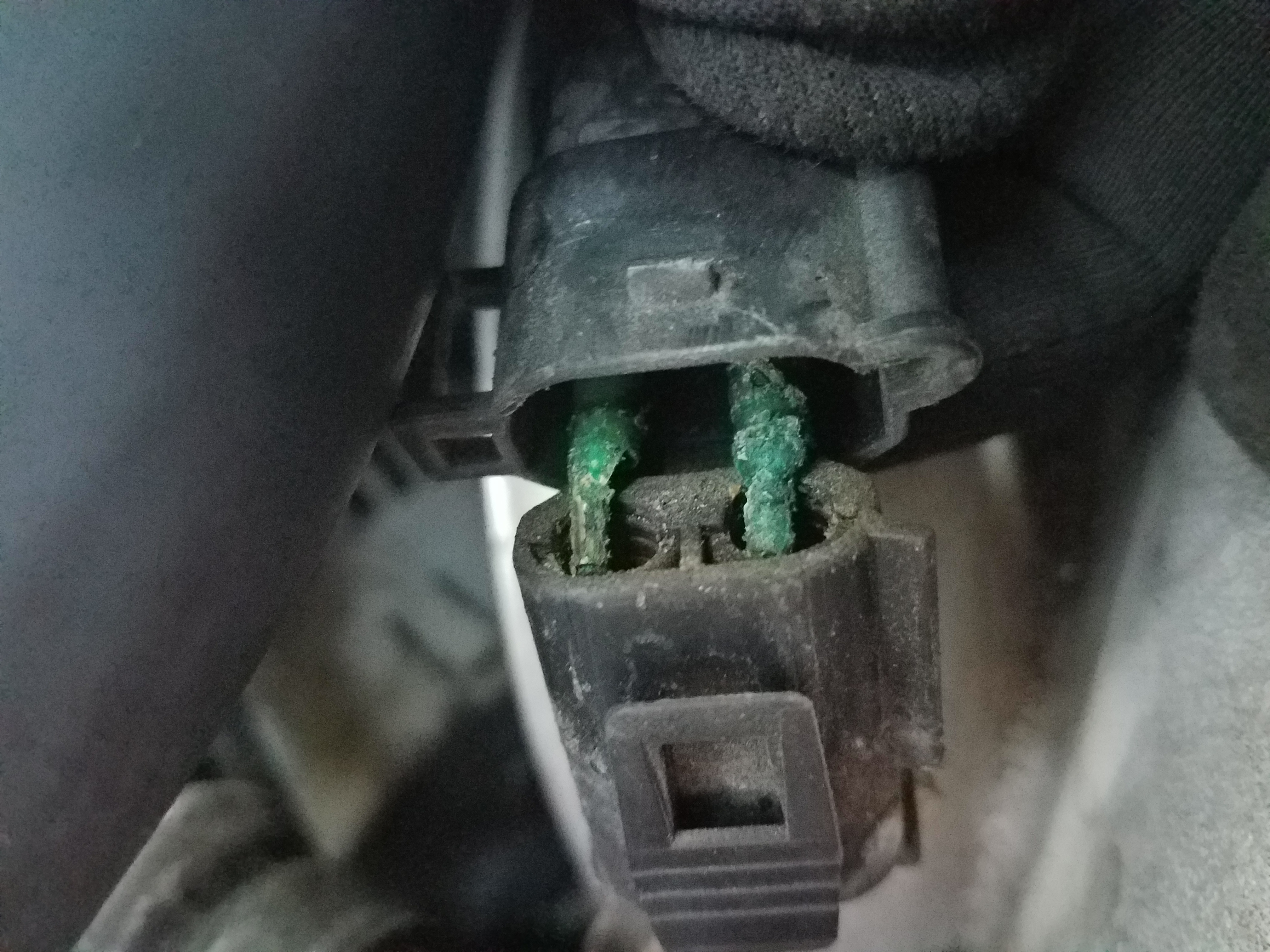

I inspected the ECT sensor wiring and found tons of green gunk and corrosion. I took it apart and clean everything inside and out until it was shiny. Still no change in fan functions. I did try unplugging the sensor while the car was running a and the fan came on immediately.
On my multimeter the sensor is reading infinite ohms. My parts car temp sensor was reading like 1800ohms so I think that gives me my answer. Will probably be ordering a new one.

Those ECT sensors can wreak havoc if they get corroded up. I fought with mine this past winter.
