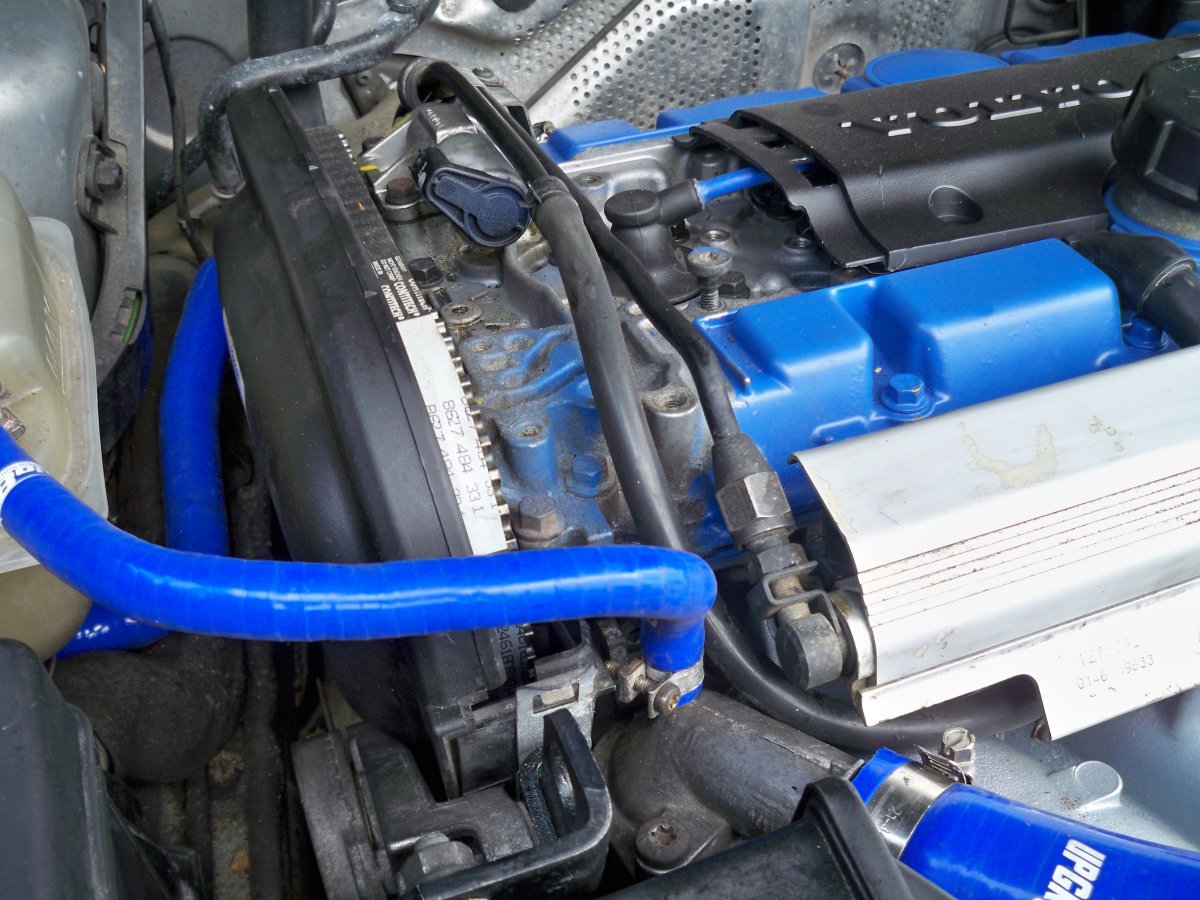

I forgot about replacing the seals (which I did). The matchmarking was done to get things back together properly.
You can just see my yellow mark on the VVT solenoid in this pic. There were 2 corresponding marks on the back of the pulley. One for with the belt installed and one for where it winds up after the belt is removed (for reinstalling in the proper location after changing the seals).
I had just searched on doing the belt on one of the VVT engines, and just followed what was done. Engine fired on the first crank when we finished it up.
