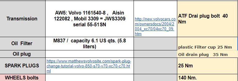

Sharing the long OEM torque list :wink:
Highlights:
Detailed:
