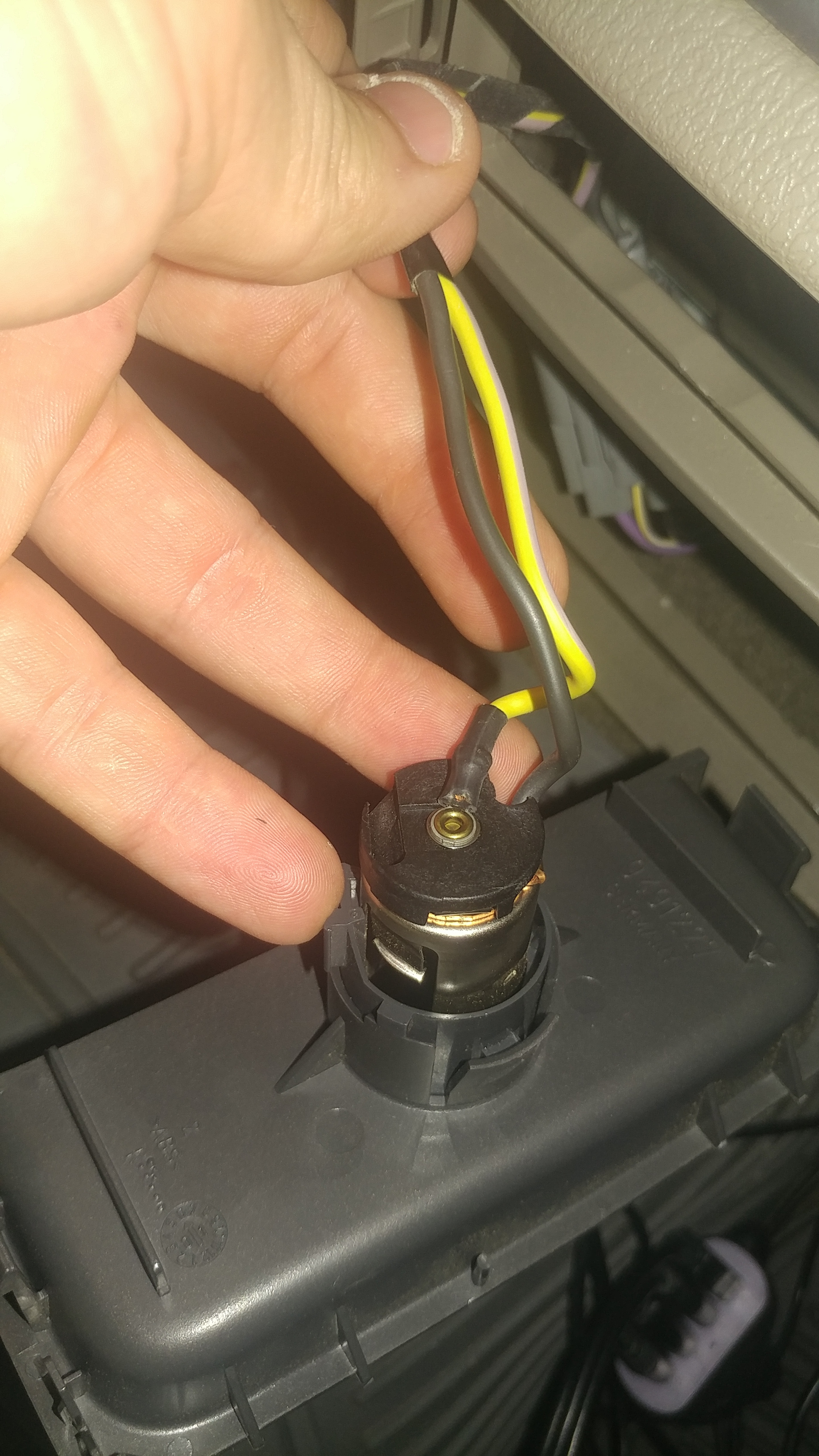

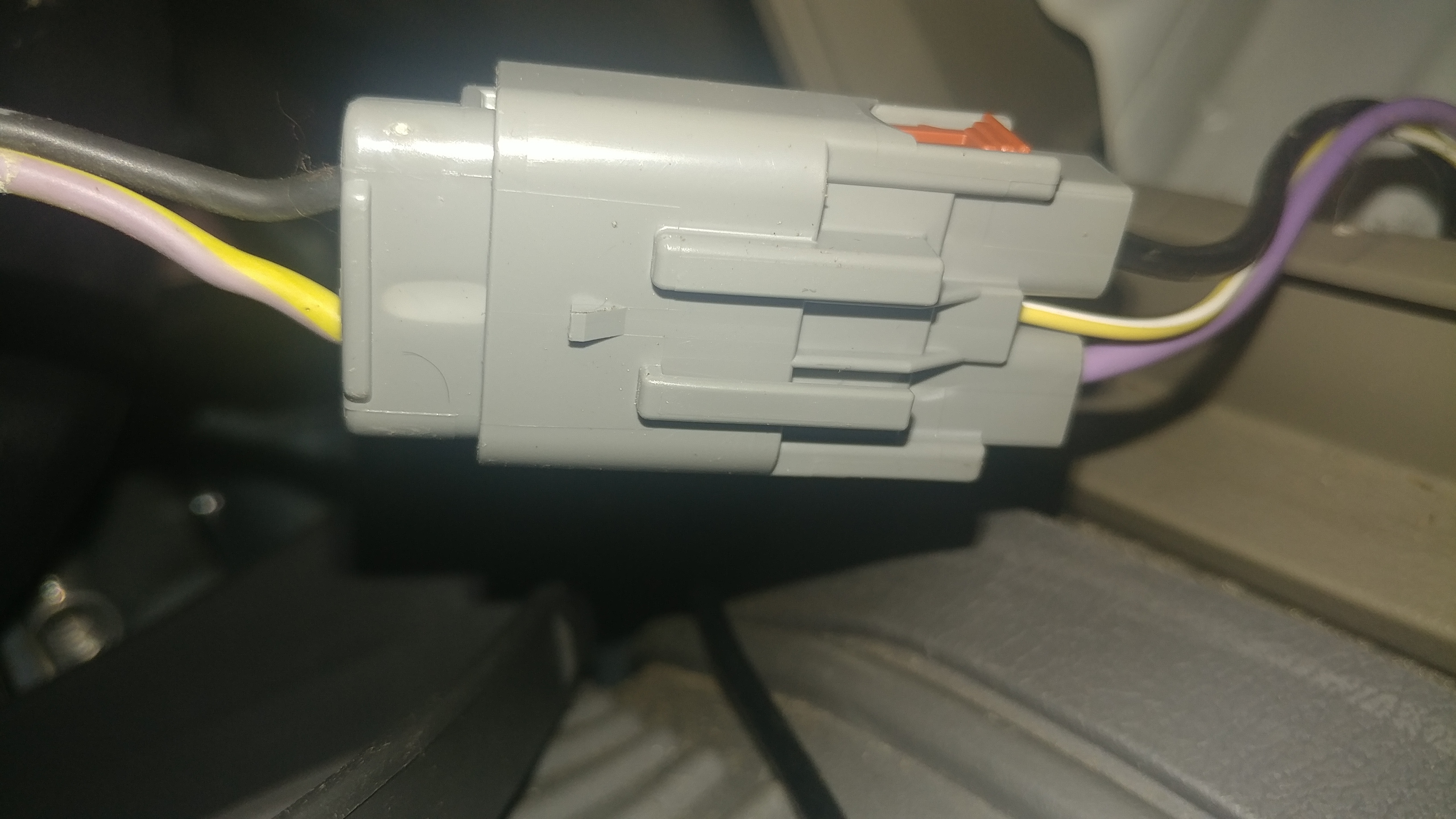

On my 01 v70, the 12v socket wiring is inconsistent in terms of wiring colors and more. First of all the one in center console (front and 2nd row) are both wired to the dashboard fusebox. The front has purple and black wires. The 2nd row has a purple and black, but also a yellow wire (pictured) that joins the purple one. I do understand the power/gr colors. But would the yellow one be for the ignition to turn on to power that outlet? Please let me know because if so, want to cut it so it will stay on.

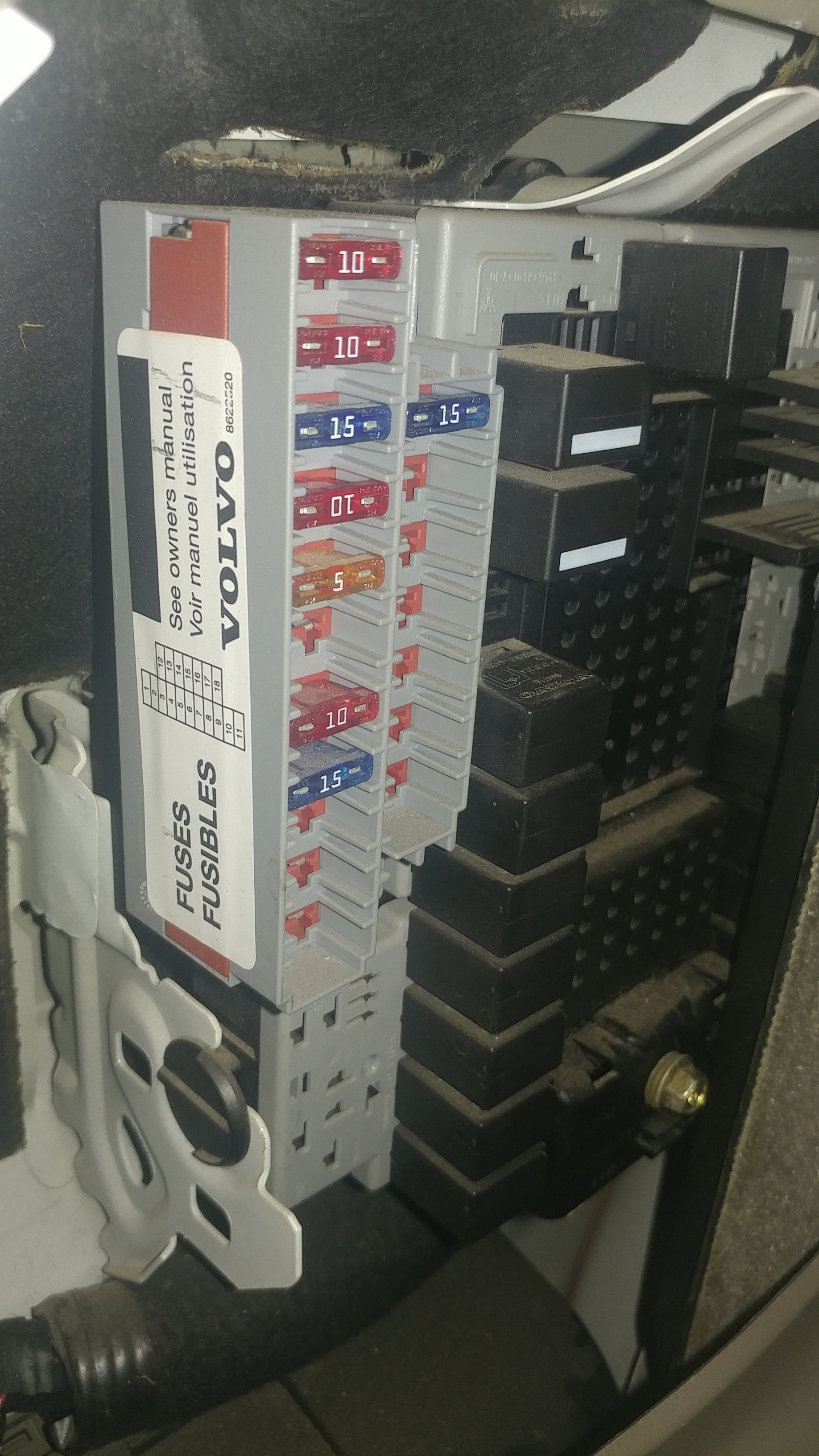

Does it have a 15A fuse in slot #7 on yoyr cargo fusebox?93SCMax wrote: 18 Aug 2019, 08:21I have the optional 12V cargo outlet. It's always on regardless of key ignition. The front seat and 2nd row 12V outlets are only functional with ignition key on.CIK7 wrote: 17 Aug 2019, 20:16 It is said on a Volvo forum (from 2004) on another site that when the cargo 12v option is installed, its always on regardless of ignition key position. Anyone know if that is true?
