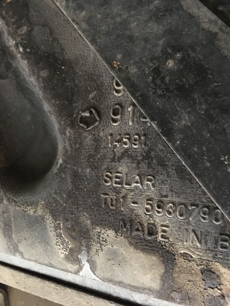

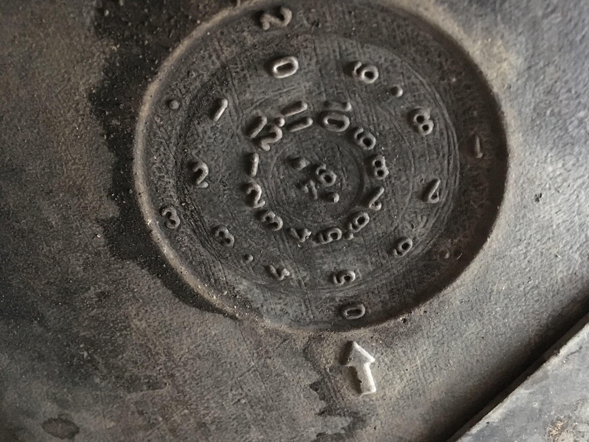

Does anyone know what specific type of plastic the 850 fuel tank is made of? Is it an HDPE? I may be able to find some symbols on the tank if I pull it.
It takes a very specific kind of epoxy to work with plastics. And if you use a plastic welding rod type of system, it needs to be the exact material or it won't bond. I'm going to repair the crack at the heat shield.

I think you're right - HDPE from most of what I've read. Volvo parts man couldn't help.
No hurry, I'll figure out draining my 5 gallons, and drop it in the next week. There are usually some material marks molded in to most products. Funny that HDPE is #2 milk bottles. But I want to find the correct welding rod.
