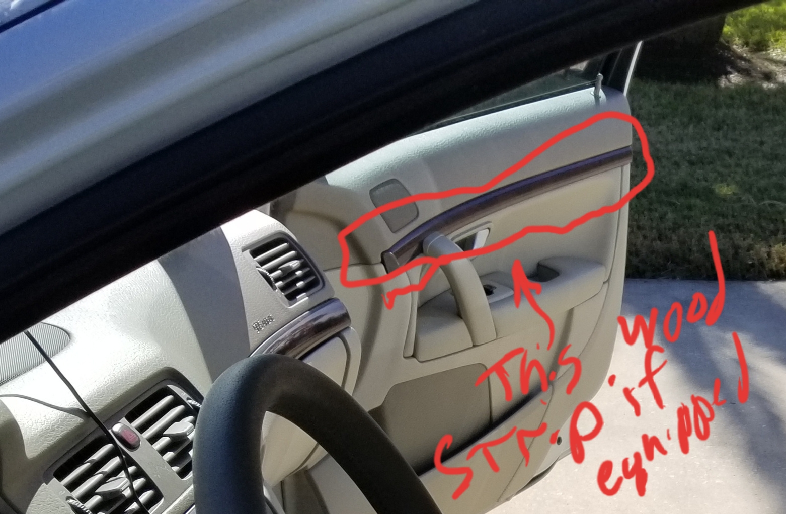

Go to your Volvo dealership parts department and order a replacement speaker. Though it technically could be a bad connection, you don't want to pull the door panel twice. Once is bad enough risk as Volvo plastic does not age well. When you do pull it, be super extra careful not to stress the door panel plastic bits. If the passenger side is fine, I'd leave it alone. June
Added;
Oh, DON'T hit the door panel too much or you will break a plastic bit which will get you annoying squeaks and possibly rattles. Especially if your door panel has a plastic woodgrain strip. You will hate life if one of the plastic mounts breaks. I accidentally broke one mounting clip on my S80 and almost went crazy from the squeaks and rattles
Added;
