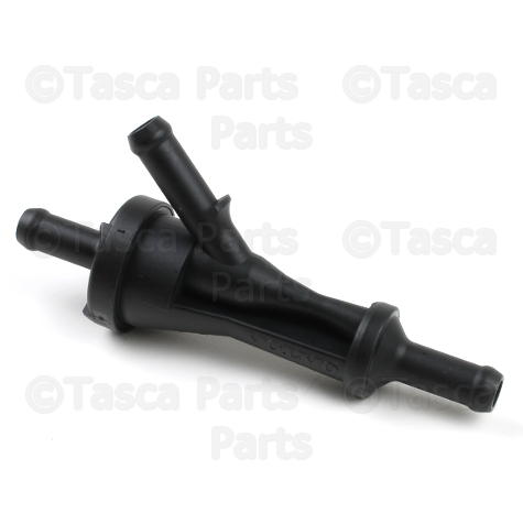

It's this part: https://www.tascaparts.com/oem-parts/vo ... gIri_D_BwE
The tank is a saddle design to allow clearance for the exhaust. Fuel pump is on the passenger side. When fuel gets low you would have essentially two different tanks with a few gallons in each. To get the isolated fuel on the driver side, the fuel pump drives fuel over to a venturi on the driver side that sucks up driver-side fuel and ejects it over to passenger side to be available for the fuel pump.
This type of setup in fluid transfer is called an ejector pump. Common in sump systems (which this V fuel pump system is). Not sure what else to call it here. With Volvos I've only ever seen it referred to as ejector pump (or 'that second pump,' or 'what?').
Thing is, there's nothing to break on the part. Hose from the pump to this injection molded, non-moving, non-wear passive part, and hose back. The only reason I can think it's not working is there isn't sufficient pressure getting to it to draw fuel - i.e. either hose not hooked up, plugged or torn, or fuel pump otherwise not driving fuel to the device.

That's a booster vacuum ejector. It's not a pump. I had to replace one recently, it runs off vacuum & is in the same circuit as your brake booster. If this part cracks or fails, you loose boosting to your brakes = HARD pedal & no assist.
But your symptom of fuel relation & not being able to pump fuel from one side of the tank to the other I believe is unrelated to this part.

That's a booster vacuum ejector. It's not a pump. I had to replace one recently, it runs off vacuum PSI & is in the same circuit as your brake booster. If this part cracks or fails, you loose boosting to your brakes = HARD pedal & no assist.
Hmm. I wonder what the part is for the fuel ejector then.

They have messed up the hoses in the fuel tank somehow. It’s a subtle job and easy to mess up if they haven’t studied it carefully.
It has nothing to do with the part shown, it’s part of the new fuel pump that’s has to be pulled over with messenger line as noted above
