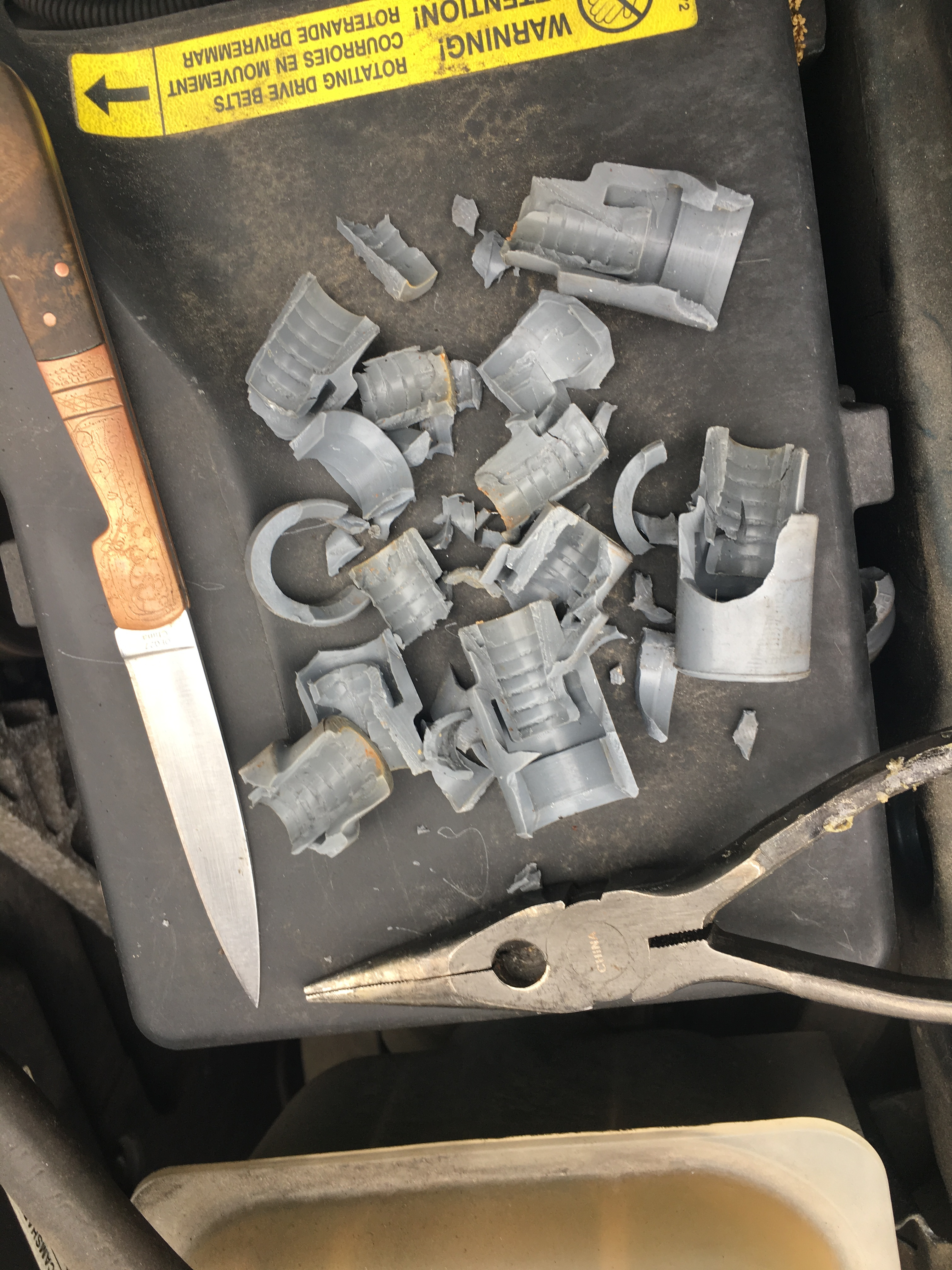

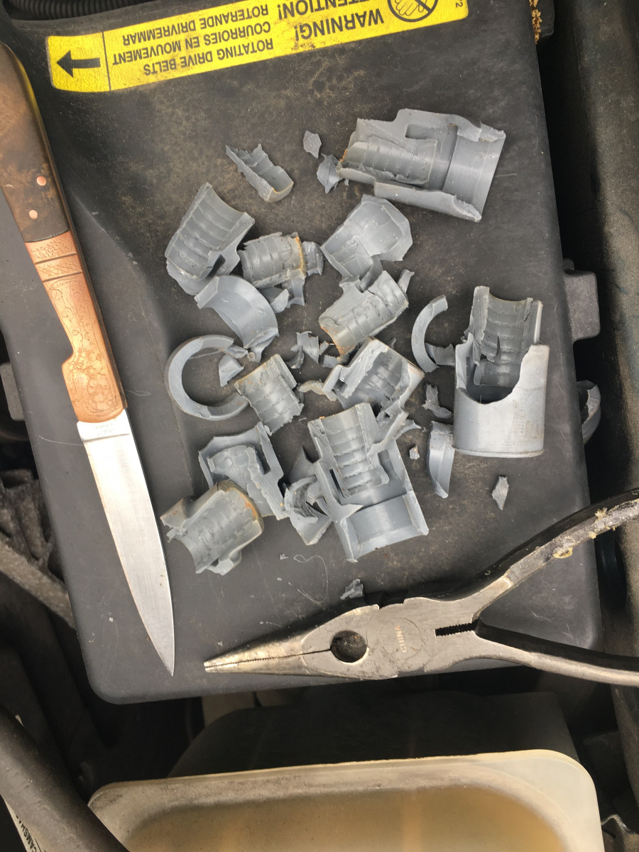

First of all, Wires For Life - what a joke. When I pulled the wires, all the little rubber boots were fused to the ceramic on the plug bodies. Luckily I had a long narrow sharp knife and needle nose pliers to carefully shave the rubber off the ceramic and work them out. Waste of a half hour.

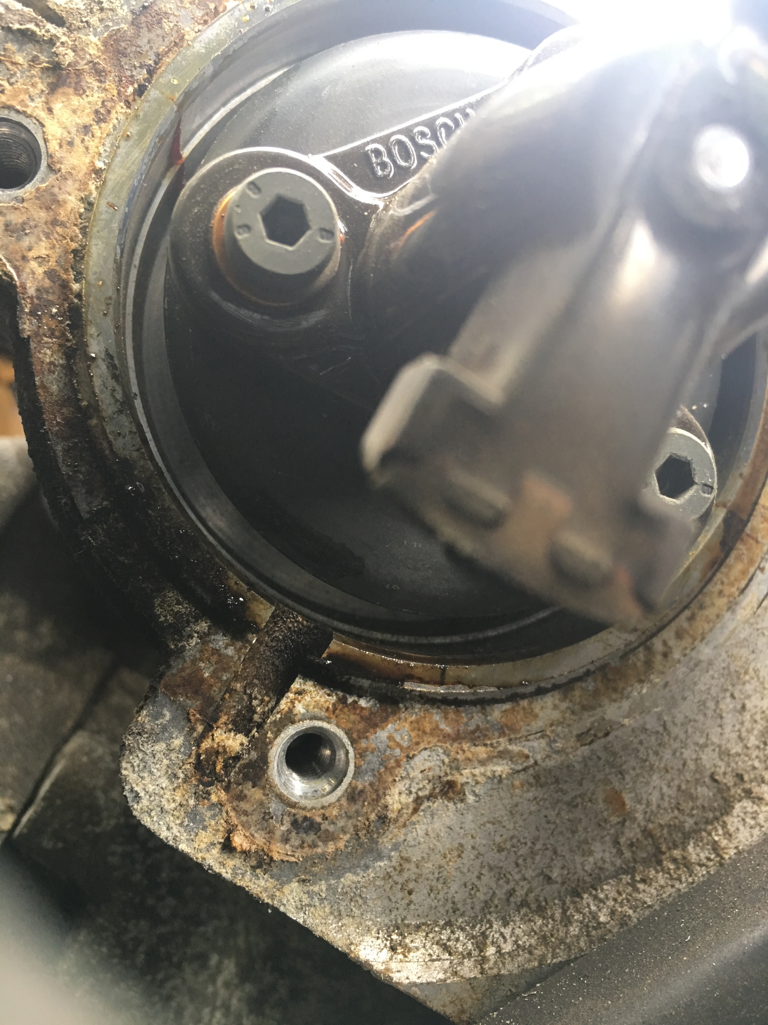

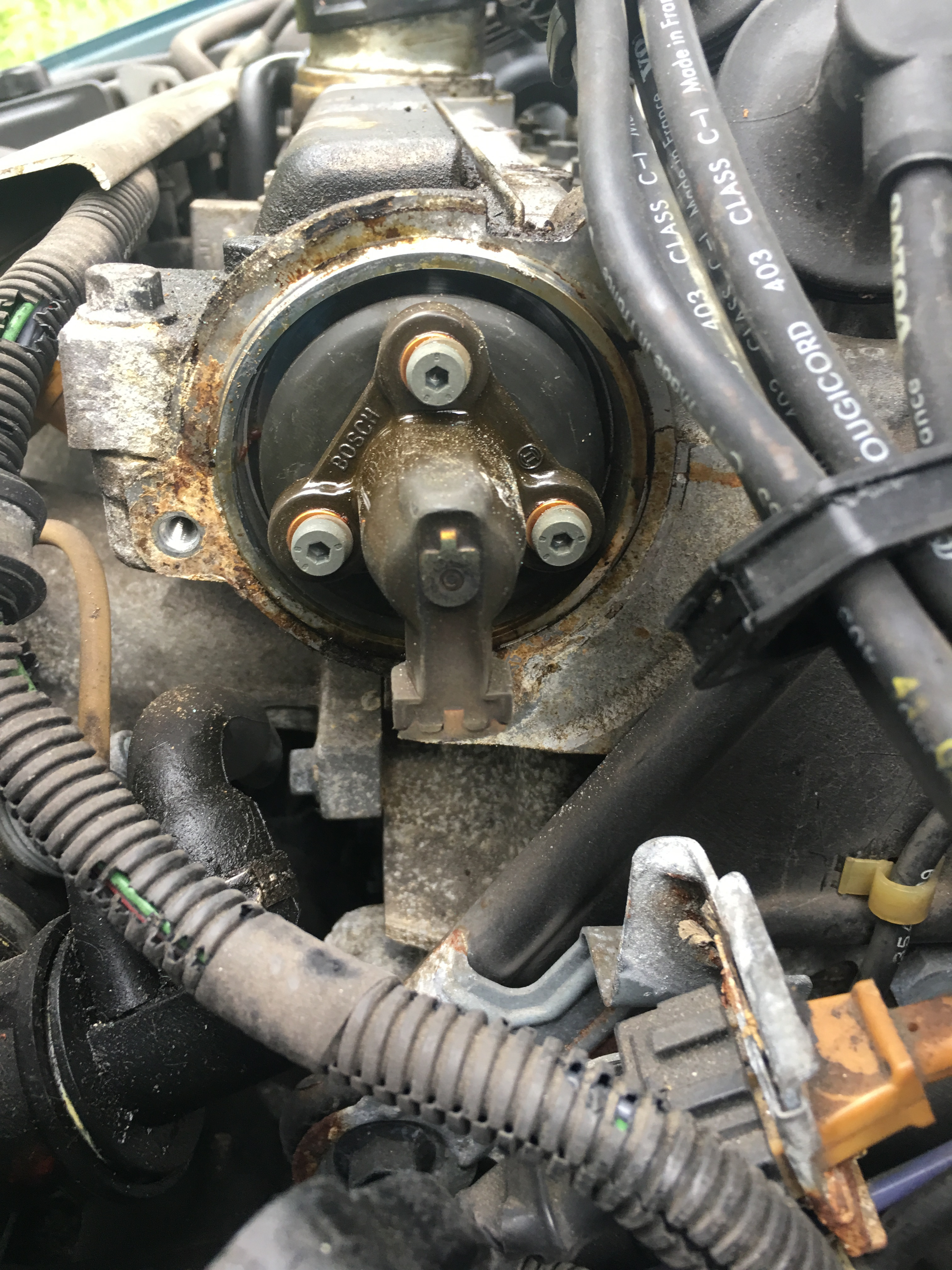

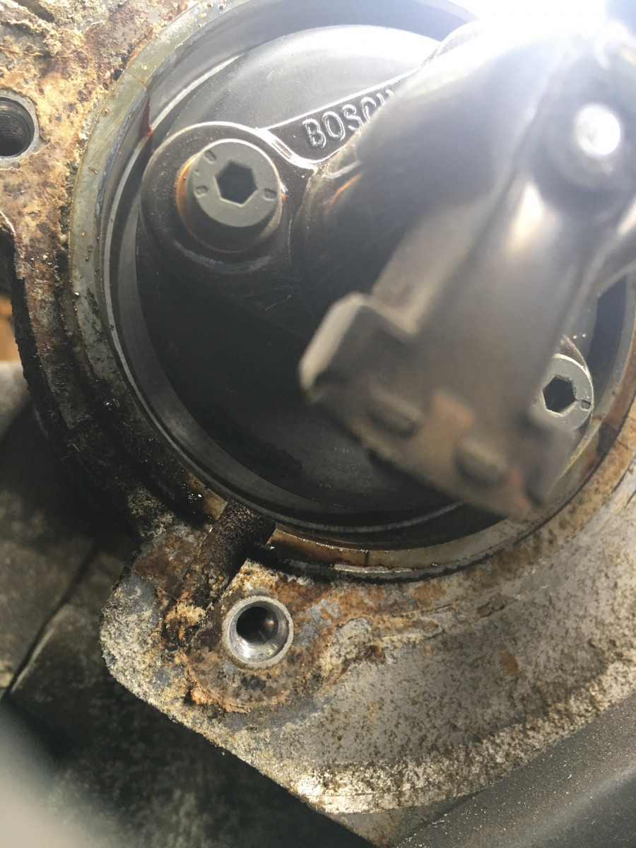

Pulled the Bosch cap and it was very dirty inside, lots of corrosion on contact points. Not oily or wet though. There was some oil around the edges of the cap cover, but I think it’s from the oil cap and running down the trough. The cam seat could be seeping a bit but if so, it’s not intense. I also noted the little drain hole below the distributor...pretty clever, but no evidence of wetness in there.
Replaced the 96’s Bosch cap with the identical Bosch cap from the 98, which looked cleaner, but not perfect. Put the Bougicord wires on and tried to start car. Start but no turn over. Couldn’t determine if wires were on right but felt sure they were. Pulled air box and battery, removed wire cover and pulled the cap. When I removed the tube from the MAF, it was filled with smoky, fuel air mix - indicating no spark to me. I was having some starting issues with the 98 the last two weeks it was running so I figured I’d mix the 96 cap with the Bougicord wires, confirm proper routing and tried again. Since I had it this far down again, I figured I’d replace the Cam Position Sensor with the one I pulled from the 98 as the wires between the sensor and the plug on the 96 were starting to crumble.
Got it all put back together and it started up. Drove until warm and it still stumbling and hesitating on acceleration but it idles ok and no CEL.
I’m thinking new cap, plugs and rotor are probably warranted at this point. The Bougicord are stamped 4/09, so they are 10 years old. The distributor is glazed and dingy and the cap is pretty dirty even though I did carefully scrape the interior contacts with a sharp knife. What is considered serviceable life for cap, rotor and wire on these cars?
