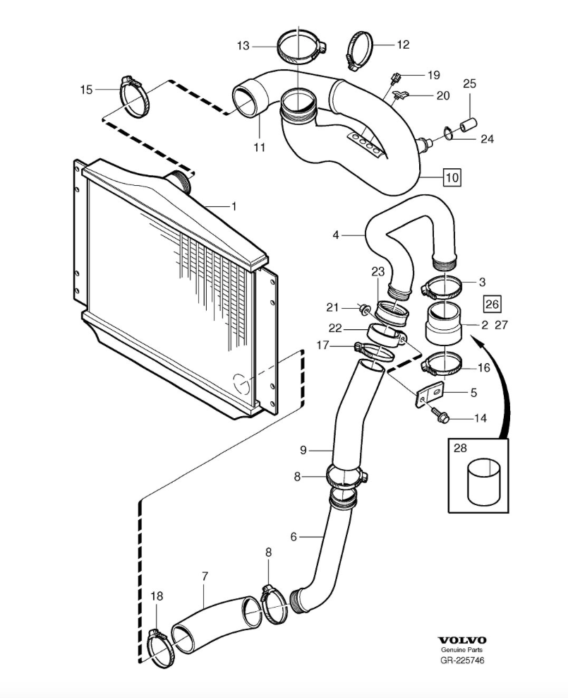

- 16 Lower Turbo Sleeve - 988014
3 Upper Turbo Sleeve 988014
17 Hard Pipe to Soft 988014
8 Soft Pipe to Hard 988014
8 Hard Pipe to Soft 988014
18 Second Pipe 988104
18 Intercooler to soft Pipe 988014
15 Soft Pipe to Throttle Body 987409
13 Throttle Body Clamp 985760
12 soft to hard. 988014
1999 V70 T5M56 Complete Tabulation of Turbo induction clamps and part numbers Topic is solved

Sizes to come
- T5 Turbo diagram
- Screen Shot 2019-09-02 at 12.16.10 PM.png (264.15 KiB) Viewed 1400 times

I left off #12 above, it’s a 988014
The diagram of the soft pipe connecting the ETM hard pipe to the top of the intercooleris completely screwy. The ETM is well to the right of the intercooler connect, not left as shown.

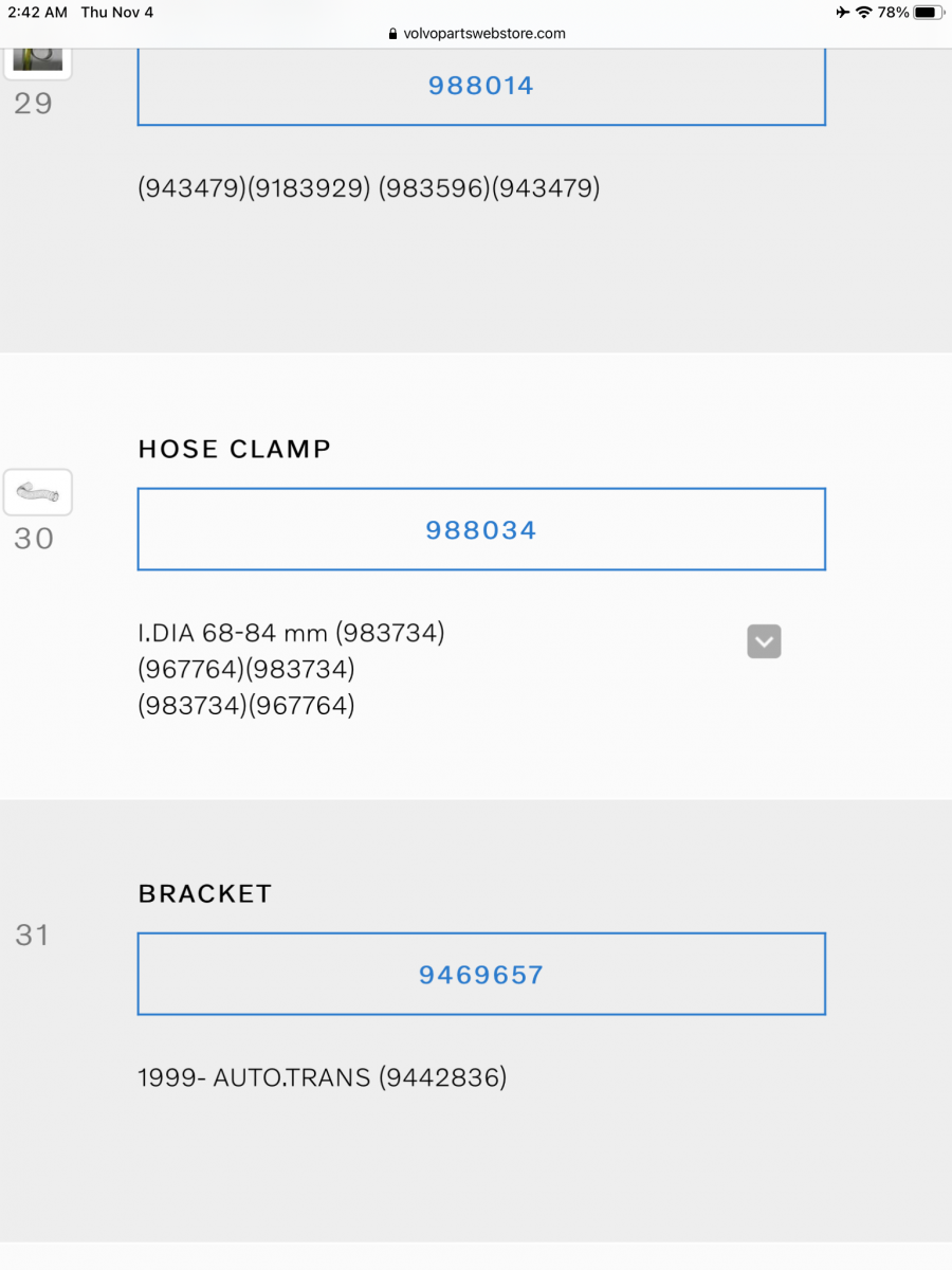

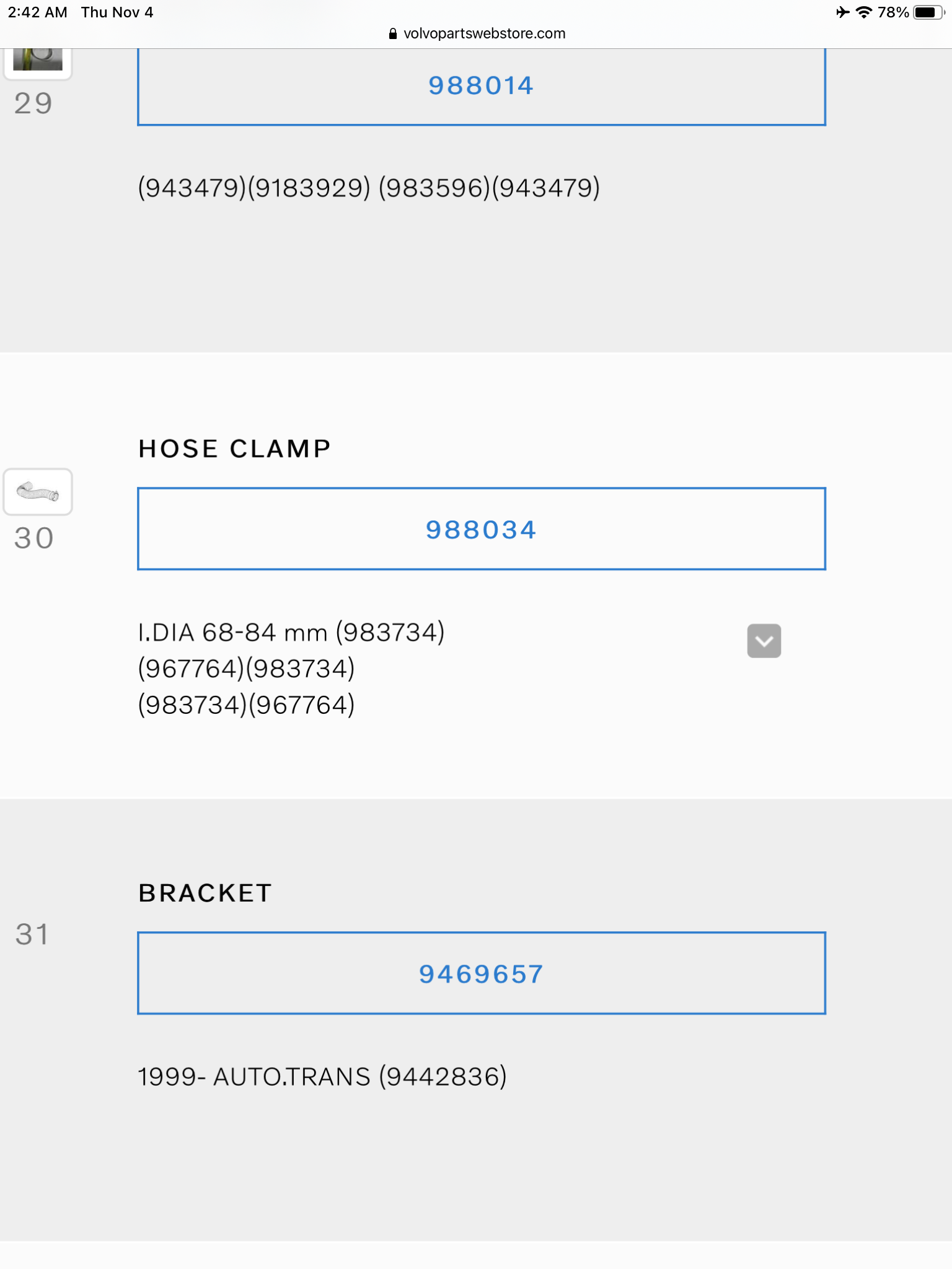

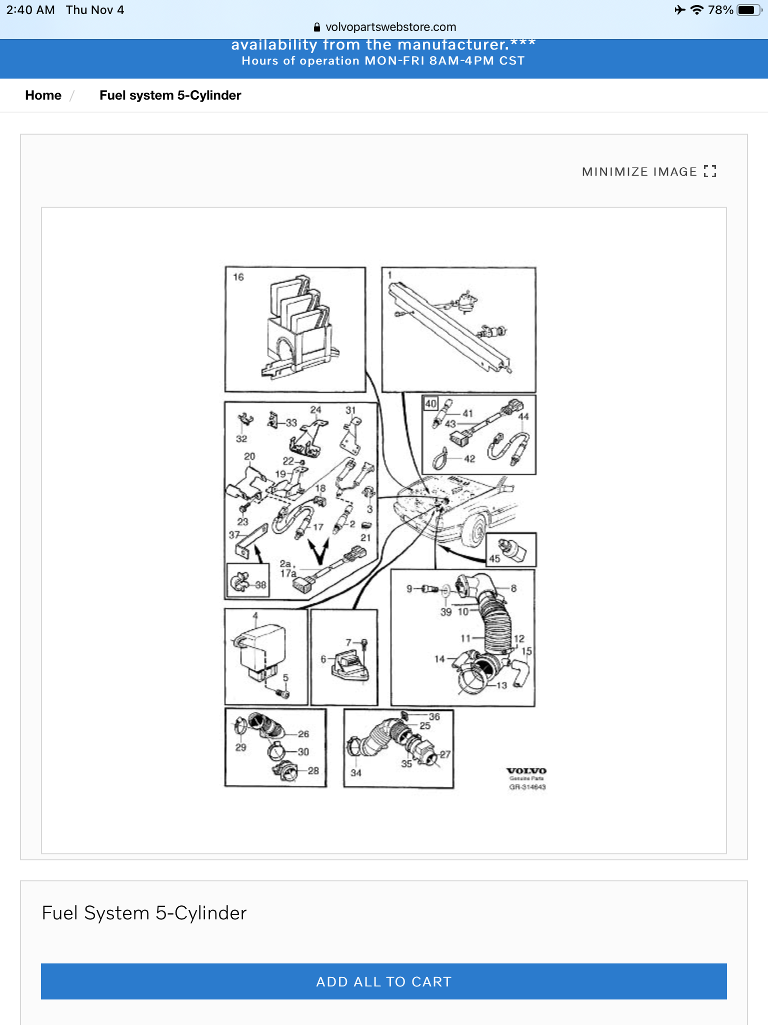

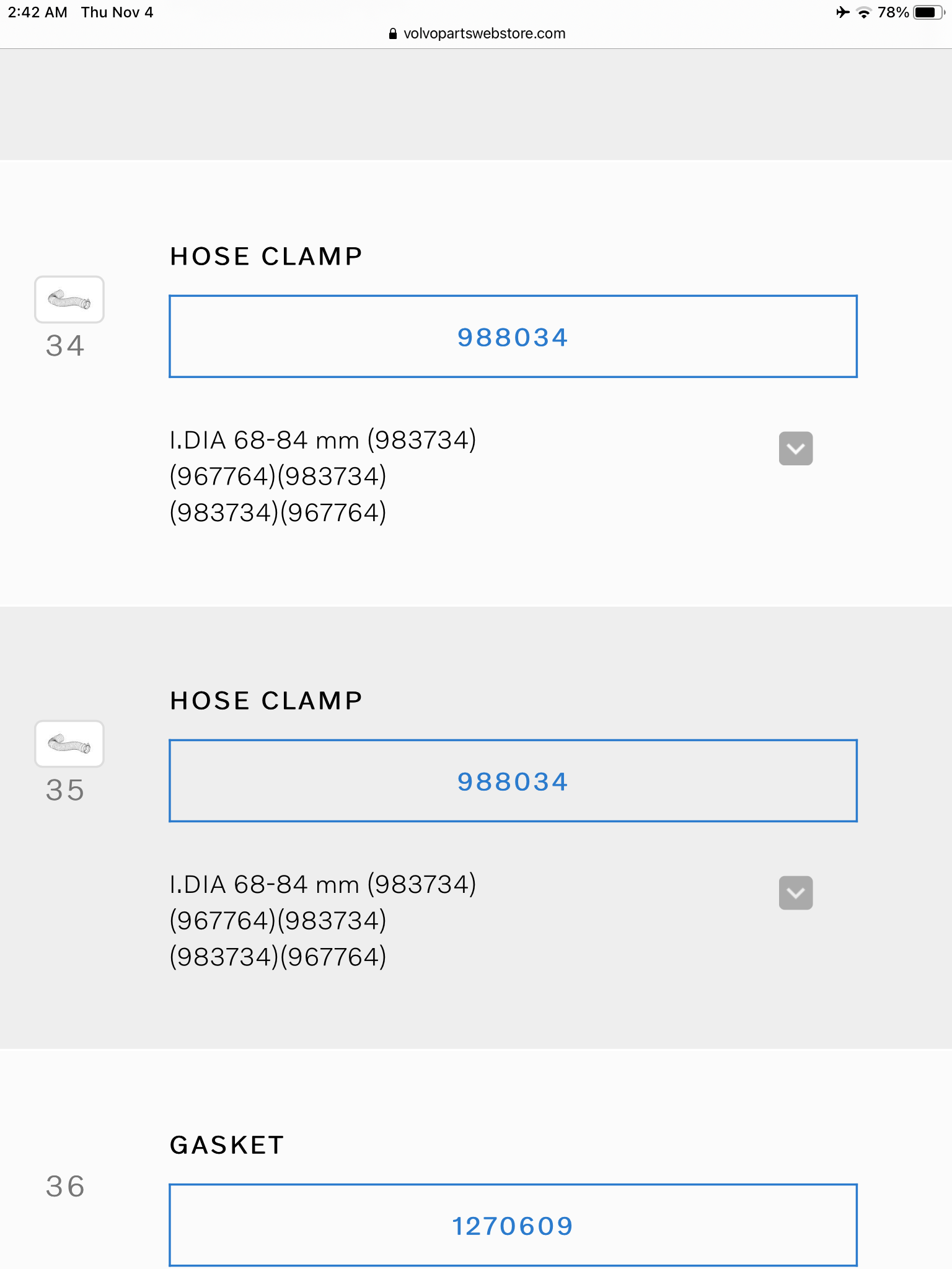

Can anyone find the part numbers for the last two air induction clamps?
Snorkel to turbo ( I used a 988014)
Snorkel to MAF
IVE searched unsuccessfully on Volvo webstore
Snorkel is 9445351. $125 as of 2021-11
Found it! Of course the snorkel is in inFuel System , why not?
988034
Snorkel to MAF
988034
